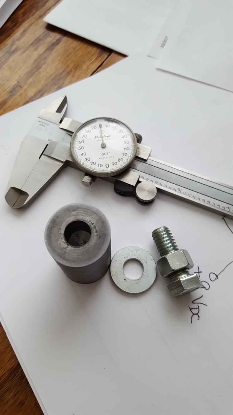

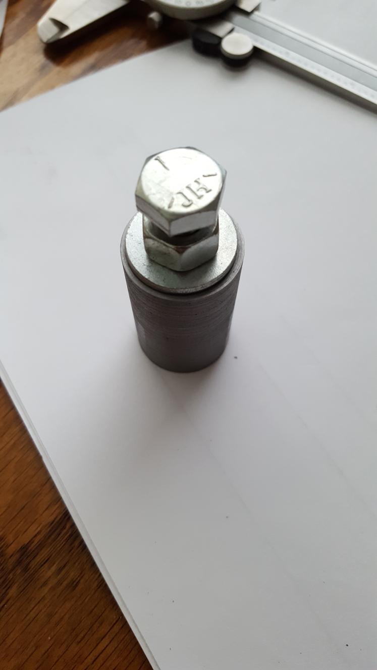

    I needed to support one end of an aluminum flat bar for drilling. Casting about the shop, I was able to quickly piece together a crude jack to fit the need. Nothing fancy, as the round stock was an off-cut from another tool I had made on the lathe. With the addition of a 5/16-18 bolt, nut and washer, and viola!
    Simple machinist's jack-20170430_172416_small.jpg Simple machinist's jack-20170430_172454_small.jpg
    Because it was all stuff I had laying around, cost was zero (my favorite kind). And since it's all more or less scrap, I can modify it to my hearts content...
    -EN

    If you take your bolt over to the belt sander and sand the top smooth (grade marks and the "JH"), and the bolt will spin easier under a load as you level your work piece.

    Great tip. Thanks!
