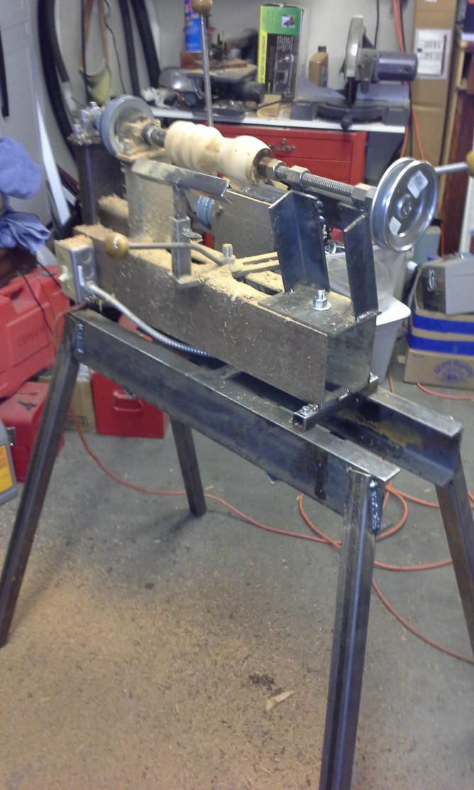

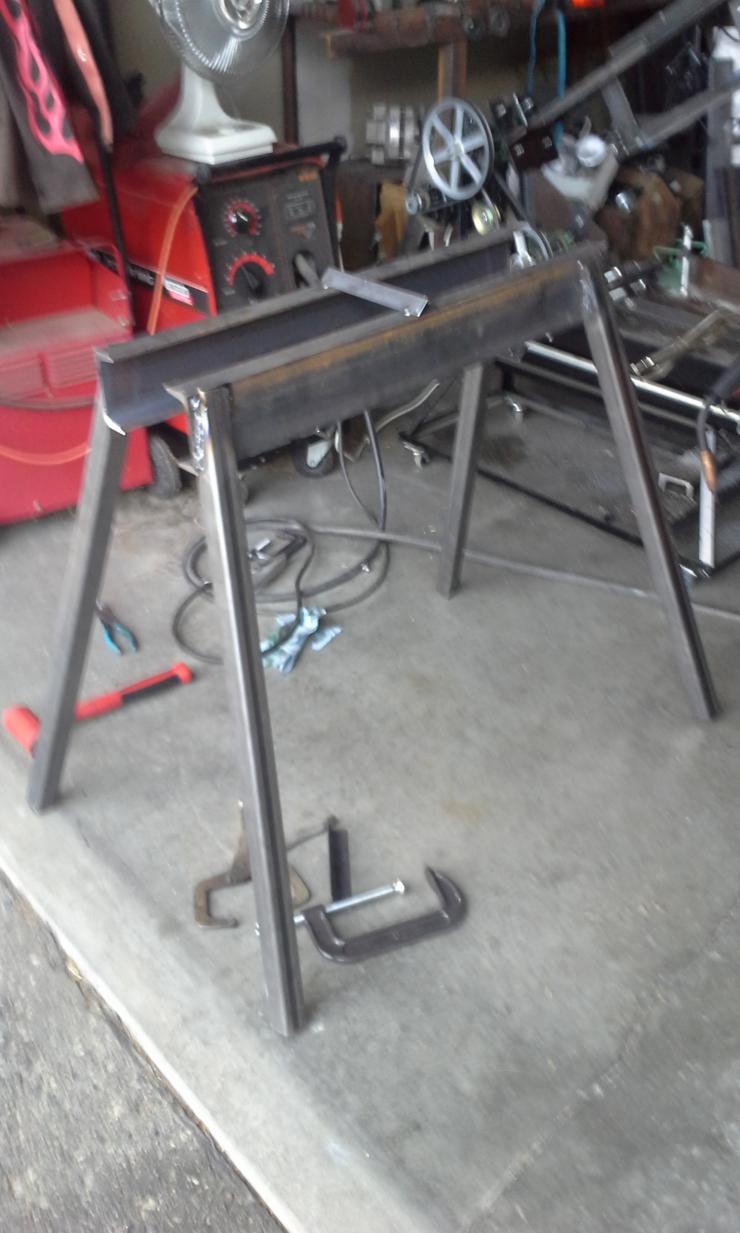

A stand for my 'simple' wood lathe, built from sections of 4" channel and 1 1/2" square tubing. The legs are cut for approximately a 10 degree angle at the top, and then welded to the channel sections to form legs. It took about half a day to build, and works great with my little homemade wood lathe! :D
