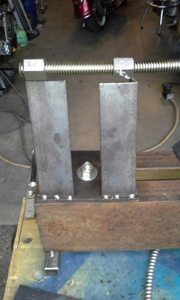

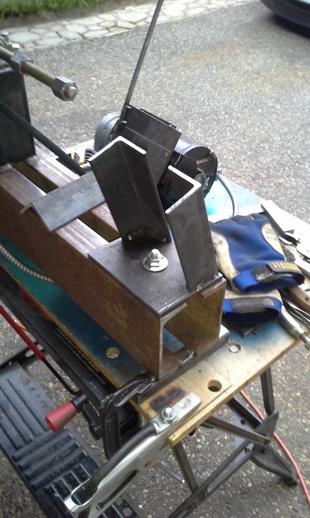

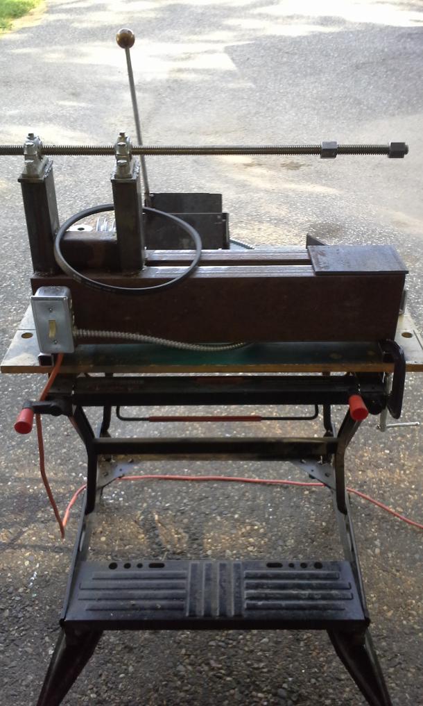

Here's my latest in a short string of power tools...I just finished it today. I've always wanted a small wood lathe, but just never seemed to get a handle on either the dollars, or a design I was happy with. I recently visited a friend of mine that lives in Spokane, WA., who showed me one that was 'home made'. It was built on two sections of channel steel...this was all the inspiration I needed! I don't have a large amount of space in my shop, and am not likely to attempt turning long posts for a bed. So the entire unit is only 24 inches from one end to the other.

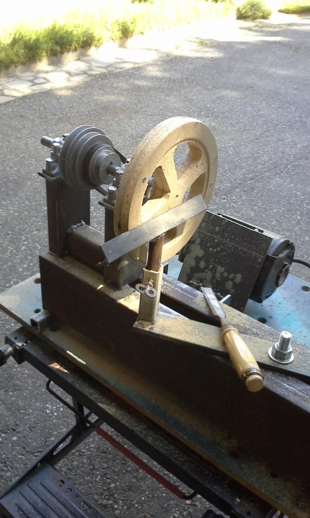

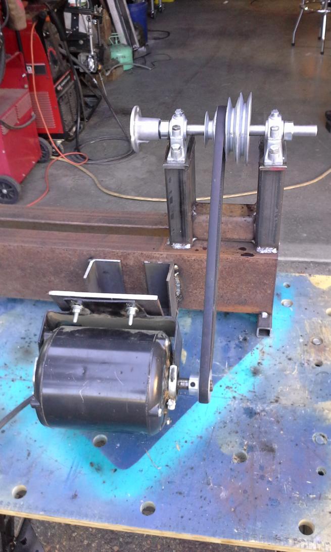

The included photos should be pretty self explanatory: the bed is two sections of 2" x 5" channel, positioned to form a 'box' or square tube; with a 1" gap between them. The uprights that support the pillow-block bearings, are 1 1/2" x 3" x 3/16" rectangular tube. There is a short section of 2" x 2" x 3/16" square tube, that is about 3"-4" long. As with most of my projects, everything you see in the pictures, are items I had 'laying around'. The motor is an old craftsman, salvaged from an even older Montgomery Wards scroll saw, that I sold years ago. The tool rest is just a scrap piece of 1" x 1" x 1/8" angle steel, that has been welded to a 1/2" dia steel rod. The 'thumb screw' that holds sets the height of the tool rest is just a 1/4 x 20 x 1/2" long hex bolt. I then tack welded a pair of flat washers, onto the head of the 1/4 x 20 bolt to form 'ears'.

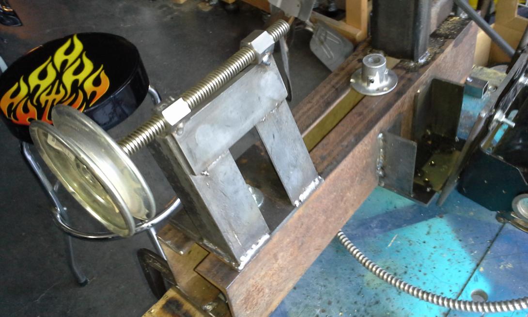

The hub that the wooden wheel is mounted to, is just a diecast hub from an old squirrel cage fan. I'll eventually get around to making a tailstock, and maybe bed extensions; but for now, it suits my needs very well. I'll also add a 'on/off' switch to the front, so I'm not constantly fiddling with the power cord... :p
