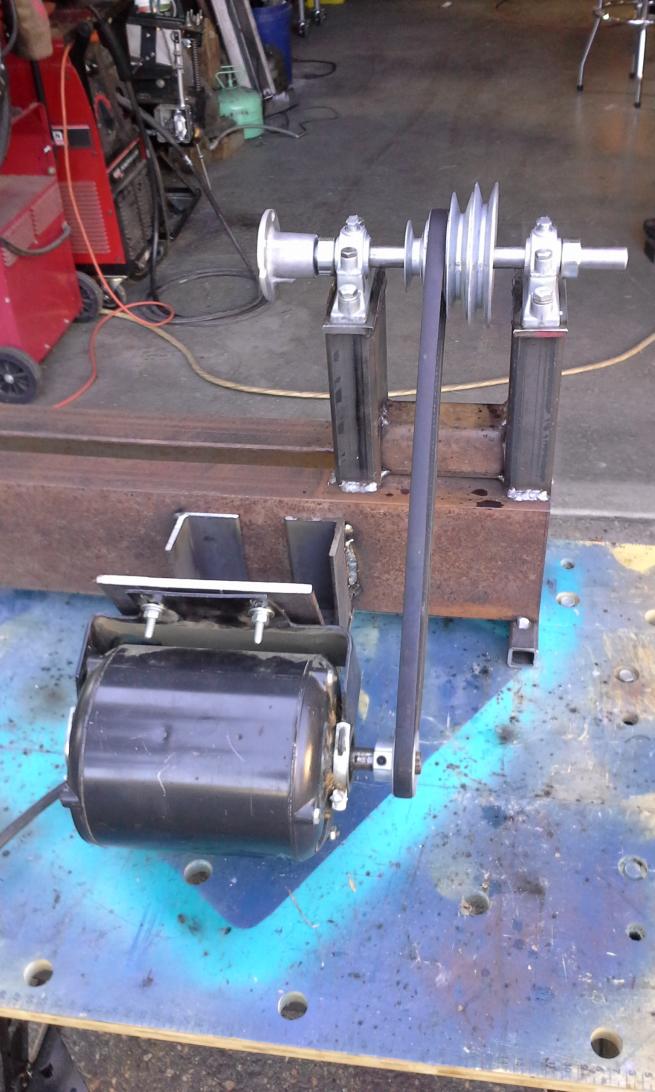

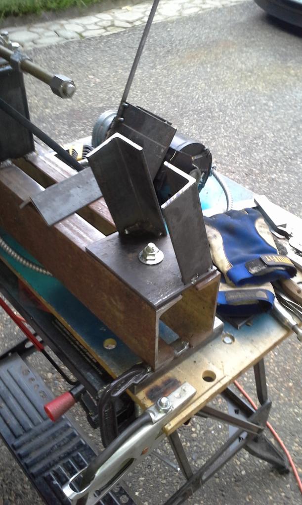

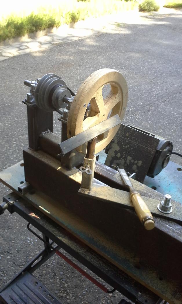

    Here's my latest in a short string of power tools...I just finished it today. I've always wanted a small wood lathe, but just never seemed to get a handle on either the dollars, or a design I was happy with. I recently visited a friend of mine that lives in Spokane, WA., who showed me one that was 'home made'. It was built on two sections of channel steel...this was all the inspiration I needed! I don't have a large amount of space in my shop, and am not likely to attempt turning long posts for a bed. So the entire unit is only 24 inches from one end to the other.
    The included photos should be pretty self explanatory: the bed is two sections of 2" x 5" channel, positioned to form a 'box' or square tube; with a 1" gap between them. The uprights that support the pillow-block bearings, are 1 1/2" x 3" x 3/16" rectangular tube. There is a short section of 2" x 2" x 3/16" square tube, that is about 3"-4" long. As with most of my projects, everything you see in the pictures, are items I had 'laying around'. The motor is an old craftsman, salvaged from an even older Montgomery Wards scroll saw, that I sold years ago. The tool rest is just a scrap piece of 1" x 1" x 1/8" angle steel, that has been welded to a 1/2" dia steel rod. The 'thumb screw' that holds sets the height of the tool rest is just a 1/4 x 20 x 1/2" long hex bolt. I then tack welded a pair of flat washers, onto the head of the 1/4 x 20 bolt to form 'ears'.
    The hub that the wooden wheel is mounted to, is just a diecast hub from an old squirrel cage fan. I'll eventually get around to making a tailstock, and maybe bed extensions; but for now, it suits my needs very well. I'll also add a 'on/off' switch to the front, so I'm not constantly fiddling with the power cord...

    One detail I overlooked mentioning, is that the spindle center is 7 1/2" above the bed. So although I have not tried it, one should be able to turn an object 15" in diameter... That's on the bed side...which means the tool rest would be perpendicular to the bed. If the piece to turn is mounted on the left side of the headstock, then it would be something larger. Just not certain what that 'something' would [safely] be... One would also certainly want to mount this lathe on something other than a workmate table, such as shown in the photos.

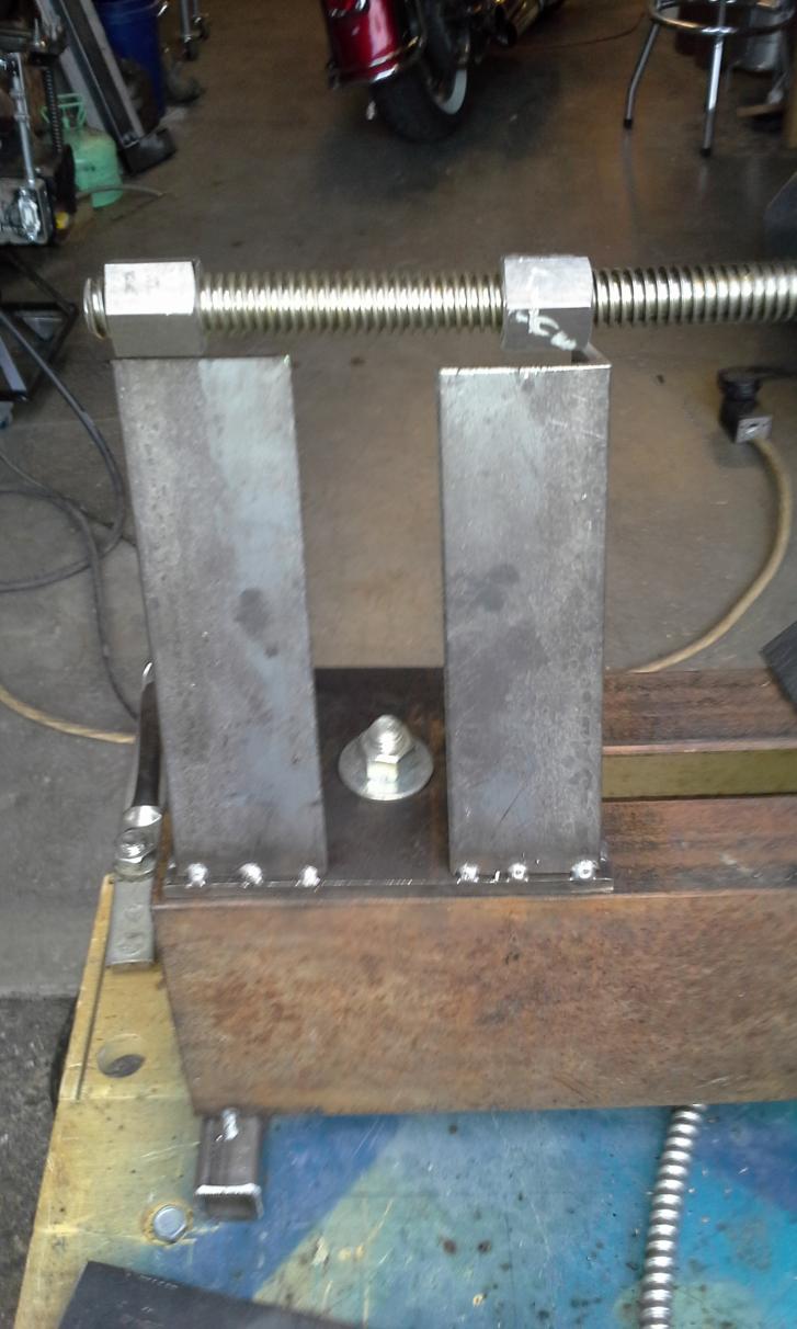

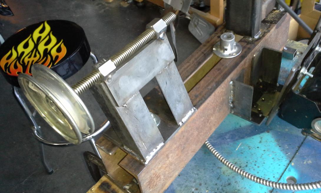

    ...some progress on the tailstock. The allthread is for alignment, and then a section of it, along with the nuts; will be used for the screw.
    Getting the angles right, is always a challenge (for me).
    ...some adjustment is always needed. Particularly when building the tailstock last... There will be a plate welded to the (foreground) side of the angle pieces, and will mate with the Acme (5/8 - 8) nuts.
    ToDo's:
    - Shim the headstock bearings, to make the spindle more parallel to the bed.
    - Adjust the height of the tailstock to match the spindle
    - Weld it all together
    - Attach a 1" guide to the underside of the tailstock base, to keep it aligned with the axis of the spindle.

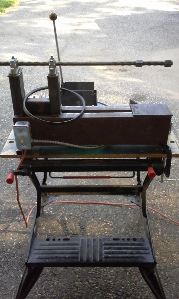

    Ok, here's the (nearly) finished item...
    I still need to work out an alignment mechanism, and then either grind a point on the end of the screw; or machine it to fit some sort of center on the end. I'd also like to be able to attach a small Jacobs chuck, but we'll see... For now, it's usable for nearly anything I'll likely do with this wood lathe.
