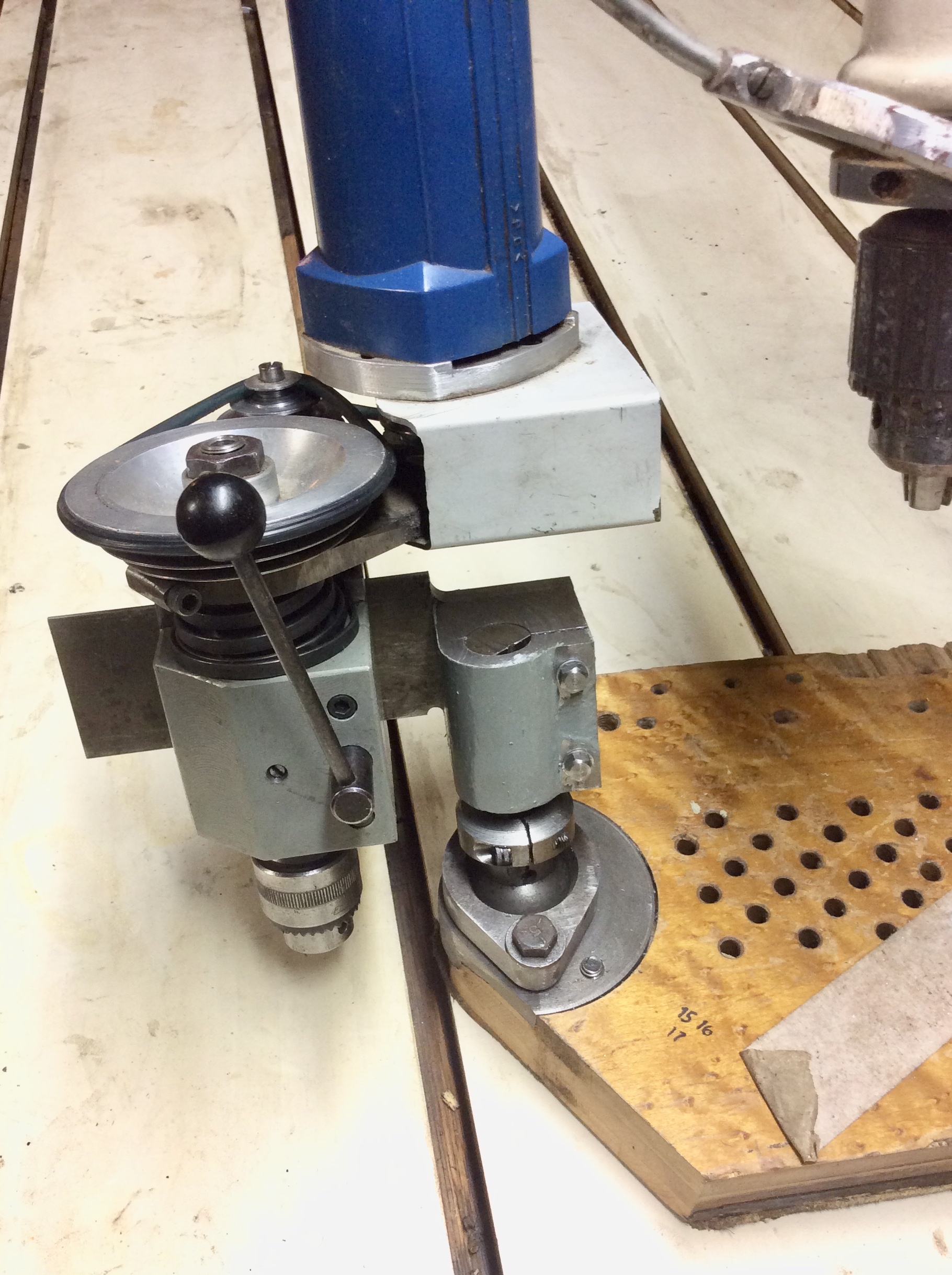

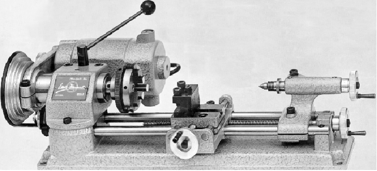

    I made a radial adapter that mounts my dovetailed Unimat headstock to a tilting column on a portable wooden base.
    The free end of the ball clamps around a cut off piece of bed rod for my watchmaker lathe, and I’ve been drilling with that but the new adapter is more adjustable and saves having to take the lathe apart.

    Next to my bigger, still small angle drill press

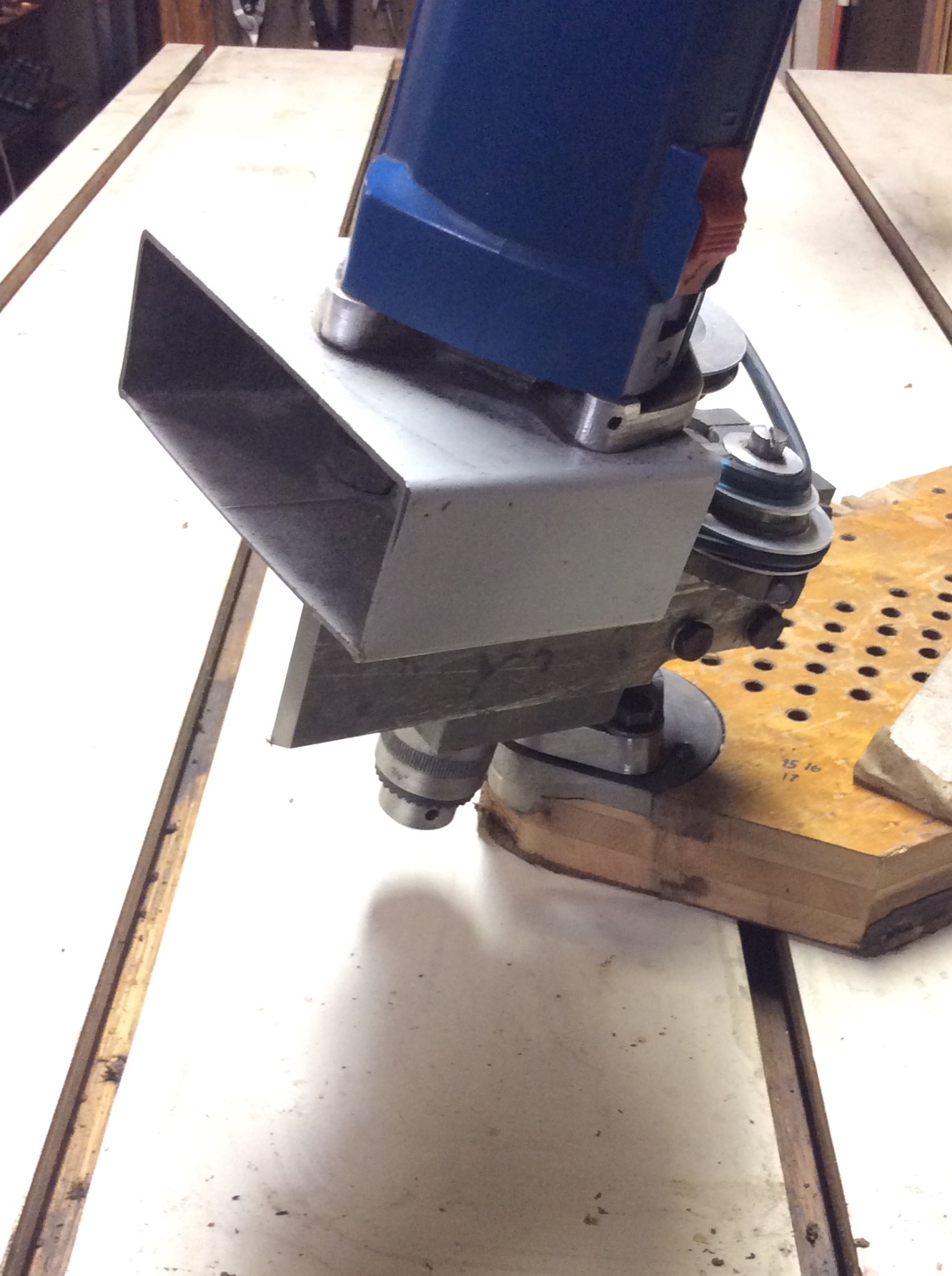

    Tilting forward and left, in the regular higher position

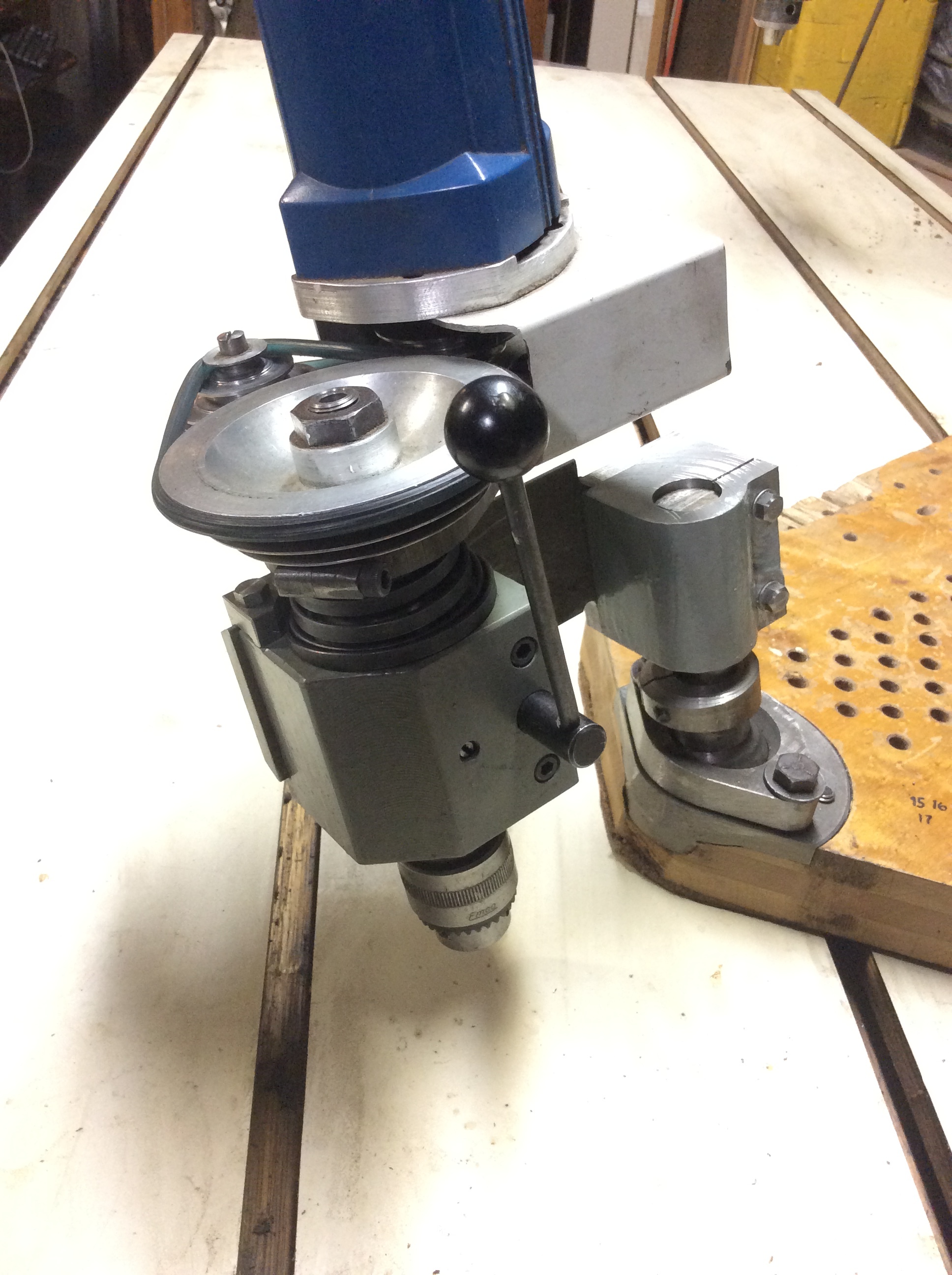

    Tilting back and right, in the upside down lower position

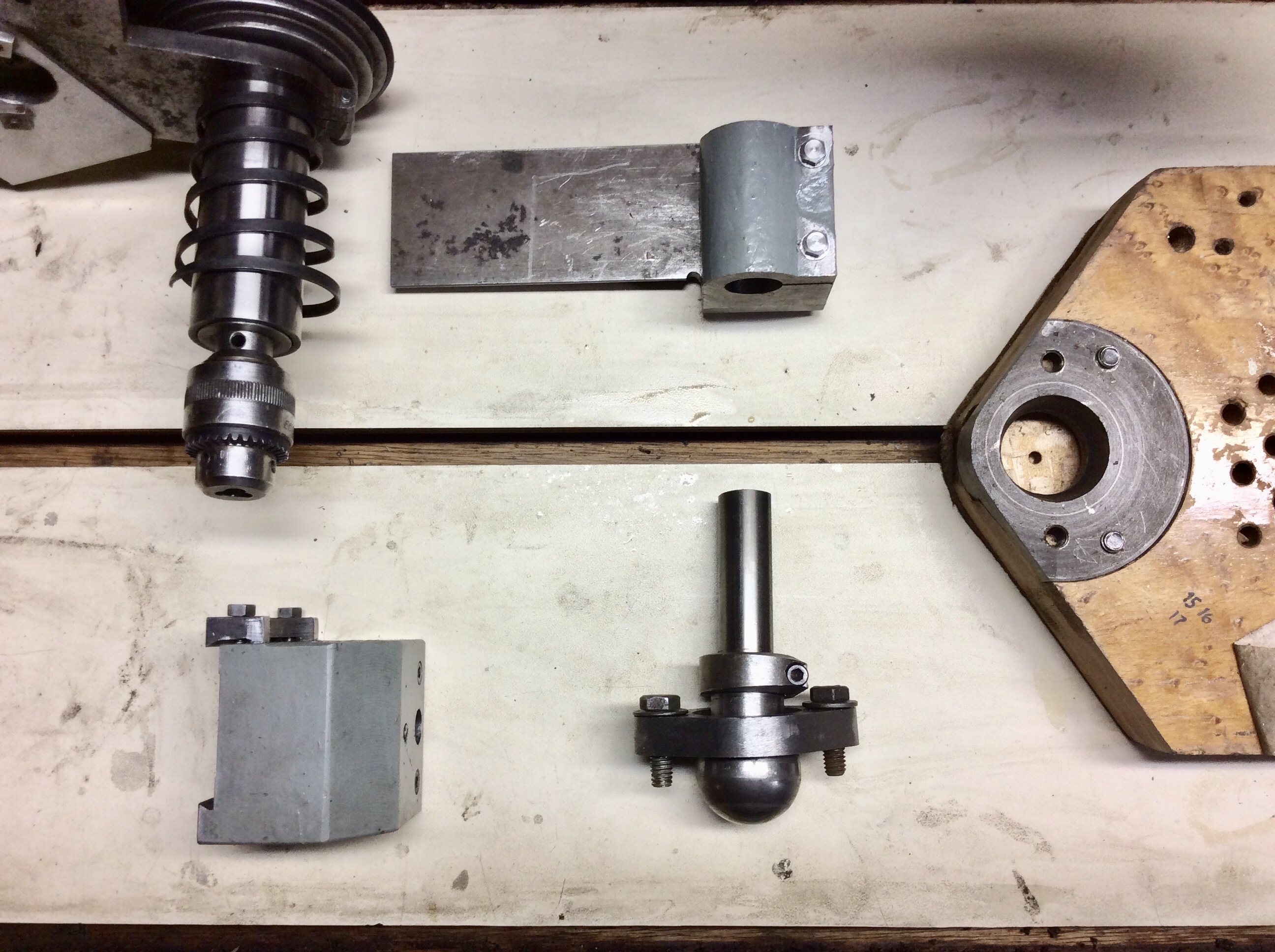

    Parts

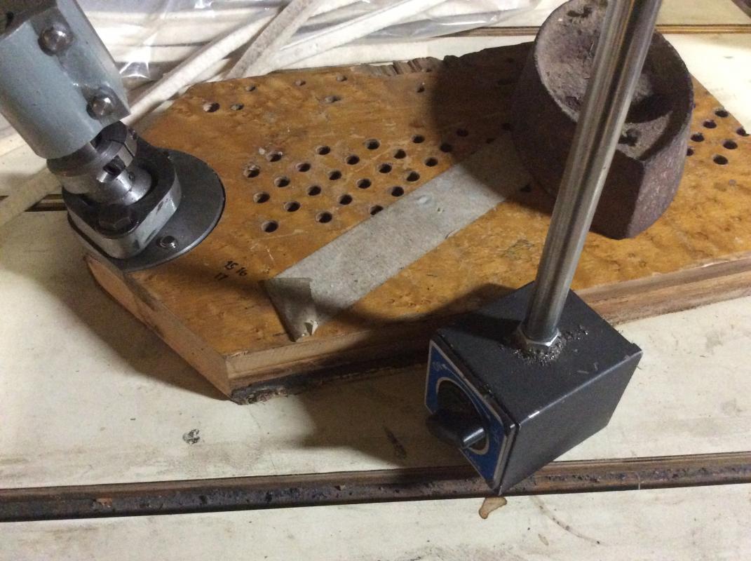

    Thanks, Dick,
    It beats drilling lots of angled holes by hand! I never tried Archimedes or bow drills, though.
    An easy improvement to it was right in front of me for days before I recognized it.

    Is that a flat iron in the picture?

    Quote Originally Posted by old_toolmaker View Post
    Yes, for ballast.
    A couple indicator bases might help to anchor the base when it’s on iron surfaces.

    That is one nice solution you have there. It leaves me with all sorts of ideas for a micro drill press. This is perhaps the greatest compliment One can offer up for a design, it gets the creative juices flowing in others. It starts with “why didn’t I think of that” and builds from there.
    I must ask, how much of a pain is it to get the angles right with that ball joint? Or for that matter get everything back to vertical square.

    Thanks, wizard69!
    I think its lack of nice adjustment is a big reason why the ball joint wasn’t an obvious solution to me, but I use this for drilling lots of small close holes in big pieces of wood where consistency is more important than specific angles, so it’s okay.
    Springy split lock washers on the clamping bolts help keep it from slipping while I adjust it.
    When I need a more normal micro drill press I just move the quill, or the whole headstock, to a different machine.
