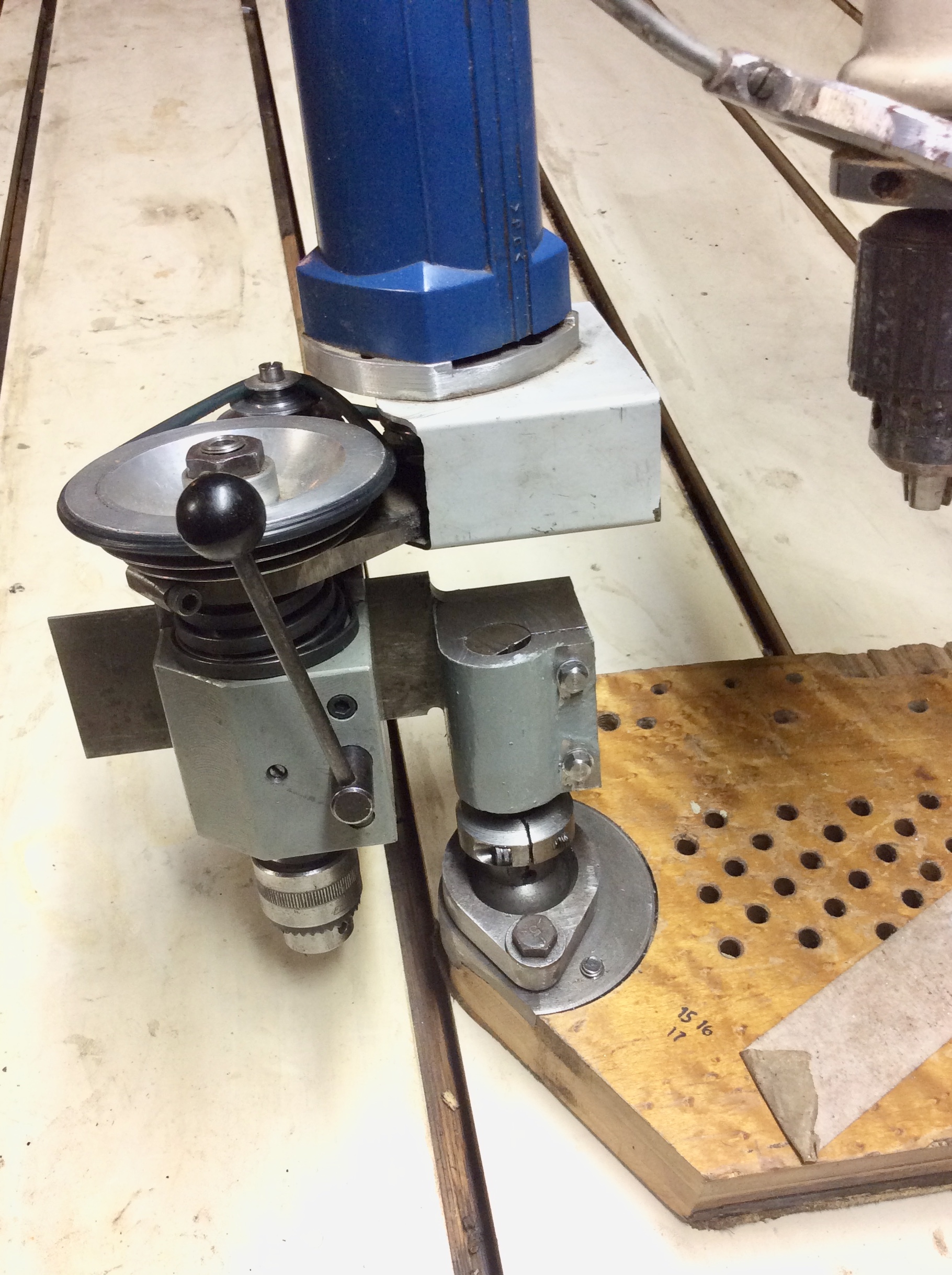

I made a radial adapter that mounts my dovetailed Unimat headstock to a tilting column on a portable wooden base.
The free end of the ball clamps around a cut off piece of bed rod for my watchmaker lathe, and I’ve been drilling with that but the new adapter is more adjustable and saves having to take the lathe apart.
Attachment 25659
Next to my bigger, still small angle drill press

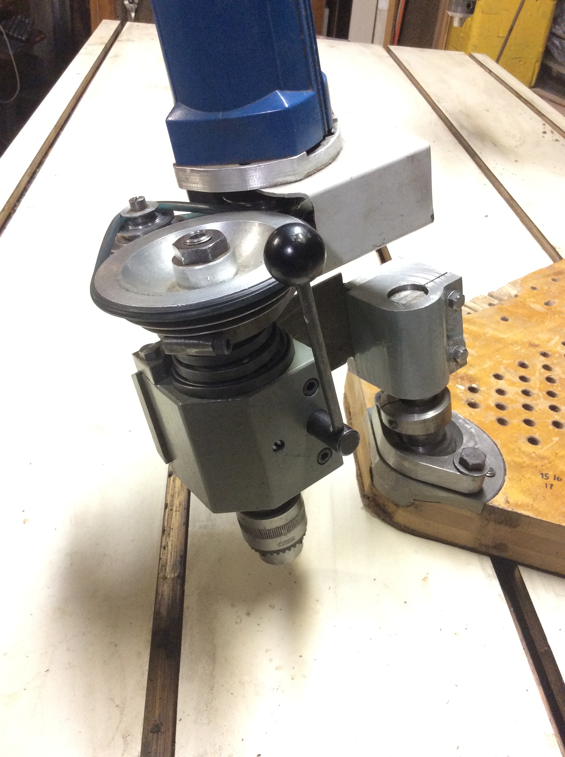

Attachment 25660
Tilting forward and left, in the regular higher position

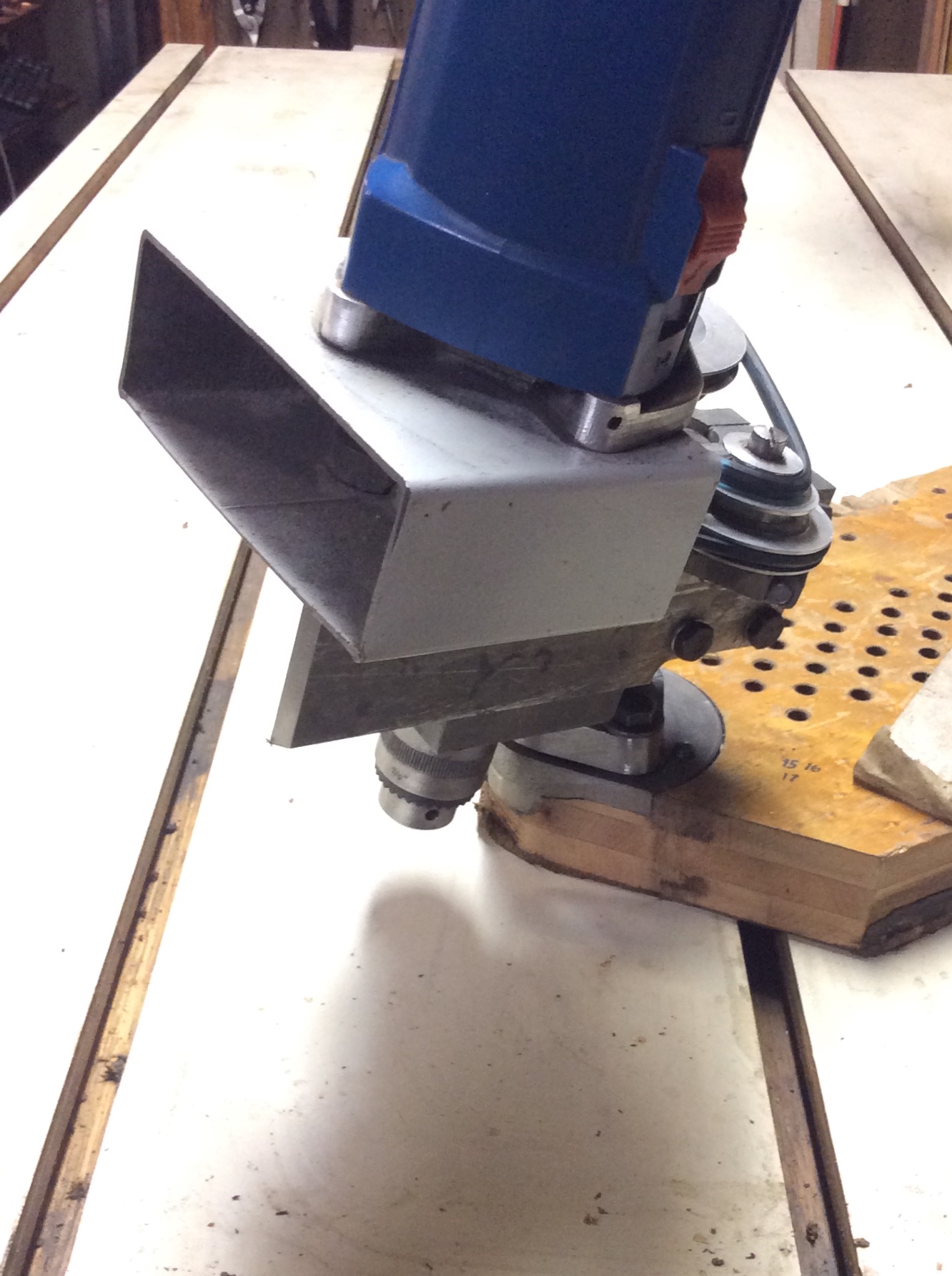

Attachment 25661
Tilting back and right, in the upside down lower position

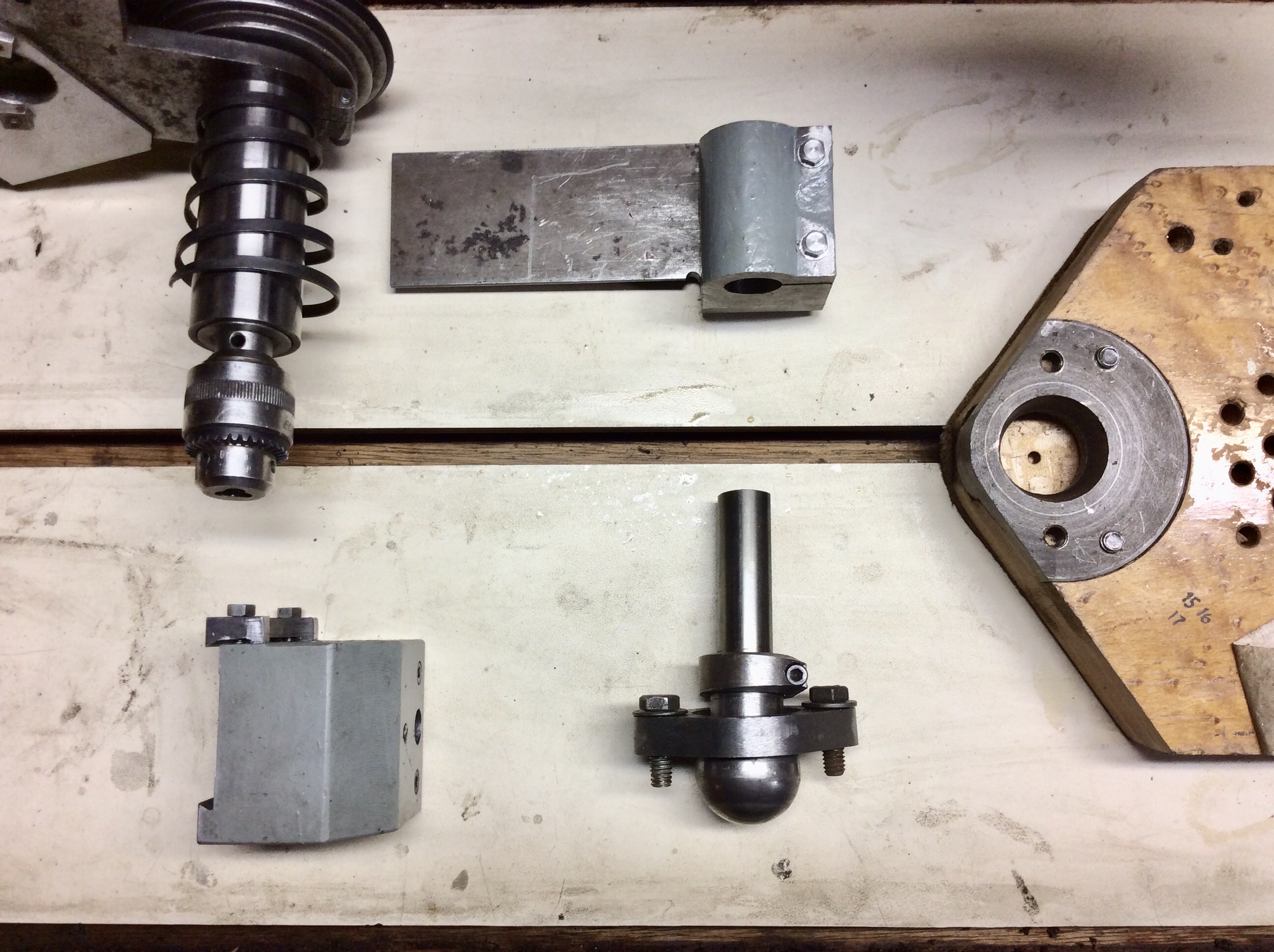

Parts
