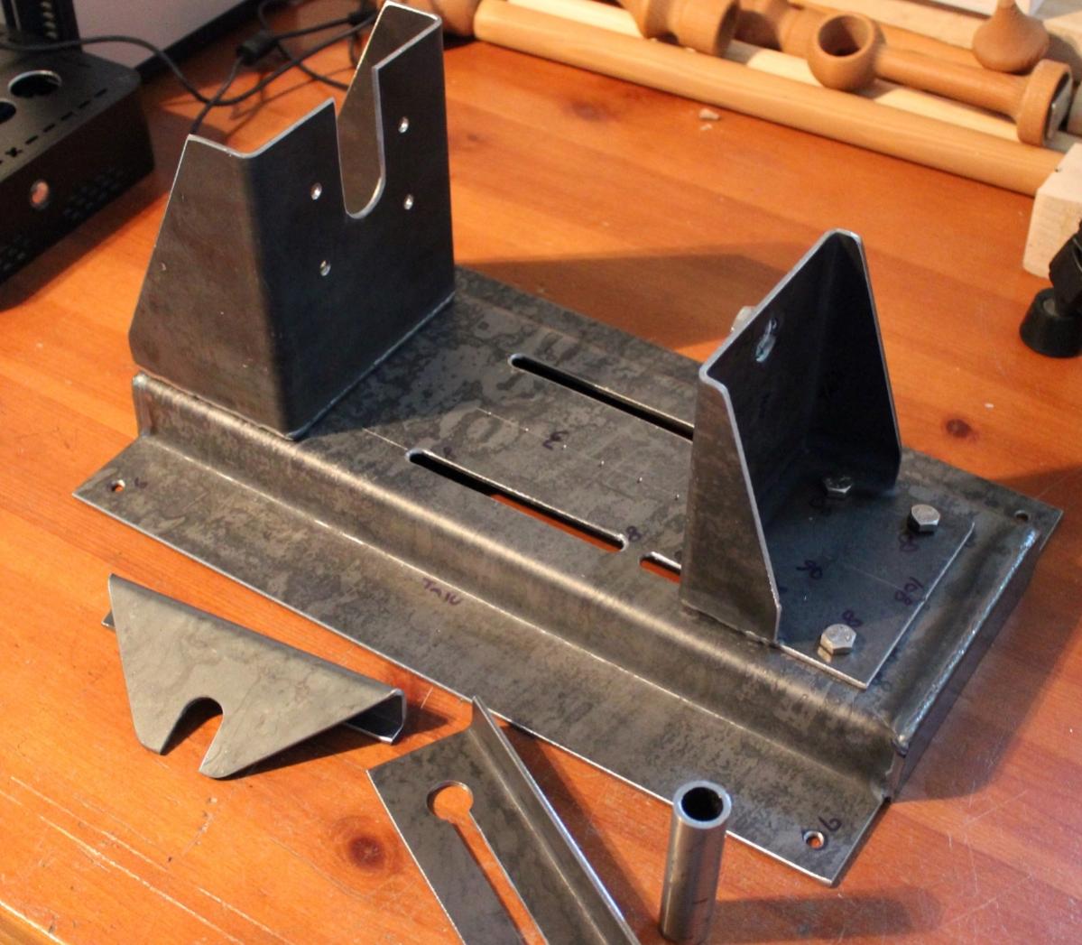

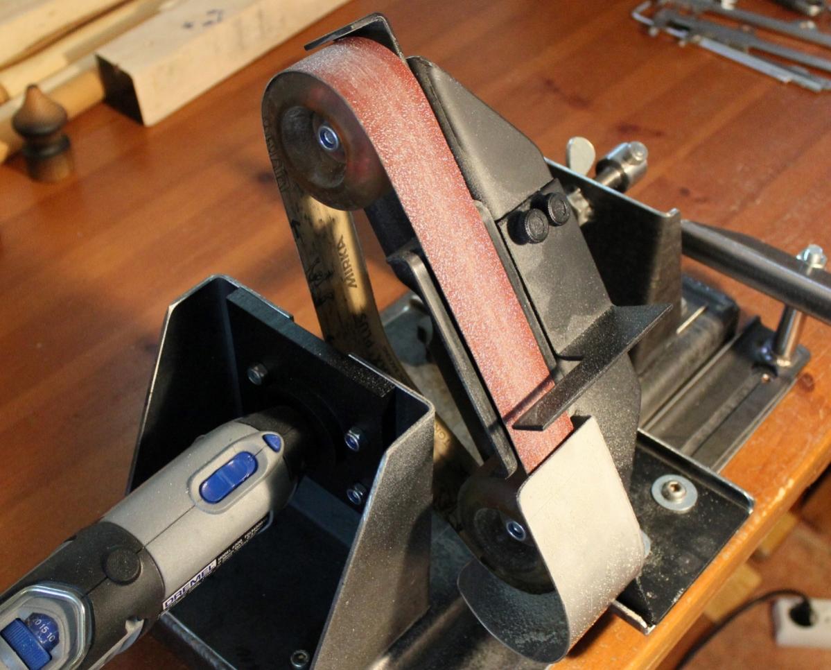

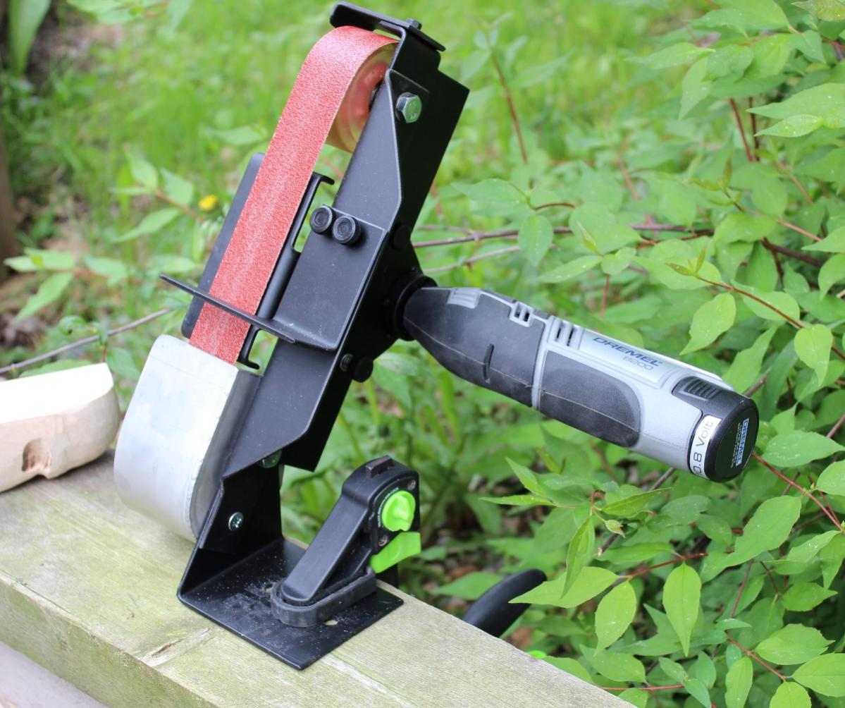

I made a simple belt sander attachment for dremel rotary tool.

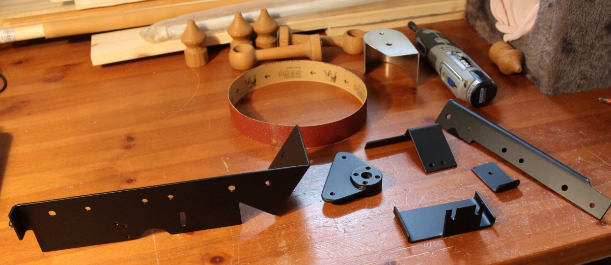

Material i used 3mm thick steel and wheels from a skateboard.
Attachment 11451
Structure is very simple and Its made from 5 pieces, connected together with nuts and screws.
Sander is powered with a Dremel 4000 rotary tool wich can be removed after use.
Attachment 11454

"Plans with the main measures" measures are in millimeters. One inch is 25.4 millimeters.
Attachment 14783Attachment 14784Attachment 14785
Later i made a little changes to it and now its an attachment in my rotary tool lathe construction.
Modified a splash guard from a dremel tool to hold the rotary tool, so its very quick and easy to attach.
Attachment 11452
Attachment 11453
