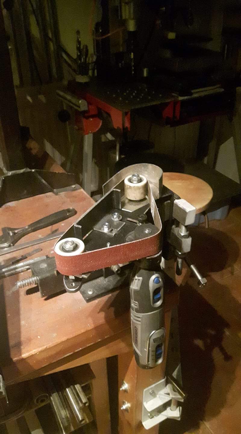

I'd like to see the interface between the Dremel and the abrasive belt. What did you use/make?
I was building another angle grinder attachment yesterday...
Then i suddenly just figured out, how to make good diy pulley for dremel belt sander, and how to adjust belt tracking easily.
Took some time, but finally i got it.
Attachment 25228
So.. i tought i remake this build.
Modified original build to use 520 or 533 x 30mm belts.
Also cut it smaller and lighter.
Works nicely.
Test video can be seen from this link.
https://www.instagram.com/p/BmyuWU0l...=185z7c7f2kpf3
Here is about making the pulley. Real Diy solution, but works nicely. Also its light weighted. I think weight is very important with tools in this size.
https://www.youtube.com/watch?v=qlR3...ature=youtu.be
Rubber stopper...Excellent application and the housing looks great and rigid! Thanks Tuomas for posting this upgrade!
PJ
Thanks PJs
Yeah.. now i wonder why i didn't think it earlier.
That rubber plug is inteted to protect threads in sandplasting.
Its very elastic. I have used them for noise / fibration dampening too, under table / chair legs. Specially good in sauna or bathroom when it protects wood from the moisture too.
Those are sold in 50 pcs packs here, so its good to have use for surplus too. :)
