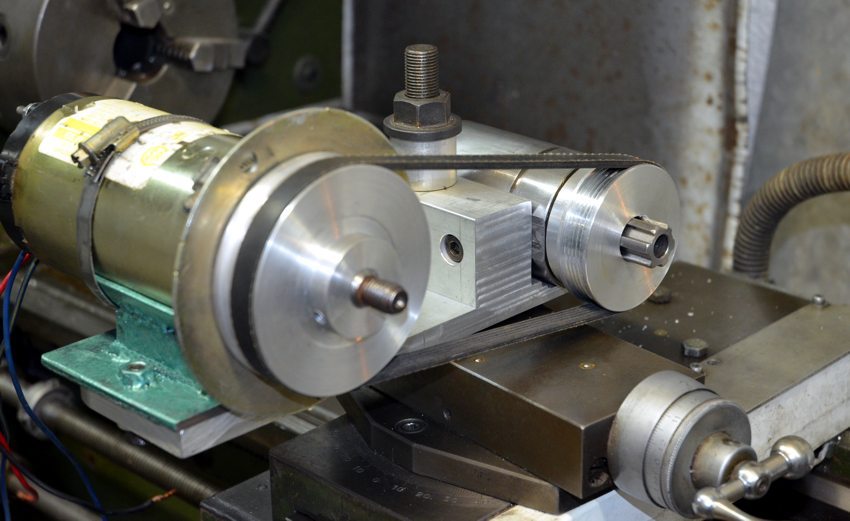

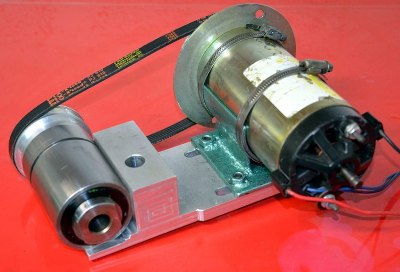

    Alan, nice one as usual.
    My toolpost grinder should more accurately be called a toolpost spindle, as you call yours, because it has an MT2 taper which allows the fitting of many different working ends, grinding wheel, internal mounted grinding bobs, drill chuck, ER chuck etc.
    Small toolpost live spindle-tp-grinder-12.jpg Small toolpost live spindle-tp-grinder-13.jpg Click pix for full size.
    I use a 2 HP DC motor from a treadmill with my own controller for speed regulation.

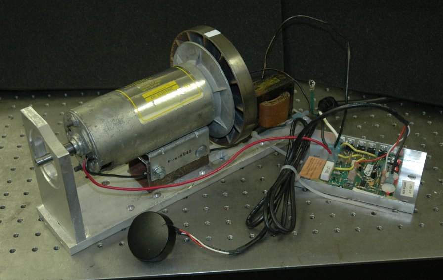

    I lived in the US for 3 years and over there they have two great institutions. Weekend yard sales and Craigs list. If you can't find something on one you'll find it on another. People buy treadmills with good intentions of exercising but soon get tired of it and decide that they need the space back.

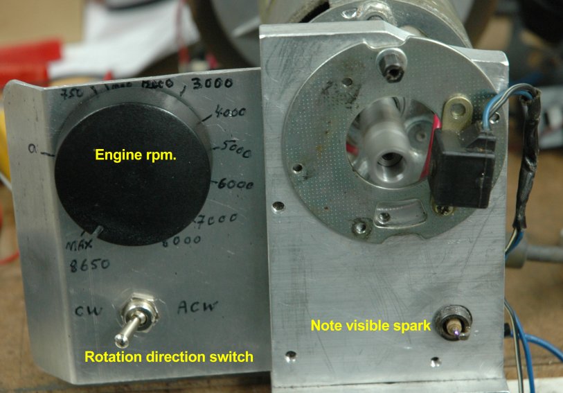

    I bought a treadmill whilst there for $10 or similar and when I left there was no way that I wasn't taking the motor. I also found a couple more motors before leaving. Many people use the controller from the treadmills but they have all sorts of built in safety features which make those controllers less suitable for use on machine tools. For example it is usual to have delays programmed in as well as slow start and slow stop features to avoid throwing you off the end of the treadmill. That is why I make my own controllers. My first use for one was as an ignition system tester.
    Small toolpost live spindle-igntester01.jpg Small toolpost live spindle-testing01.jpg Click pix for full size
    The pic on the left also shows the treadmill controller, it was on this device that I discovered the peculiarities of these controllers. The delays made it a pain to set "exact" RPM.
