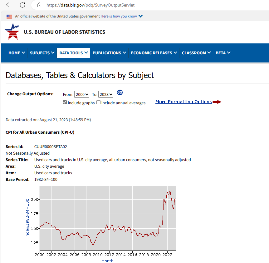

On the cash-for-clunkers thing. That happened in 2009; you can see the impact on used car prices in the BLS data.
Attachment 46085
