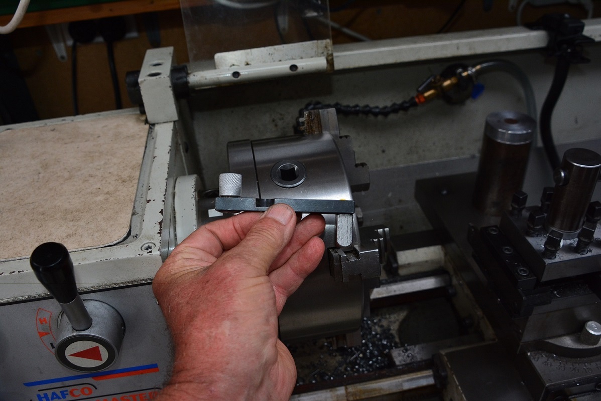

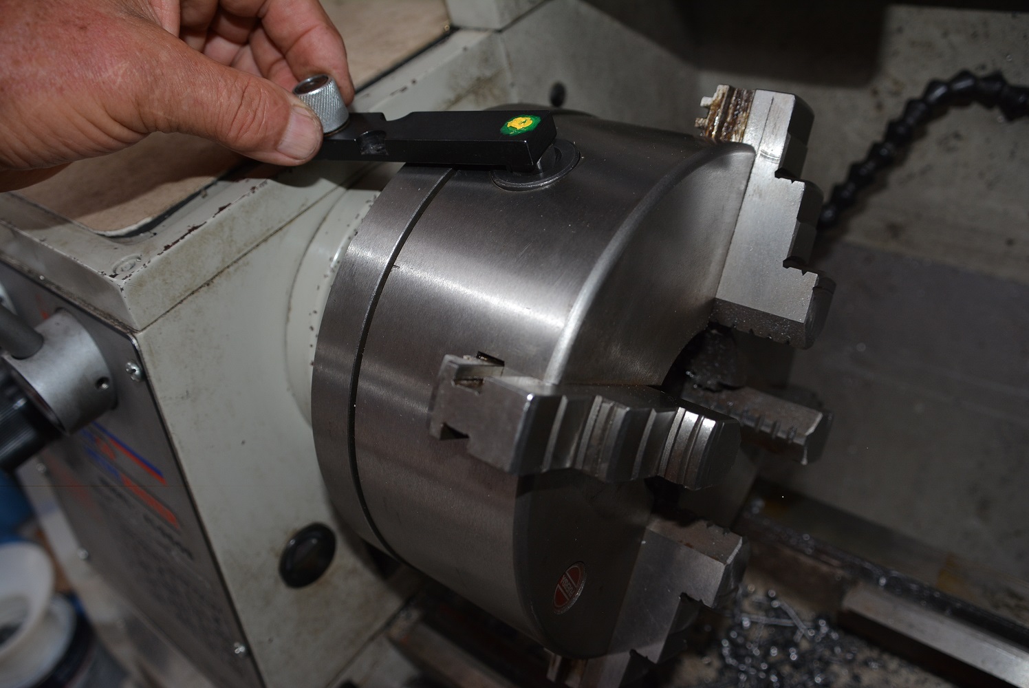

    What I did was to make a new chuck key from a piece of 3/4" SS I milled the right size square on the end.
    I drilled a 3/8" hole for the T handle on the other end but made one about 4" longer. I bent it to 90 degree at the 4" mark it it is secured in the hole with a set screw.
    It makes opening and closing a breeze and no need for a second key.

    I took a somewhat different approach. When the chuck is mounted I didn't want to have to use one tool to speed the jaw movement, then put it down and pick up the supplied chuck wrench to tighten the jaws.
    I mounted a 1" diameter aluminum cylinder to one arm of the chuck wrench. It's held in place by a setscrew bearing on a flat filed on the wrench arm. The top of the cylinder has a hemisphere turned on it.
    I have a similar key to yours with the exception that the upright is welded on not held with a screw. Your larger diameter, ball ended version would be more comfortable.
