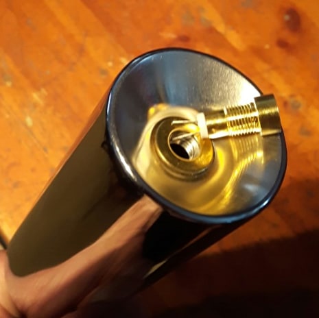

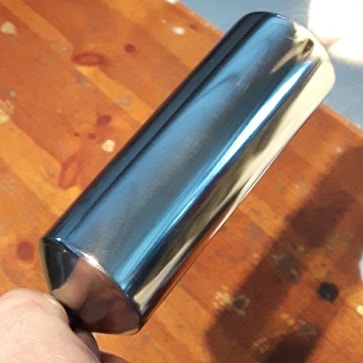

    Made this jig for stamping sheet metals, it also works when punching holes.
    I like to make tools that can be used many ways, it saves material and space.
    I have couple projects where i can use this tool. I shared it, because i tought one can get ideas from it.
    Cone shaped ends are stamped.

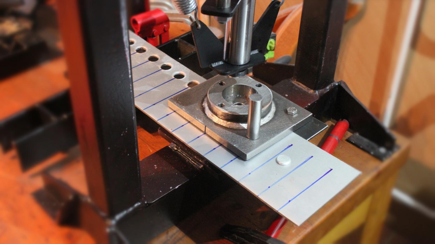

    Stamping and hole punching tool for hydraulic press.-img_20180412_103726_505.jpgStamping and hole punching tool for hydraulic press.-img_20180412_103726_506.jpg
    Bottom is flat, because i weld M8 nuts behind the plates, to attach leds and hose fittings.
    Made a "stress test" with 4mm alumine plate. I need to punch hundreds of holes to 1mm thick plates to make heat exchanger, so it looks promising.
    Didn't want to waste that test piece, so i used it for this.

    Nice build. Thanks!
    Can you describe the axel a bit more?
    What material did you use - something hardened or just cold rolled steel?
    Is there any special geometry to the business end of the axel (not the chamfered end) or is it just a flat surface?

    Its stainless 317. Hard enough for to be used with alumine.
    I supposed to make better version some day... But i haven't needed it. This one worked nicely with the task i made it. ( I'll post a pic from the finished heat exchanger if i found any )
