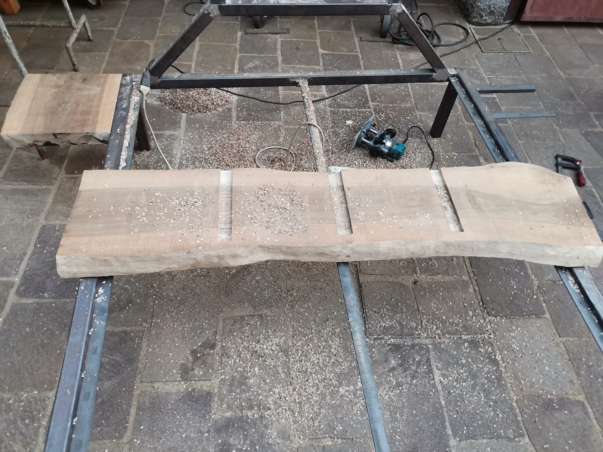

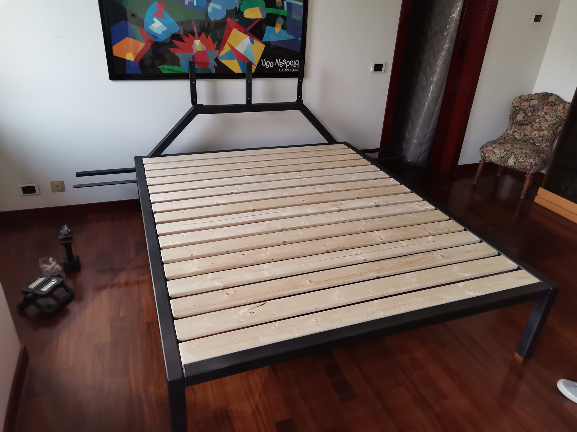

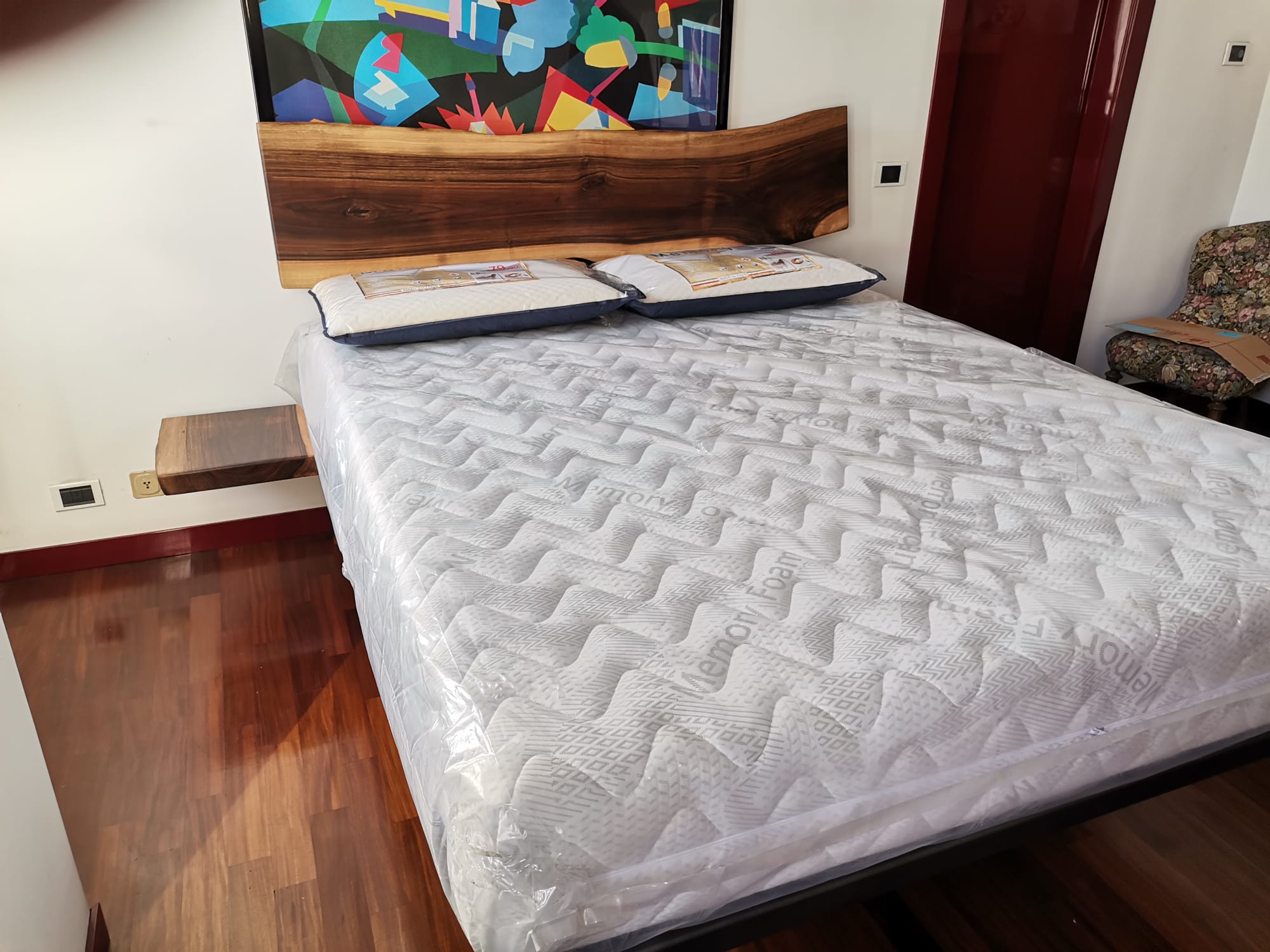

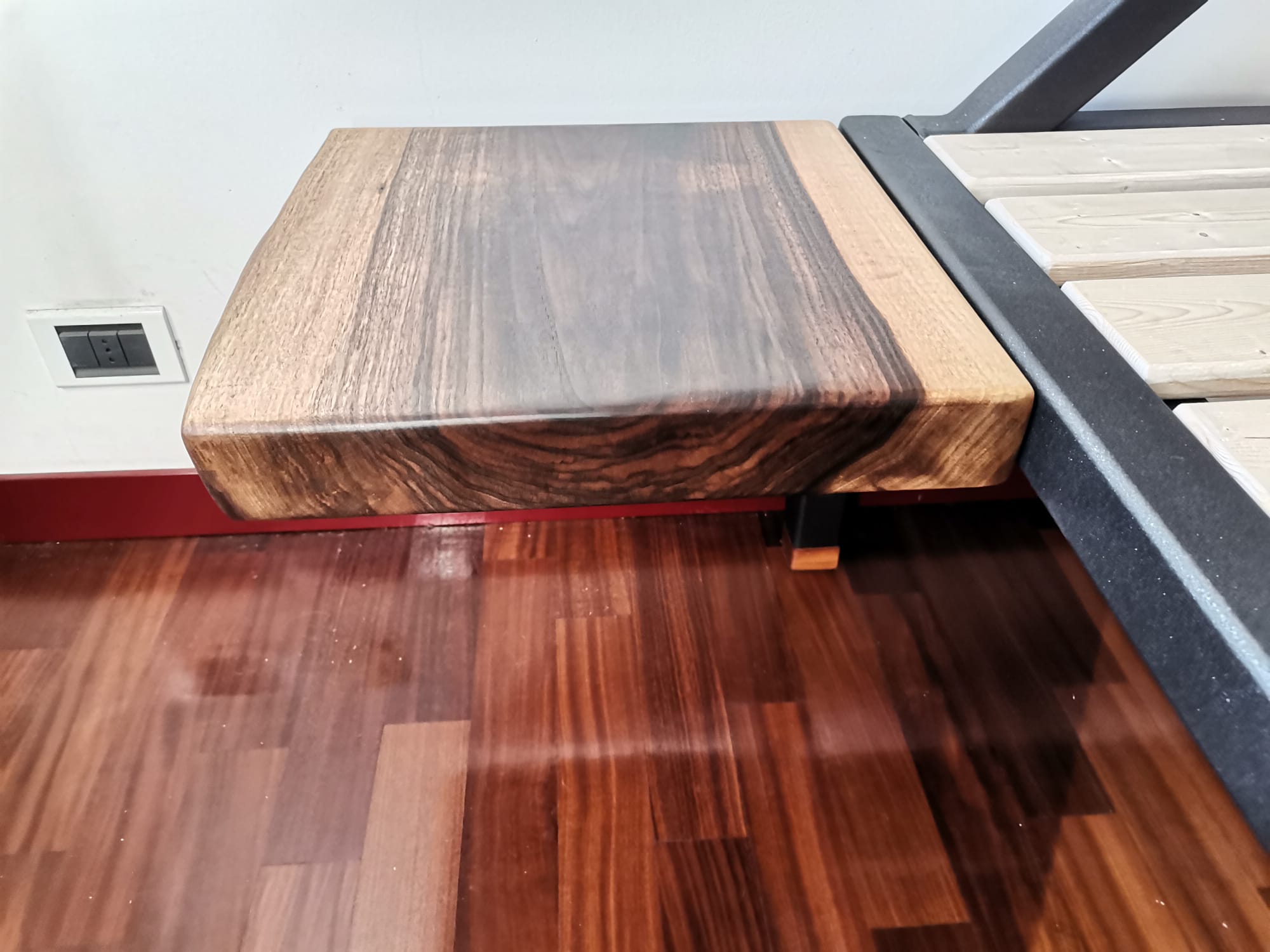

I decided to build my new bed, standard size 160x190cm.

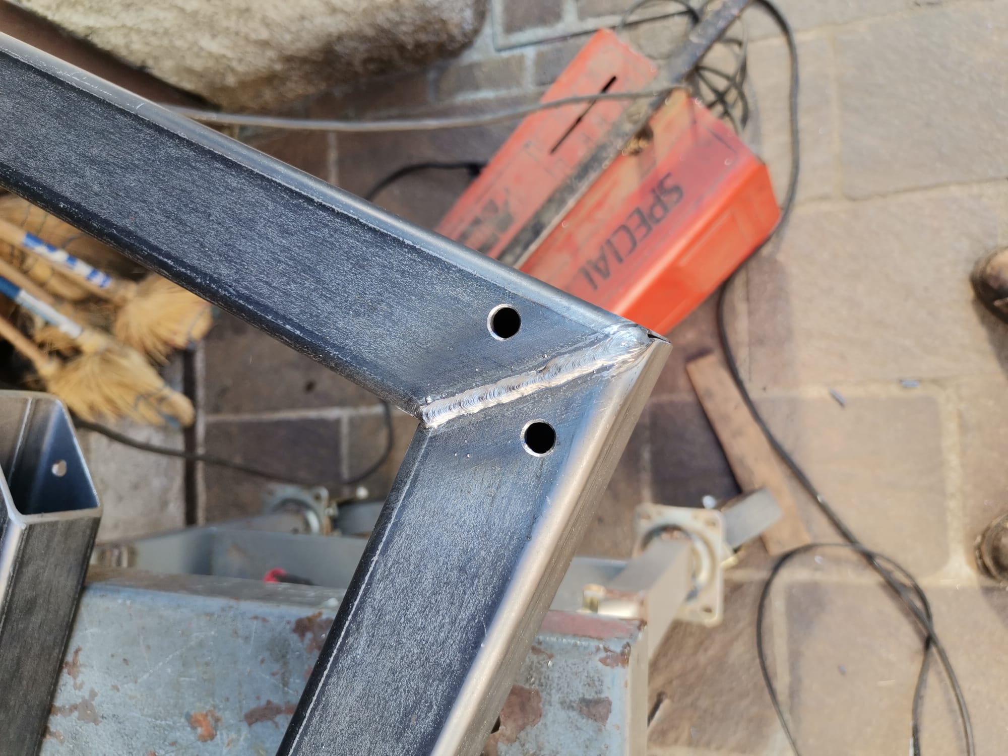

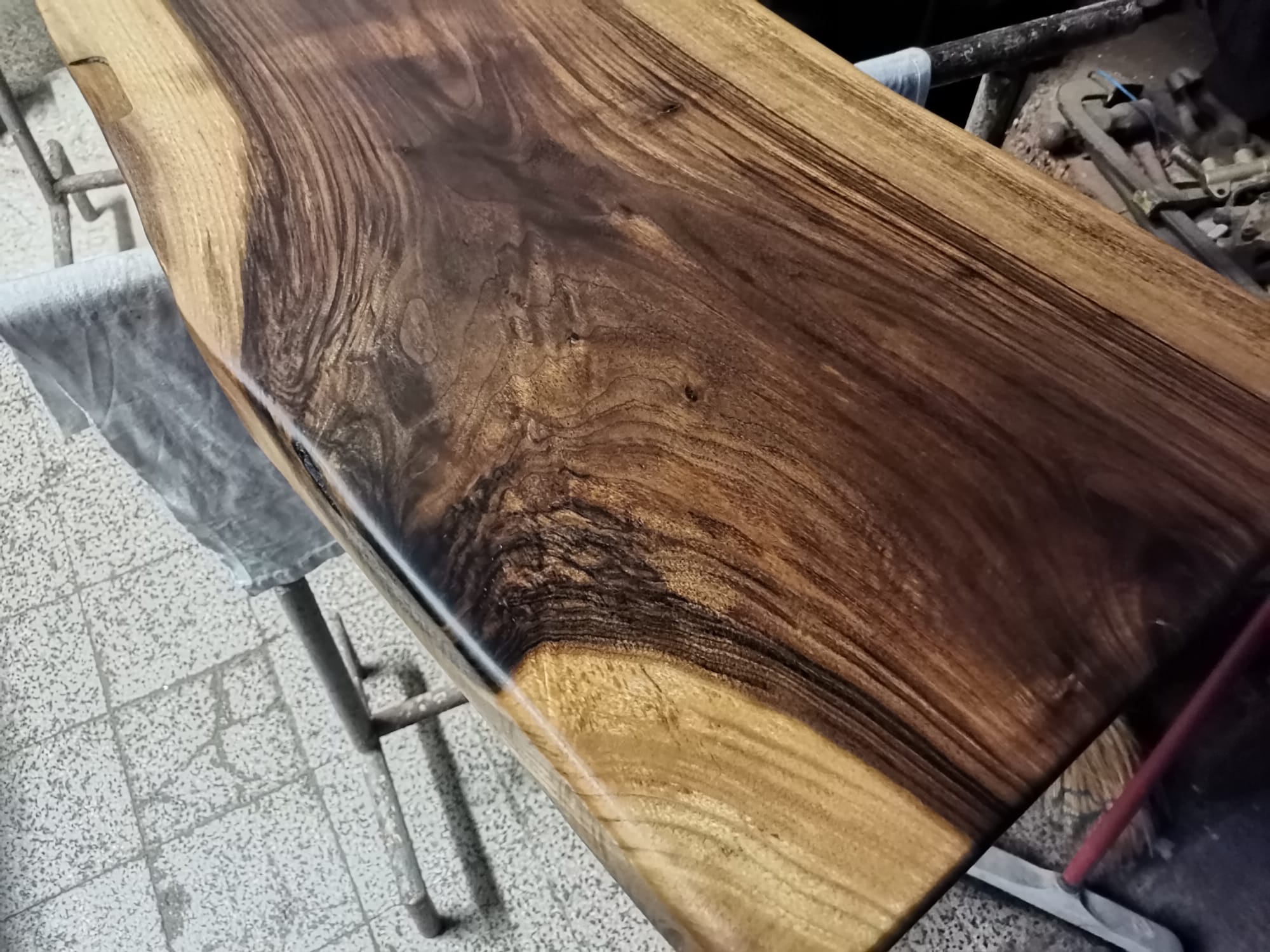

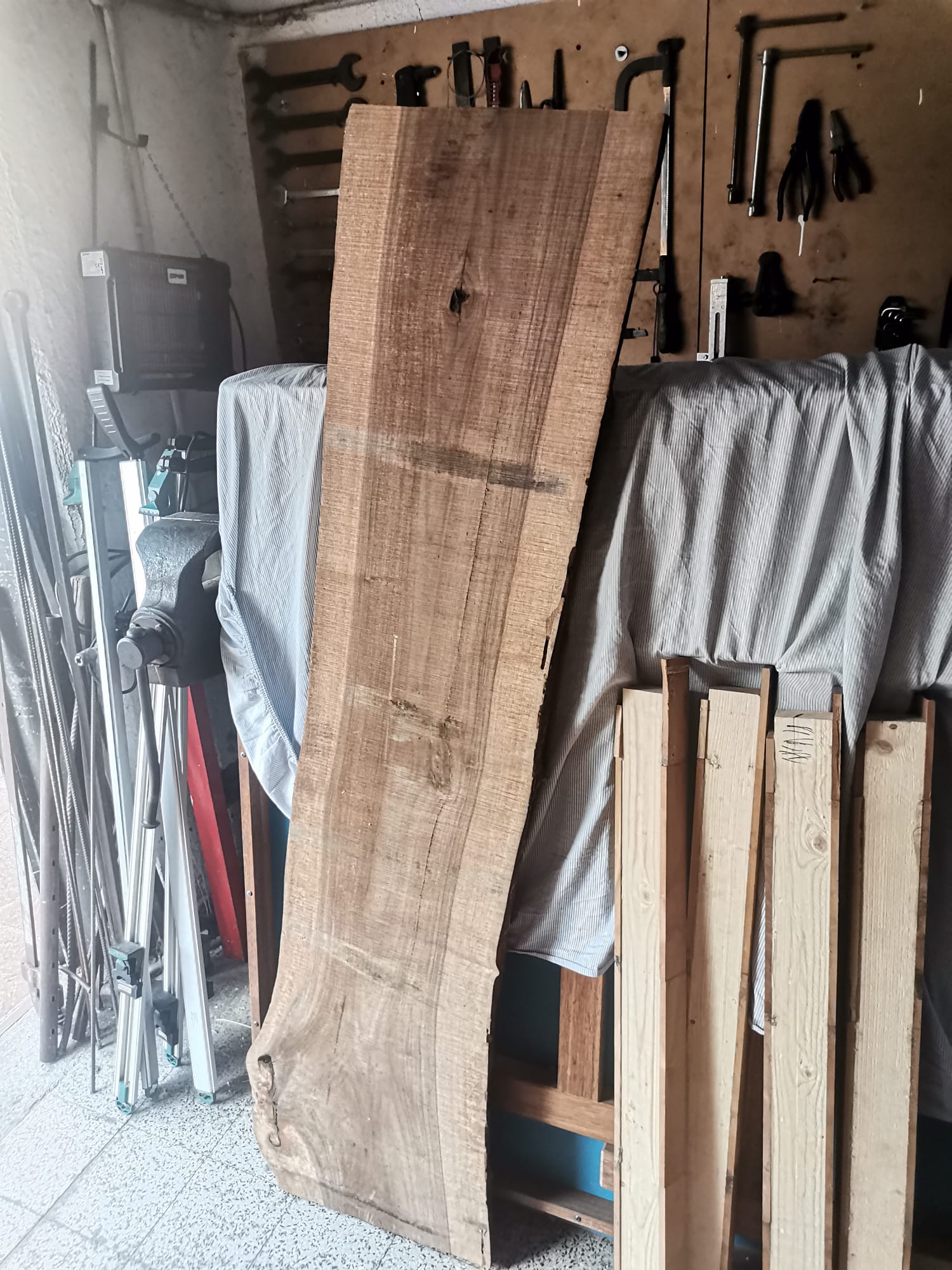

50x50x3mm steel tubes, stick welding. Powder paint, got a friend pretty good at this. The head is a 6cm walnut plank, 10 coats of boiled linseed oil. The slatted base is a flat area with fir thick planks.
