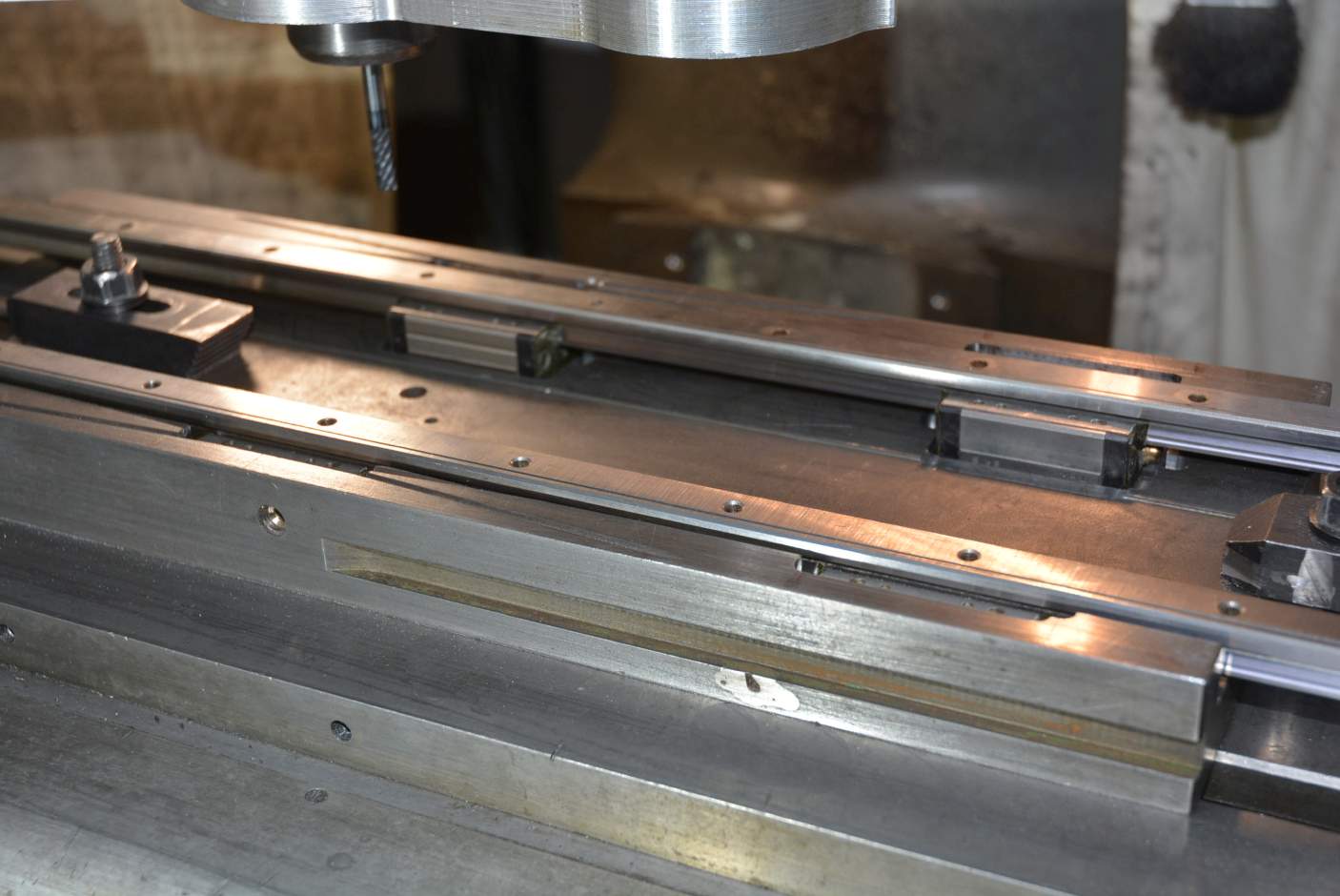

    Now I want to turn my electronically controlled lathe into a cam grinding machine which requires the best possible accuracy. When you are chasing tenths slide friction is the enemy of precision so the ball slides are primarily to reduce sliding friction to gain accurate positioning. I have a distant friend who is planning something similar so I made a 14 min video to pass on ideas. I thought that it might be of interest to others so here it is.

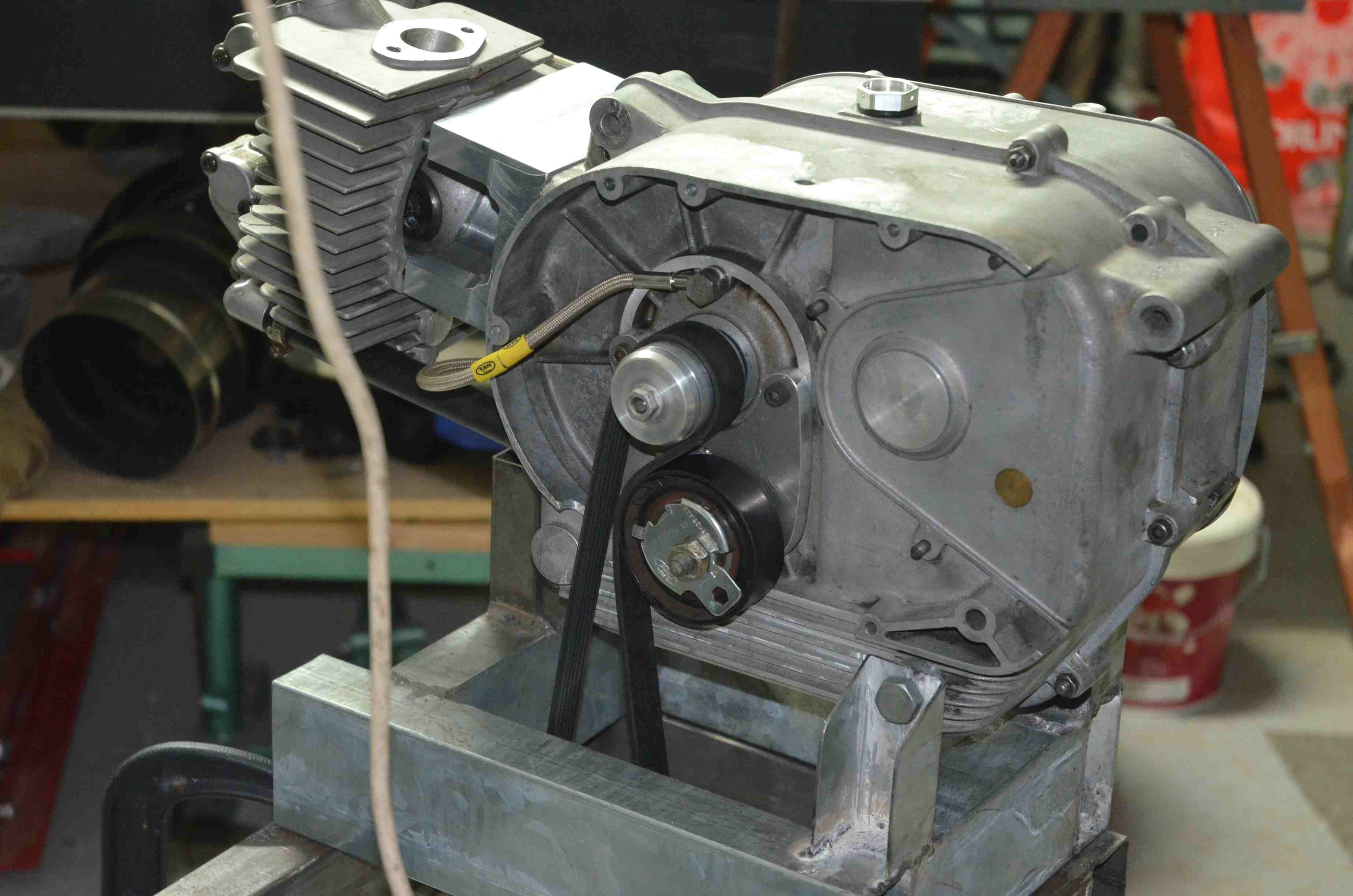

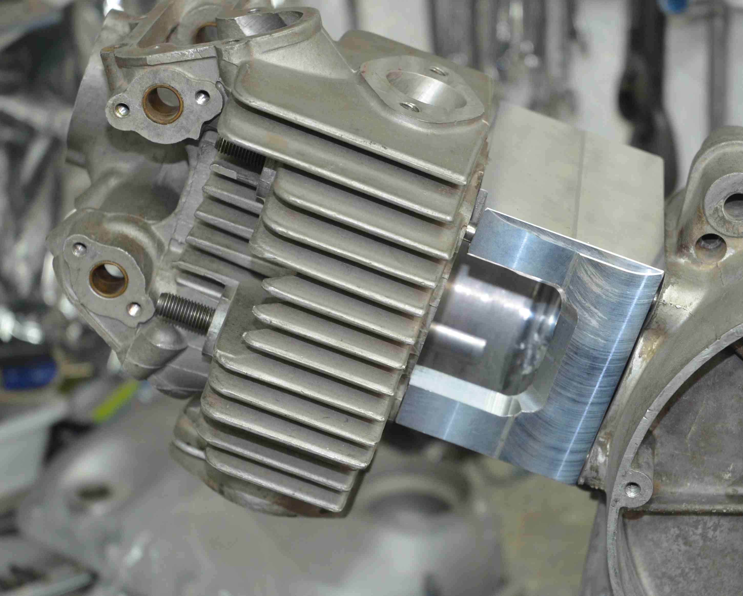

    I have written some software to synthesise cam profiles given certain inputs and limits. I have also built a setup for testing cams and viewing in slow motion with a triggered strobe light. This is basically an engine shell with a stripped and balanced crank to drive a cam under test. This is belt driven by a 6 hp motor. I have a dummy cylinder with viewing ports etc. Anyway, I want to made cams to the profile calculated by my synthesis software in order to validate (or not) the software. Well the software is only the messenger, the real test is whether I know what I am doing. This may be of interest https://www.youtube.com/playlist?lis...SvlfD6C_oAHYK3

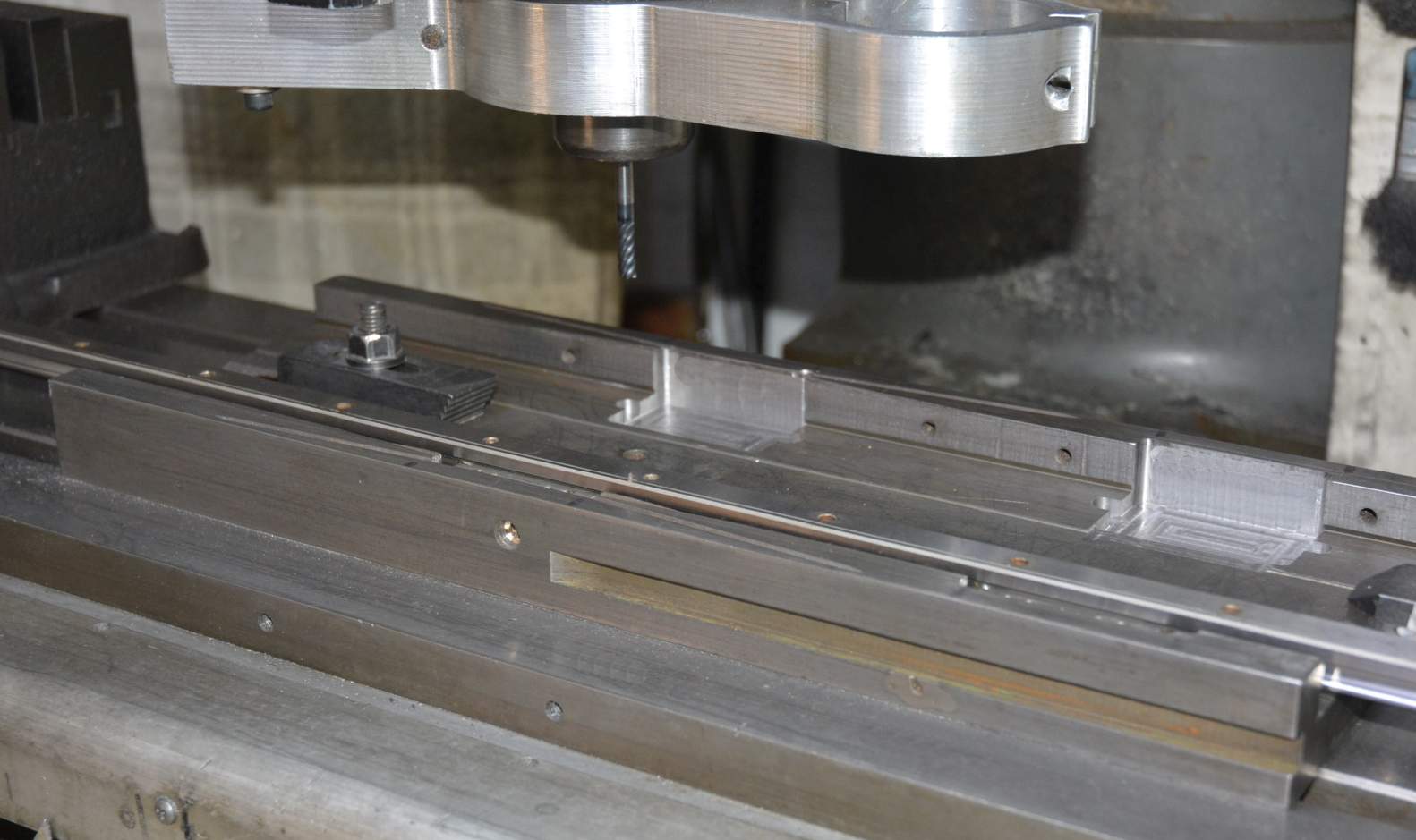

    For some time I have been thinking about converting my lathe to linear rails on the X axis but it always seemed like too much work until a couple of nights ago when I saw that it could be done very easily as described in the video. I have the slides on order but they are not due until between 27/12 and 19/01. Impatience got the better of me this morning and I did the modifications to the cross slide from the old larger lathe to take the slides. I was able to test fitting and function because I have the same type of slides, only longer, for another project. There is not much more that I can do now until the new slides arrive. There is some work to do on the saddle of the lathe but that would put the lathe out of action, so that also has to wait for the slides. Here are some pix of this morning's work.
    Step by step method for upgrading a lathe cross slide to linear ball rails.-cross-slide-02.jpg Step by step method for upgrading a lathe cross slide to linear ball rails.-cross-slide-03.jpg Click for full size.
    and some of the cam test device
    Step by step method for upgrading a lathe cross slide to linear ball rails.-spintron-17.jpg Step by step method for upgrading a lathe cross slide to linear ball rails.-spintron-12.jpg

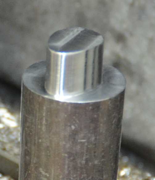

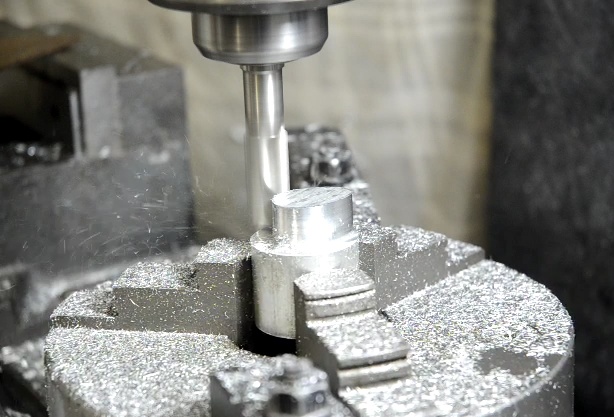

    I have not decided yet but I am leaning towards an hard facing alloy. Megacycle in the US use that on their cams. I have used this in the past but now there are all sorts of DLC and other coatings available that I will look into. Firstly I will have to convince myself that I can make cams good enough to warrant going further. I have, for a long time, been considering buying or making an HT oven. I even bought some A1 heating wire.
    Here is an example of a test cam from 4140 using the X&Y movements on a CNC Bridgeport mill. It measured up fine and I think that my current endeavors should be even better.
    Step by step method for upgrading a lathe cross slide to linear ball rails.-steel-cam-01.jpg Step by step method for upgrading a lathe cross slide to linear ball rails.-cammilling.jpg Click for full size.
