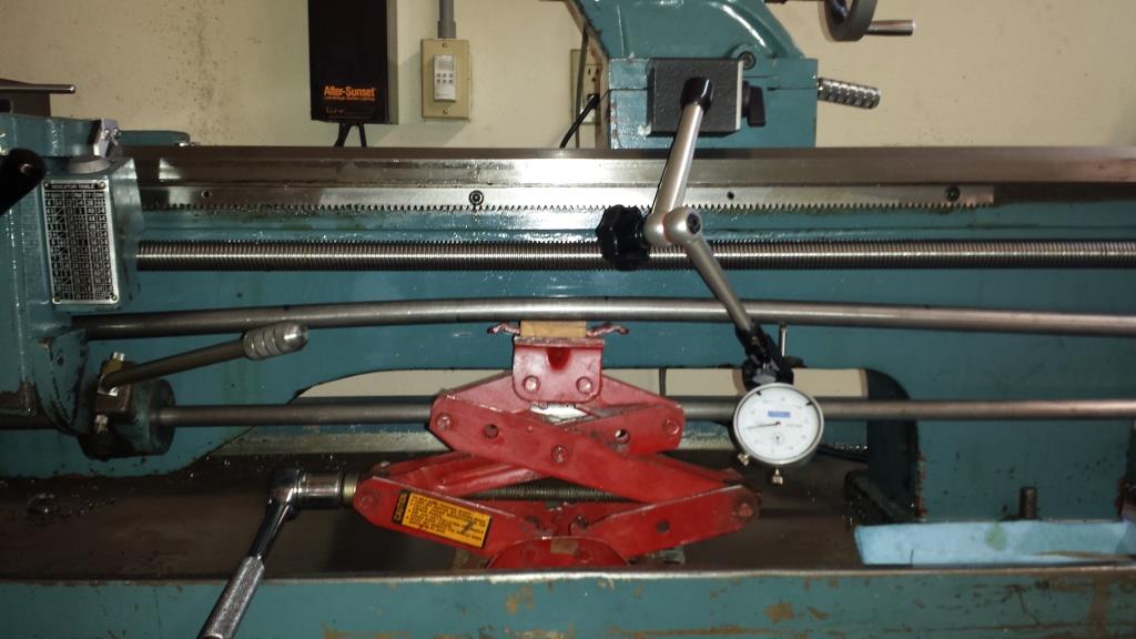

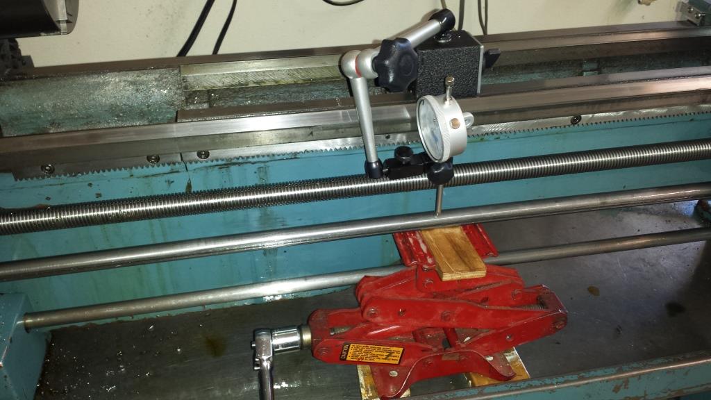

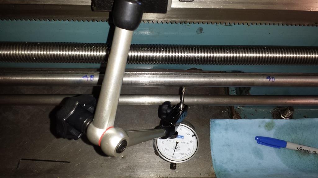

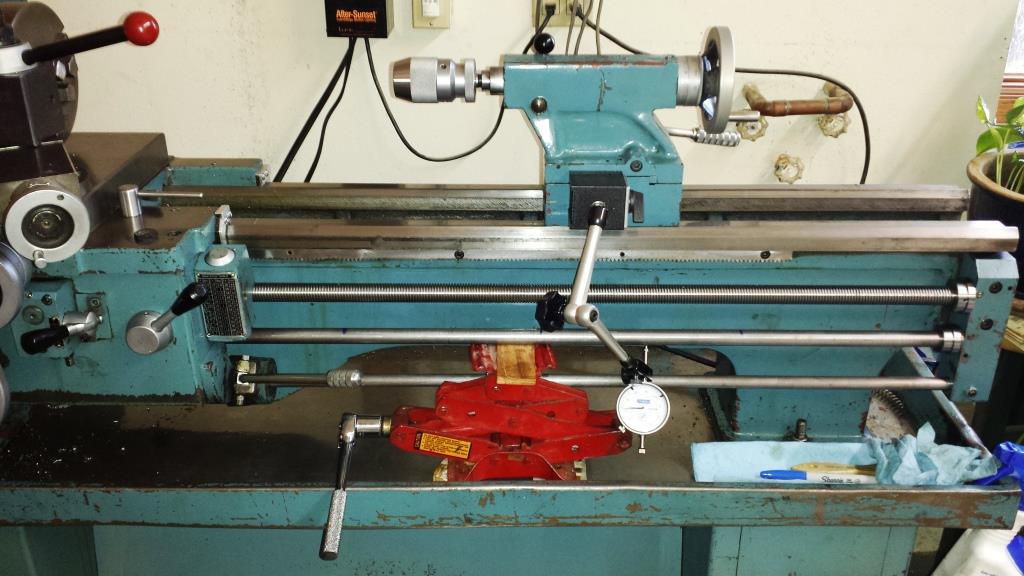

    I have a used lathe so I am not exactly sure how the feed rod for my 12” swing gear head lathe was bent. I used a dial indicator with an adjustable arm and magnetic base for measuring the rod runout. Measurements were mostly at 12” intervals and the runout measurement written on the rod with blue marker. Also, attaching the DI mag base to the side of the lathe tailstock and sliding the tailstock along the lathe ways greatly simplified the measurement process.
    I discovered a maximum runout of 0.055” at about one third of the distance from the headstock and a gradual decrease in runout towards the headstock and tailstock. I had read about solving the runout problem by either removing the feed rod or working with it in place. I decided to do the work in place. I also watched several of the shaft straightening YouTube videos by Keith Fenner. Seeing Keith’s videos gave me confidence that the shaft has to be bent way beyond the 0.055” runout in the process of straightening the shaft.
    I used a scissor jack and measured the upward vertical extension movement with a DI. It took almost 0.500” in movement in the opposite direction to the bend to eventually decrease the 0.055” runout. When you do this for the first time, and see the large bend in the feed rod, you think you going to ruin the feed rod. Upon slowly releasing the jack and measuring again, you realize it is going to work. Just work slowly and methodically, measuring and marking the improved runout corrections. Eventually, I corrected the runout to a maximum of 0.008" along the entire length.
    However, after applying the bending corrections many times there comes a point when the runout begins to rotate (spiral) the along the axis of the feed rod. I think this is when it would be better to remove the feed rod and use a hydraulic press (or even spot heating method with a torch) and measure the corrections at the workbench. My significant improvement in the feed rod runout is okay for now. Eventually I plan to rebuild the gears and bearings in the feed power mechanism in the lathe carriage apron. This will be an opportunity to remove the feed rod and make the final corrections off the lathe.

    I just have to ask why you are worried? That is a long slender bar and the lead into the drive worm has lugs either side that will force the shaft into line. Unless the rod had a definate kink that was causing problems I would like to know the reasoning behind this. The 'spiral' can be a nightmare to chase even between centers and straightning with V-blocks in a press.

    I have to believe that Keith Fenner would be having a cow seeing this. The damage you could do to your lead screw drive and heaven knows what else. Don't be lazy, remove the screw and rig up something with a hydraulic or your scissor and straighten the screw off the lathe.

    Paul, One method of straightening which gives more control is to chuck the shaft and work your way along it in increments correcting as you go, do this for as long as it takes end for end until you are happy with it, this way you do not get the kinks or spiral errors.
    I do this often on bar stock that is close to the size I need.

    I am sure Keith Fenner would be having a cow seeing this but don't worry because the final corrections to feed rod vibrations became almost perfect by taking the chance of doing this in place. The spiral errors are in within a few 0.001" and the feed rod is now running almost perfectly true and probably better than it is was when it was new in 1987. The proof is in the machining finishes showing almost no surface variations and even better than before I made the feed rod correction ( http://www.homemadetools.net/forum/l...7293#post23627 ). The correct approach would have been to completely remove the lathe feed rod and do it off the lathe and systematcilly making the correction with a hydralic press like Keith Fenner has shown in his YouTube videos.

    I know and don't worry because I did have a big laugh about "having a cow". That is exactly the way I started to feel after the first time I bent the lathe feed rod way beyond the 0.055” runout in the process of straightening the shaft. At first I had this bad feeling that maybe this wasn't such a good idea after all but then I could see the immediate improvements and remembered how much Keith Fenner had to flex a shaft during the alignment process.
    I would not recommend doing this "in place" straightening to the finely made lead screw that is just above the feed rod. The lead screw would have to be removed and carefully protected before doing any strengthening work off the lathe.
    I finally removed the lathe feed rod and lead screw when I made the thrust bearings for these parts (see http://www.homemadetools.net/forum/l...7792#post37667 ). I almost accidentally bent the rods again when removing the two roll pins from the bearing block at the right end of the lathe before removing the two cap head screws. The block is approximately one inch thick but the lathe builder used 3" long roll pins set 2" into the lathe bed casting as guide pins to correctly align the bearing block. Removing the bearing block by clearing the long roll pins was not easy (potential of bending the lead screw, feed rod and motor control rod) and I later replaced the long roll pins with much shorter versions when replacing the bearing block.
