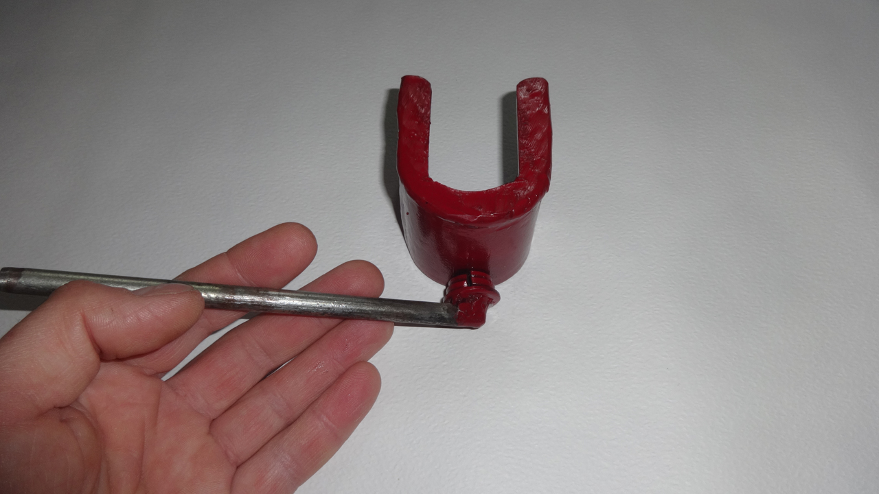

    Thumbs up Super Drill Chuck Key

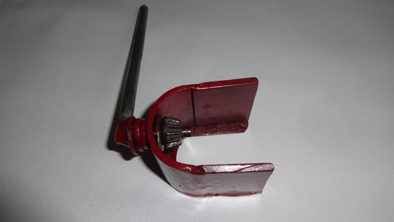

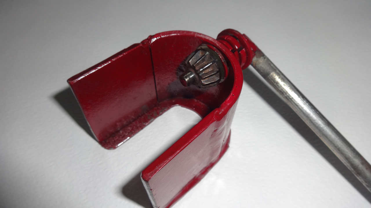

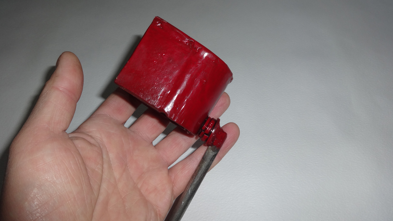

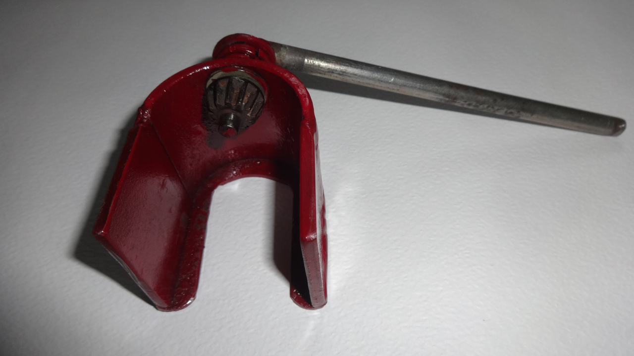

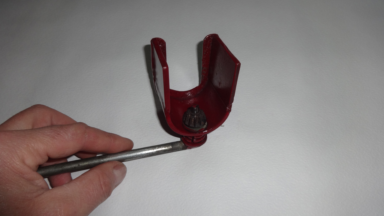

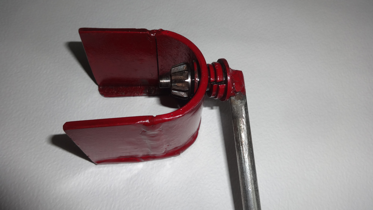

    In this video I make Super Drill Chuck Key. This Drill Chuck Key very comfortable in work!
    Quality photos https://photos.app.goo.gl/kESqu4FcoY9qHkou6

    I have to say I really appreciated the way this instructional video was edited. Very clear about what you were doing — and all the steps you were taking — while sparing us the boring shots of cut-outs and weld-ups. And by not belaboring the obvious. And the music was the best part. It really seemed to move with the pace of the video itself. As for the tool itself — it does look like a better mousetrap.

    Perfect solution to my problem
    [QUOTE=liberal;124825]In this video I make Super Drill Chuck Key. This Drill Chuck Key very comfortable in work!
    Liberal, your chuck key is perfect for me. I’m losing my upper body strength (cancer) and this is the perfect solution for my drill press.

    well i hate to throw cold water on this but,,,,it looks more like a solution to a problem that doesnt exist...except f the guy w cancer,,,here in the USA it will NOT pass muster in the workplace as OSHA will deem it a mutilated tool and make u remove it from the premisies,,,with a longer handle it will put more torque on the gear teeth,and they will wear out and break also...thats why chuck keys have short handle in the first place,,, the way i was taught in Vo- Tech-Machine shop was to use all 3 holes in drill chuck to tighten chuck, one right after another, doing so i rarely have a drill slip in the chuck,, broken a few but no slipage,,,now we have key less chucks and flat 3 sided drill bits which work good together in a hand electric drill,, but NEVER together in a drill press or milling machine, u will need a pipe wrench and a 3 ft long cheater pipe to remove drill bit if it is hard drilling material..good job making it though, just not f me..KISS is my motto..keep it simple stupid.
