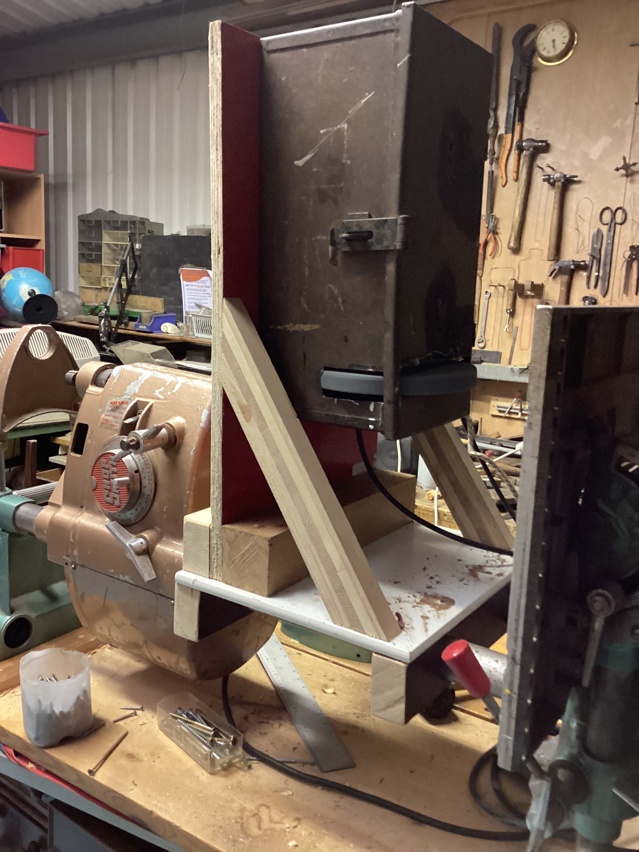

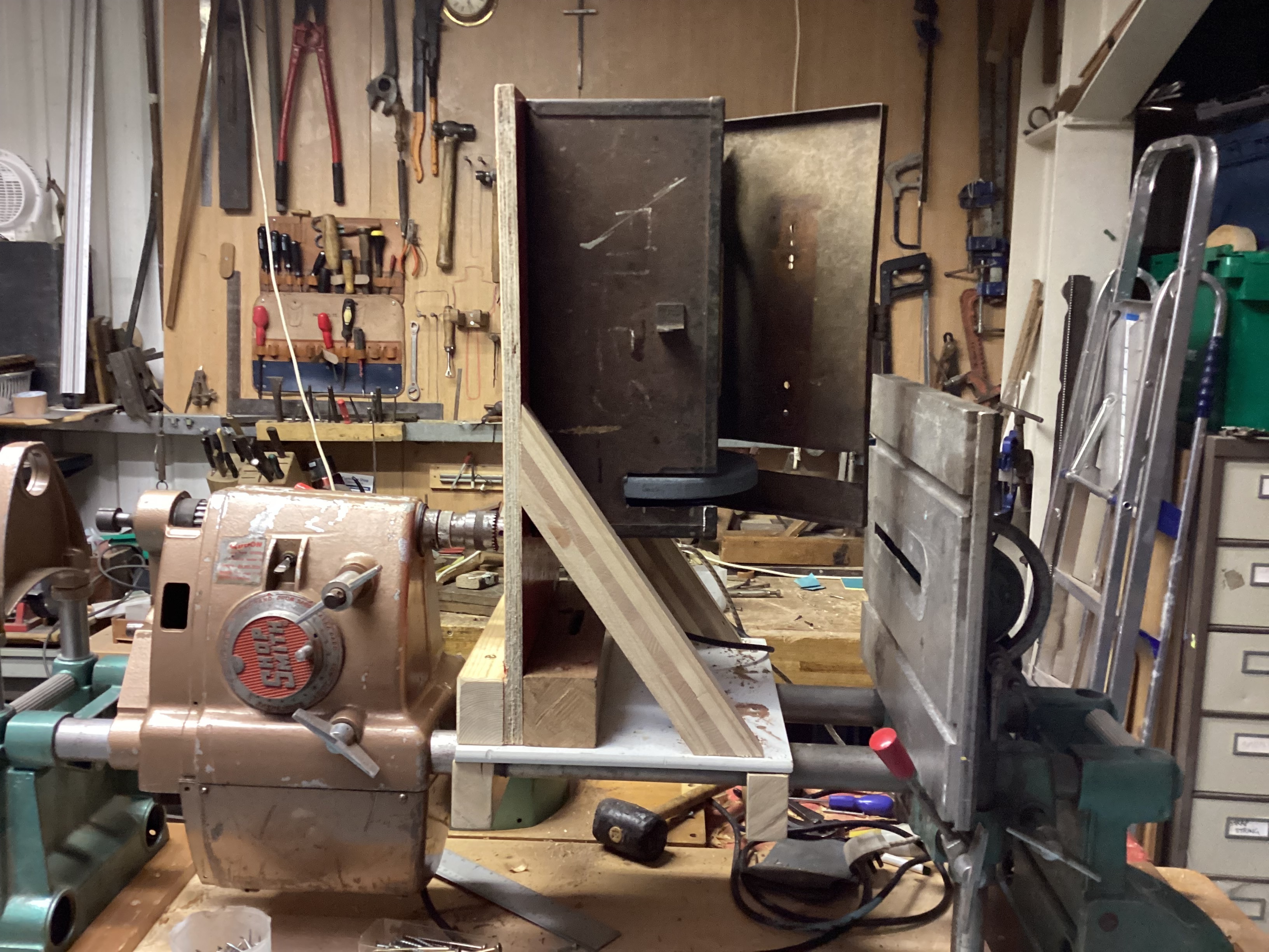

I have a plate 9” square, 3/4” thick, rough, concave and perhaps to be cut into 3 parts, and then use it to make smoothing planes. I don’t know whether it is cast iron or steel. But I don’t fancy filing it flat. I saw on HMT a rig for an angle grinder. A very good idea! I could not produce an accurate rig like that and don’t have the materials, but thought of mounting a bench grinder on to my Shopsmith.Attachment 46454
Attachment 46455

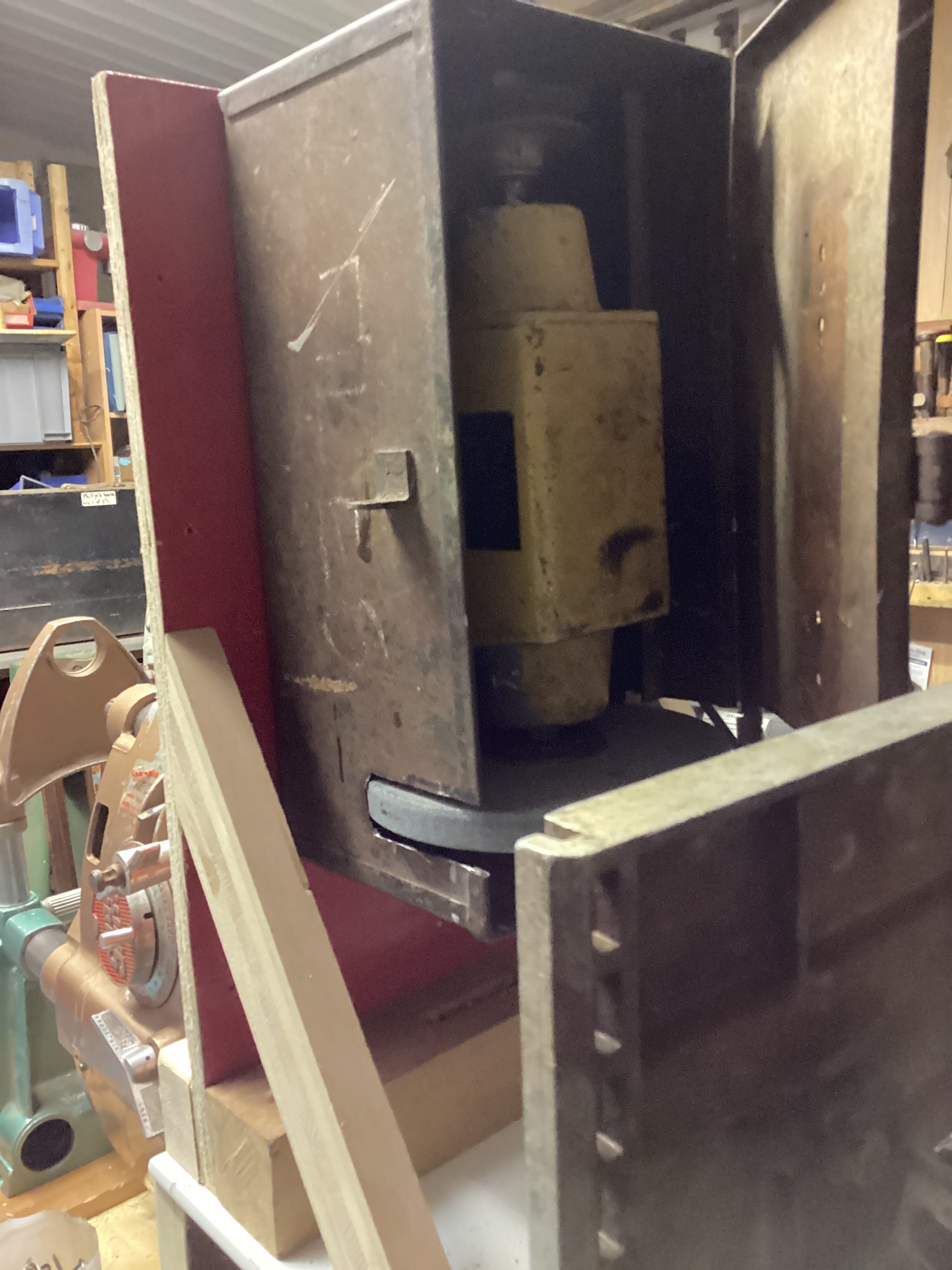

This is in our workshop, which is really for repairing furniture for residents in need, so, being a commercial property, the grinder has to be fully guarded, per regulations. So an old salvaged steel toolbox, happily the right size for the grinder, had a slot cut, then mounted on a stand,as shown, which slides along the Shopsmith’s bars, and the headstock can be used to advance it, and lock it. I brought my compound table from home and mounted it on the Shopsmith’s table, and made a pair of bars to secure the plate.

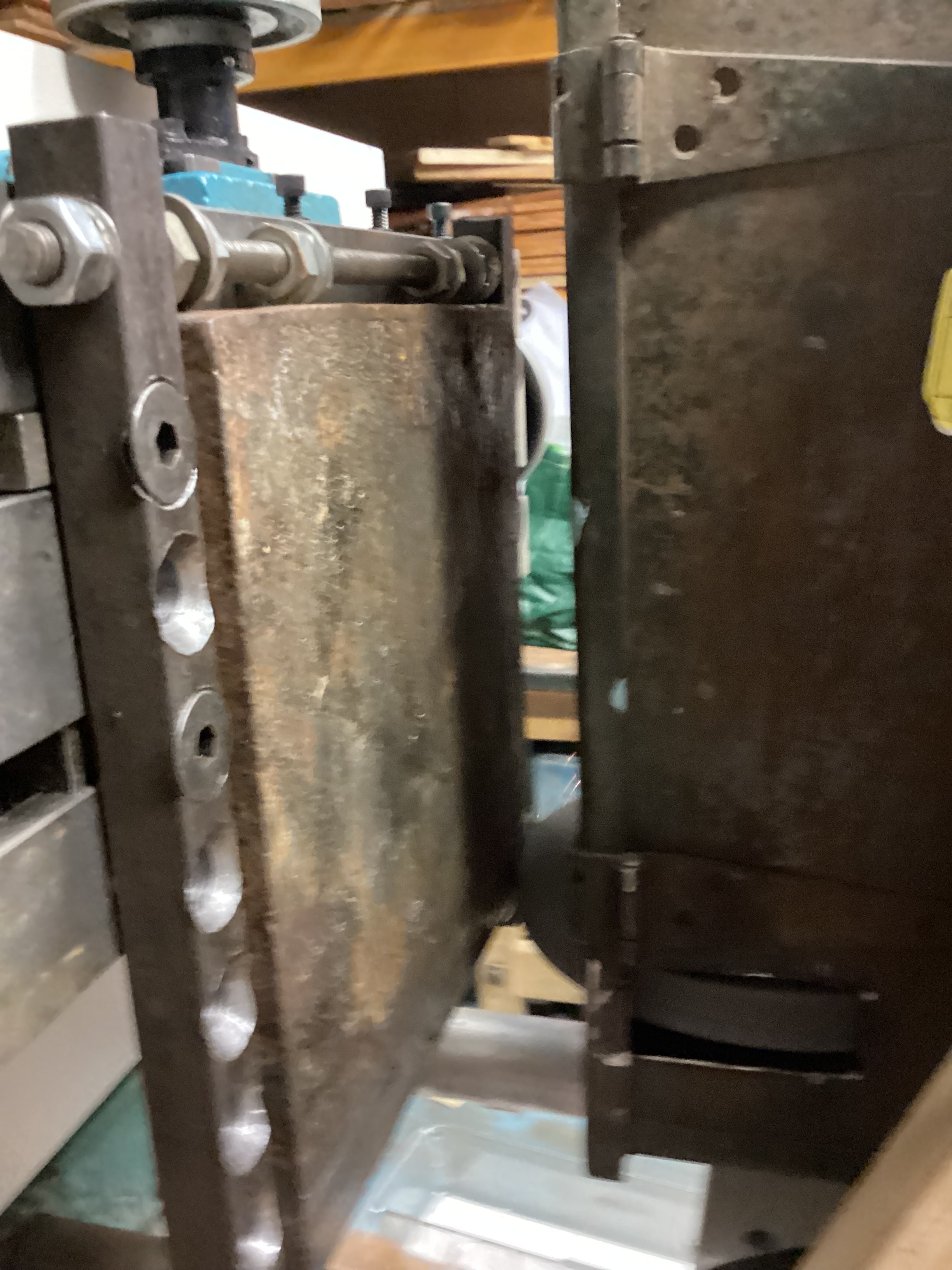

Attachment 46456
This shows the first traverse.
After all that, it became rather tedious to continue for long. It’s not a priority. Also, only about 4” of the surface can be ground at a setting. It is apparent that the surface is not wholly free from blemishes. Probably the workholding needs set screws to lock onto the plate. Needing the bench for other jobs, I dismantled the Shopsmith and put the components away, as before. It can be put together again. Also, you may observe that the Shopsmith’s lower structure is missing. It’s mounted on a softwood base, which is very unsatisfactory, and has now been discarded in favour of high density fibreboard, which hopefully is fully flat.
