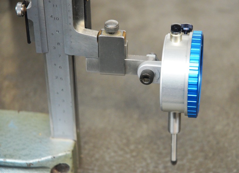

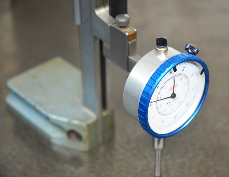

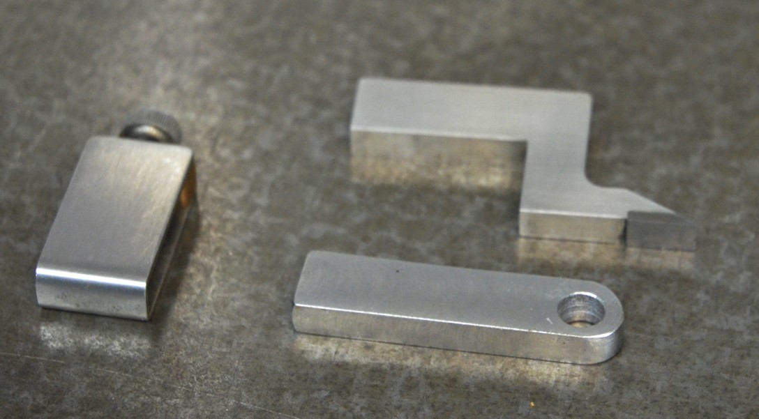

    To make the height gauge hold a dial indicator, ........
    I didn't see this posted by anyone, which I was hoping to see for a better design.
    I make no claims that mine is better but it is different to yours and I think somewhat quicker to make. It has a bit more flexibility in that you can turn the gauge such that the plunger is horizontal. There are times when that can be useful.
    Surface plate height gauge adapter for dial indicator holding-gauge-height-01.jpg
    Here is the holding piece, some rectangular bar with a single hole and rounded end.
    Surface plate height gauge adapter for dial indicator holding-gauge-height-02.jpg Surface plate height gauge adapter for dial indicator holding-gauge-height-03.jpg
    The assembly.

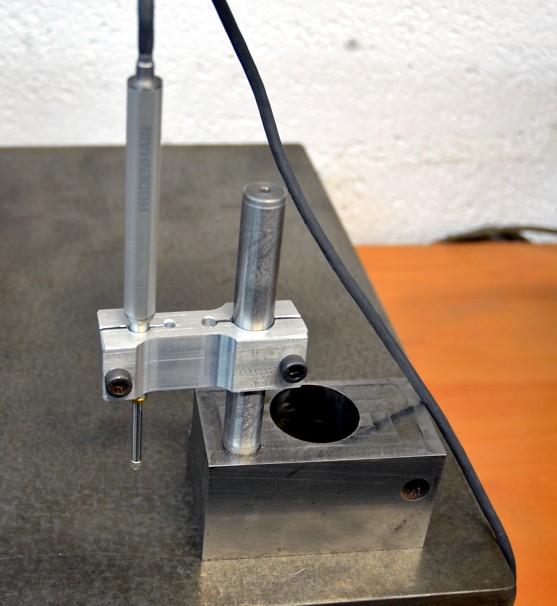

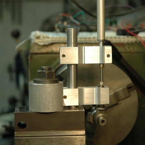

    Surface plate height gauge adapter for dial indicator holding-linear-encoder.jpg Surface plate height gauge adapter for dial indicator holding-lift-encoder-tappet.jpg
    On the left the encoder is clamped for use on a surface plate. On the right it is mounted in place of a lathe toolpost for measuring camshaft profiles. The large hole in the block is a legacy of the block's previous use. just a nice heavy piece out of the scrap box, hardened and ground on the bottom and sides so ideal for its new use.
    Here is another example of clamping on the shank that I posted a while back.

Name:	linear encoder.JPG
ID:	17483 Click image for larger version.
Name:	lift encoder and tappet.JPG
    http://www.homemadetools.net/forum/p...5372#post81710

    How accurate is the linear encoder? I'm looking for something to use on the surface grinder, as I can't trust the down feed dial.
    i envy you for having a surface grinder. i could really do with one as well as a cylindrical version, oh yes I might as well add a cam grinder whilst fantasising. The encoder pictured is/was 1 micron accuracy with 5 micron resolution using the usual X4 quadrature trick. However, it is with some embarrassment that I have to confess to recently zapping that encoder, accidentally applying 12v to it when 5v is desired and 5.5v is the limit. I found it NOS on ebay for $180, it was a bargain as shown when I asked for a repair quote from Heidenhain. Repair would have been £400 and renewal £1000. More googling and I found a new Ono Sokki GS-1830 Linear Gauge Sensor 30mm for $200 which should arrive this week. That has 1 micron resolution and 2 micron accuracy. So good quality examples are out there for good prices if you look and get lucky. There are dozens of cheap Chinese rotary encoders on the market which work pretty well but I have been unsuccessful with finding similar cheap versions of linear encoders, so new from regular suppliers means $1000 and up unless you get lucky on the internet.
    Regarding the cam lobe measurer, I feed the rotary and linear encoder outputs into an Arduino for decoding and then pass it on to a Laptop via USB where it gets processed and plotted in analysis software that I wrote, which also combines it with flow bench data.
    From looking at your piston crown thickness gauge, and your camshaft lobe metrology, you must do custom engine work needing such measurements. Is this for hobby or 'prostitution'?
    I have just turned 73 so I'm a bit old for prostitution any more. Hobby is a bit mild, "life time passion" would be closer. i used to race motorcycles semi-seriously and now I race in classic events and I try to spend all my non-racing time sleeping or building/preparing my bikes.
    In the 70s and 80s I had a business in the UK making bike chassis, many of which have won championships around the world. Since the late 80s i moved to live in Spain and since then I have not done any physical construction for others, finding it easier to tell others how to. In other words I became a madam. So I turned to writing, doing seminars and developing software etc. You can see more of my history and activities by looking at the following links in addition to a few posts that I have made on this forum, Homemade Tools built by tonyfoale - HomemadeTools.net . Although I seem to have gained the reputation as the chassis guru it has always been engines that have been a stronger interest.
