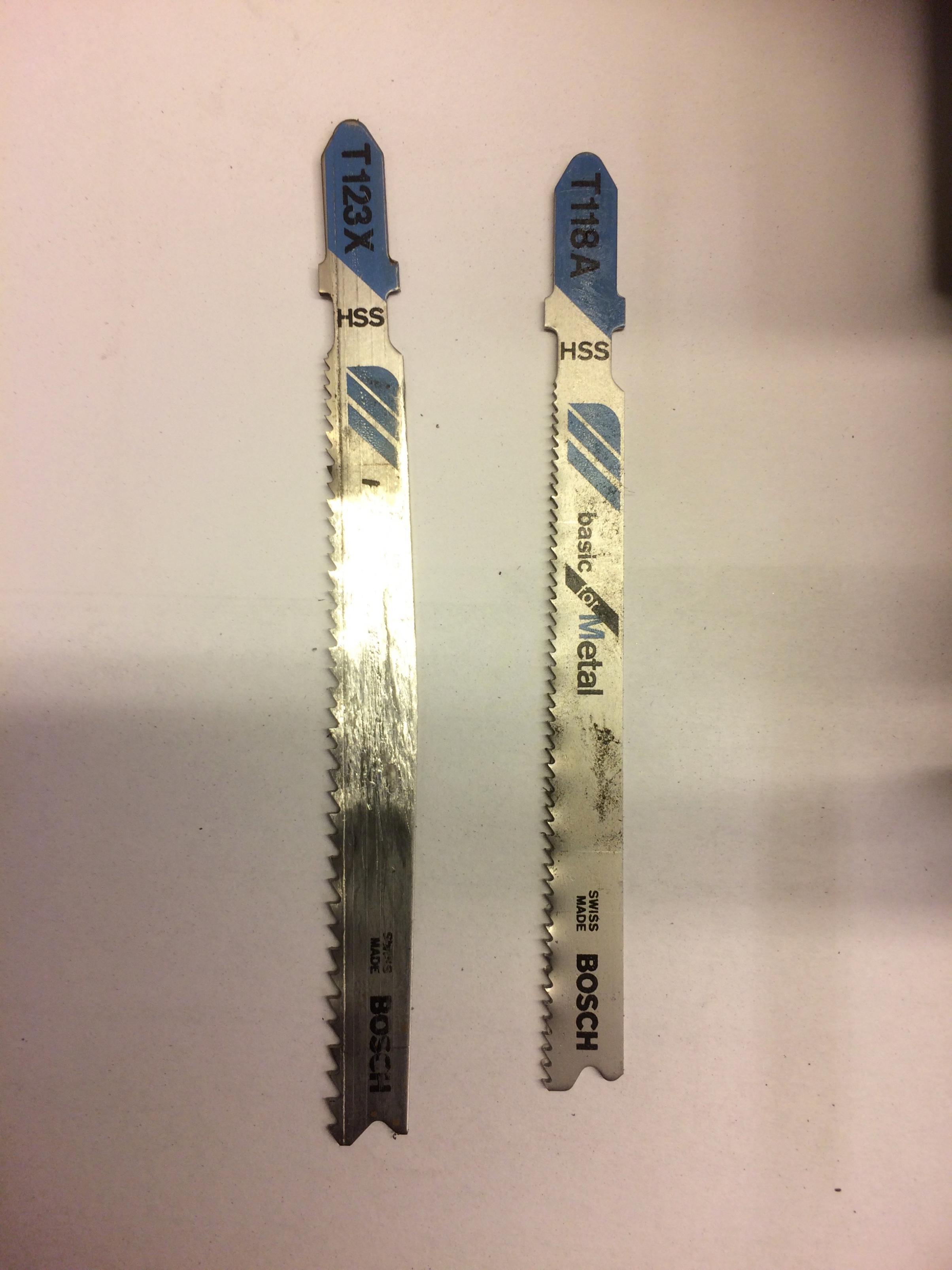

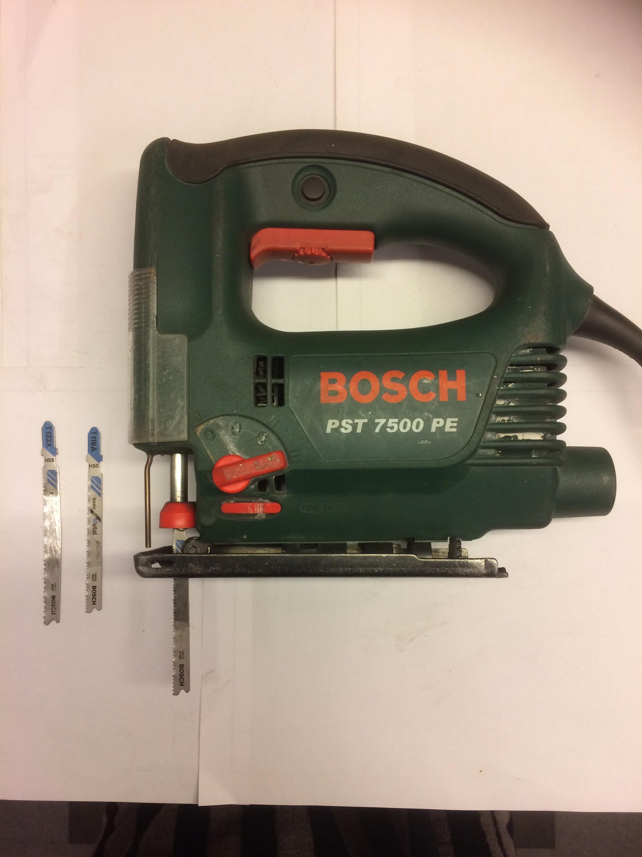

    Quote Originally Posted by NortonDommi View Post
    I forgot to ask. What method did you use to cut the plate?
    I cut all the plates with a Bosch jigsaw.
    It works surprisingly well on plates up to 2mm thickness. Cutting 3mm plate is getting a little bit slow and 4mm is both slow and eating up blades faster.
    One thing that you have to do very often is to drill 10mm holes in corners for the cutting blade. The plate must also be held firmly in place, otherwise it starts to vibrate that slows down cutting and increases the risk for breaking the blade.
    The blade to the right works for steel but not aluminium - the blade teeth get clogged. The coarse blade to the left is for aluminium. The jigsaw has adjustable speed and for aluminium you have to slow down a bit, otherwise aluminium starts to melt onto the blade making it stick in the cutting groove.

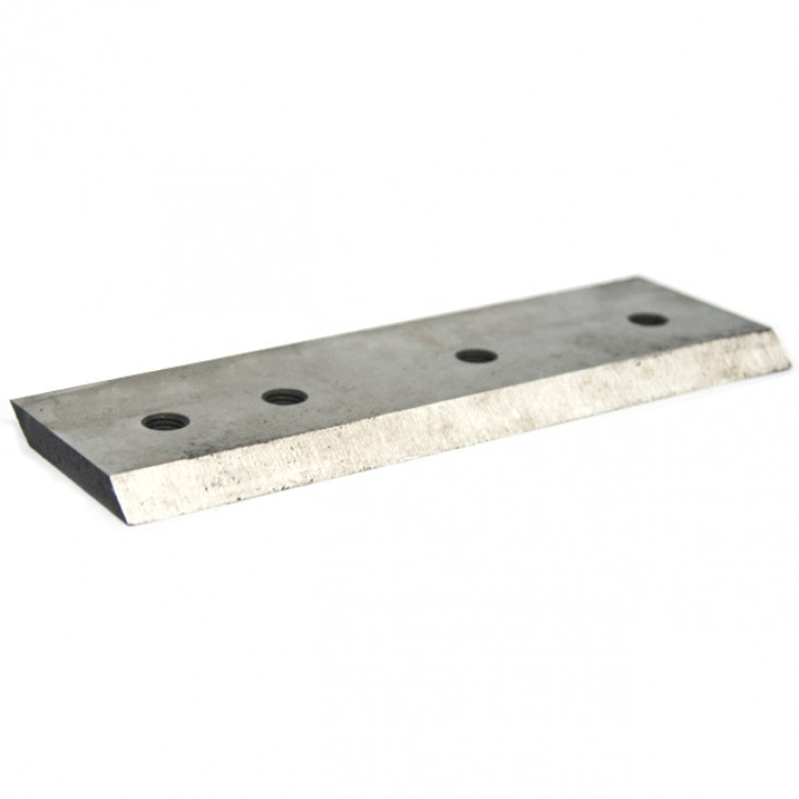

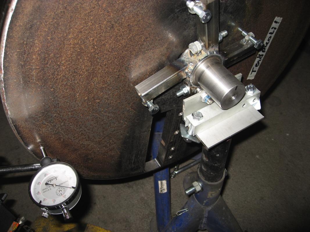

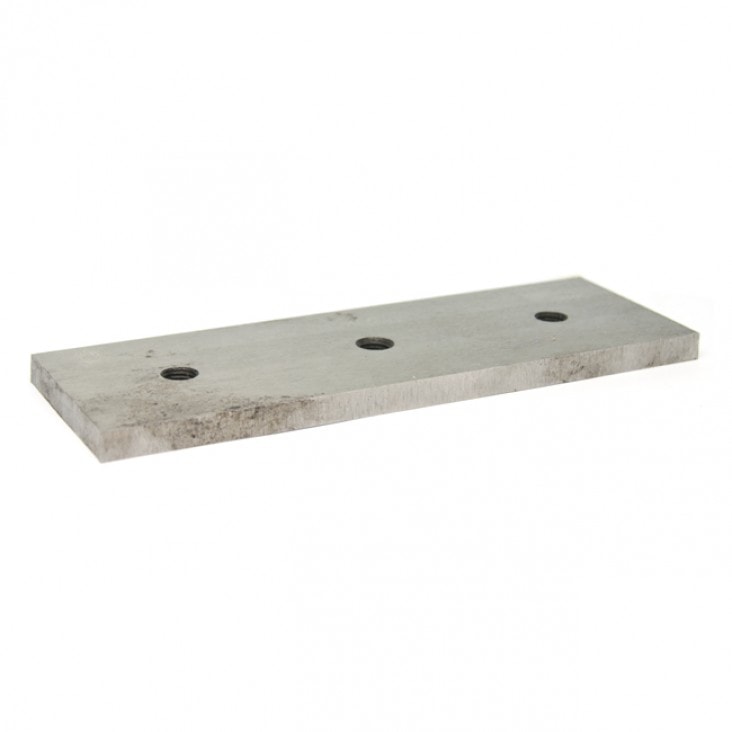

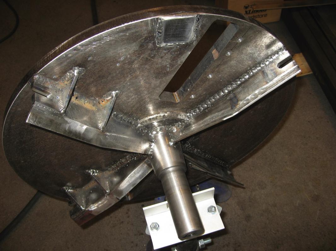

    That is a nice chipper you made there, what material is the blade made from and how did you go about balancing it?
  12. #9
    Supporting Member ruxu's Avatar
    May 2017
    Southern Finland
    24
    Thanked 149 Times in 19 Posts
    ruxu's Tools
    Thank you for your kind praise.
    I did not make the blades myself as ready made blades for a commercial chipper were available for 20€ a piece. They are for a Kellfri 100 chipper - basically the same as a Jinma chipper. I used two rotor blades and one anvil blade.
    T-Rex - my towable wood chipper-r13-wc10_001.jpg T-Rex - my towable wood chipper-r13-wc10_007.jpg
    For balancing of the rotor I made two brackets with small bearings that I fitted on my car stands. I also made a adjustable alignment tool to set the rotor correctly to the axle before welding in order to avoid rotor wobble. When the rotor was completely welded I rotated it on the balancing stand and had to add a small piece of plate to get it balanced. Actually I first welded the plate piece and then had to grind off a little bit. I thought this was easier than removing material from the opposite side by drilling shallow holes due to the size of the rotor.
    T-Rex - my towable wood chipper-img_9927.jpg T-Rex - my towable wood chipper-img_9933.jpg
    Hopefully this answers your questions.
