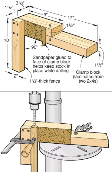

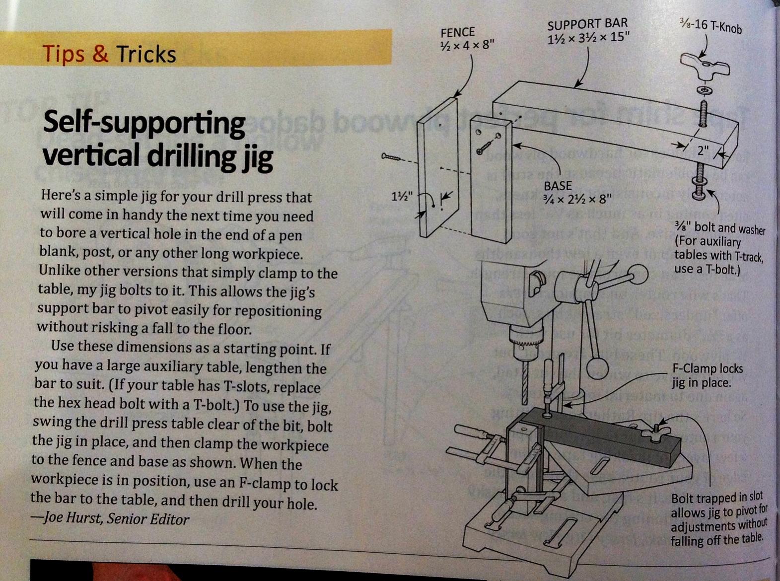

    These show making a vertical table hung over the side of the horizontal drill press table...and a vertical fence is added on the vertical table thus giving drilling access to the end of the workpiece.
    These show 90deg end drilling, but you can fix a vertical fence at an angle or make a variable angle vertical fence on the jig. If you have a benchtop drill press, then the key to this is that the drill head gets rotated on the post, past the base of the drill press so there is vertical space for clamping the long workpiece. (So the drill bit is not centered over the drill press base.)
    The second jig shown is end-drilling a short piece, but for a long piece, you'll need to move the drill press base near the edge of your cabinet or table and swing the drill head over. Then the drill press table is moved around so the drill bit is positioned correctly.
    If you have a full height drill press, then you just need to move the drill press table over so the bit is positioned over the workpiece after it is clamped to your vertical support.
    If you need compound drilling angles, then clamp one of these jigs to a tilting base like you have seen before.

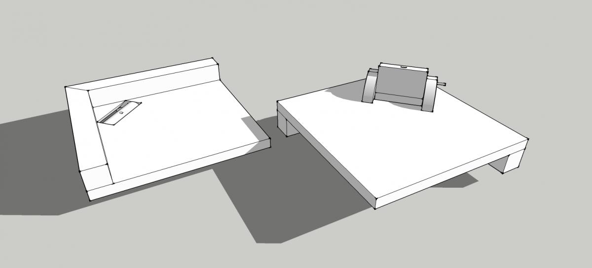

    This works for square or round stools or small tables. Sketch should give an idea, adjustable in 5 degree increments angling out. Set angle at block desired adjust drill stop for depth required. Drill and stop not shown, jig size can vary. table leg drilling jig-table-jig.jpg

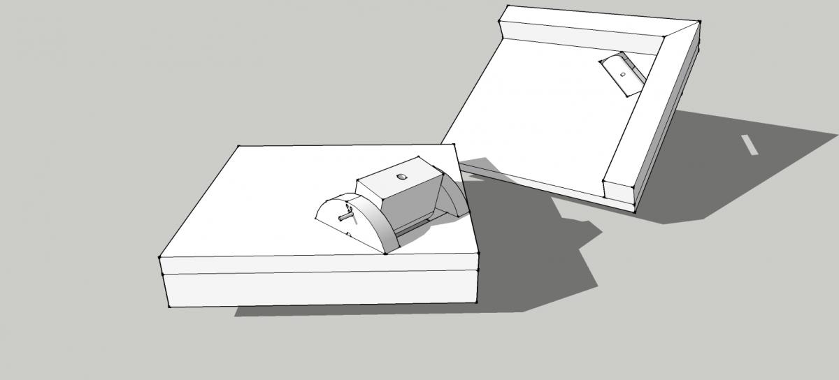

    table leg drilling jig-table-jig2.jpg Another view in case it's not clear.

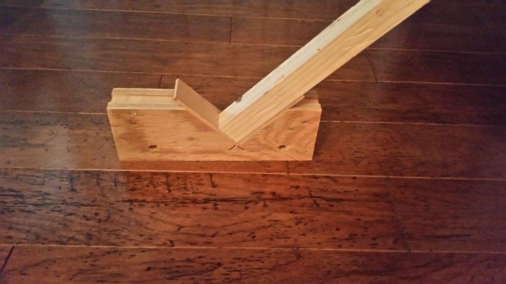

    As a follow up to my previous post, I recalled this crude jig I used to drill 45 angles in some bench legs.
    A jig repeats a task that accounts for many things, position, depth, angle, etc... You appear to be focused on the repetition of the angle. Without photos and more description is this the sort of function you have in mind?
    The assumption is that you have a wood working table on a appropriately sized drill that allows you to consistently mount and remount this jig. I find it easy to keep one drilled prototype to help when reapplying a jig after removal.
    Anyhow, hope that makes sense. Here is a photo. I used the table saw to achieve the correct angles in the jig. A accurate chop saw would also work. table leg drilling jig-20161009_101044.jpg
