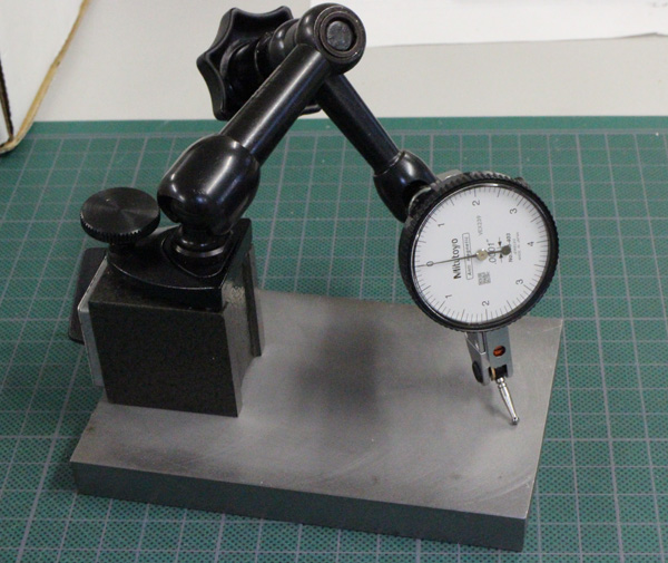

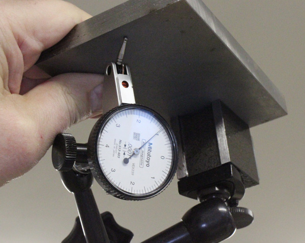

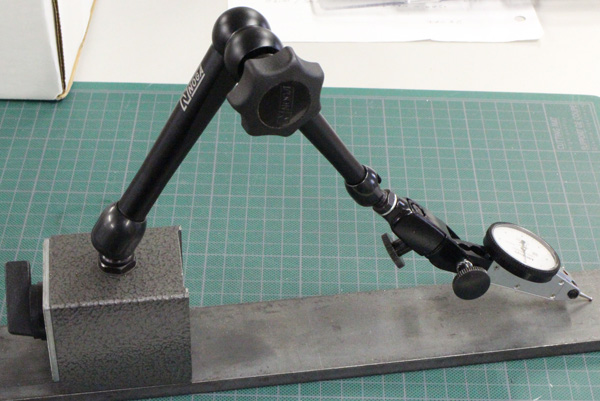

Tony has a very rigid & compact assembly to hold the indicator. But just a word of caution if you were thinking to replicate the rotating indicator action with a typical mag stand. All bets are off as gravity can act on the extended arms & joints. The dial will read differently upright than inverted & depending on the extended arm, even laterally side to side. I've attached a RK video link below.
I crudely mimicked this with my equipment & got the following on a mini mag holder vs typical mag holder. Your mileage may vary.
Noga 6"? Mini + Mitutoyo 0.0001" DTI: Level reference = 0.0000", 90-deg = 0.0005 - 0.0008", 180-deg (inverted) = .0011
Noga 12"? + Mitutoyo 0.001" DTI: Level reference= 0.000", 90-deg = .0042", 180-deg = .0055" (suspect a smidge more because it didn't return to zero & there might be some flex in my bar).

Yes, this is clear that the gravity can interfere with a measurement, with Tony's methodology, the use of the more rigid and more lighter the system is and better it is, with low quality arms especially you can have some variations between the different positions, the system you show is not a good idea for measurements on a rotation axis, for having made some tests on the horizontal milling machine those articulated arms can vary from % on a 180° horizontal position due to the construction with heavy parts.
