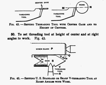

    Does anyone know a source for angle and pitch gauges so that I can grind my own thread cutting tools for use on my lathe. Enquiries to some of the tap and die suppliers have resulted in ludicrous cost quotations eg a gauge for 1/4 NPT £527 + vat !!!! est result would be a set of drawings which i could have accurately drawn up into etching transfers then i can make my own
    Anyone got any thoughts...... I'm particularly after acme threads i know the angle is 29 degrees but pitch is the problem
    If it's what you have on the second picture, then it's a very usual tool, you can found it by every sellers of material for the lathe.
    The first one is a very fine tool for extreme precision, but I don't know if you can found it on the market, normally it is selfmade.
