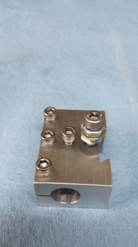

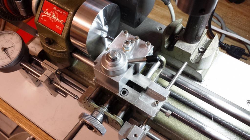

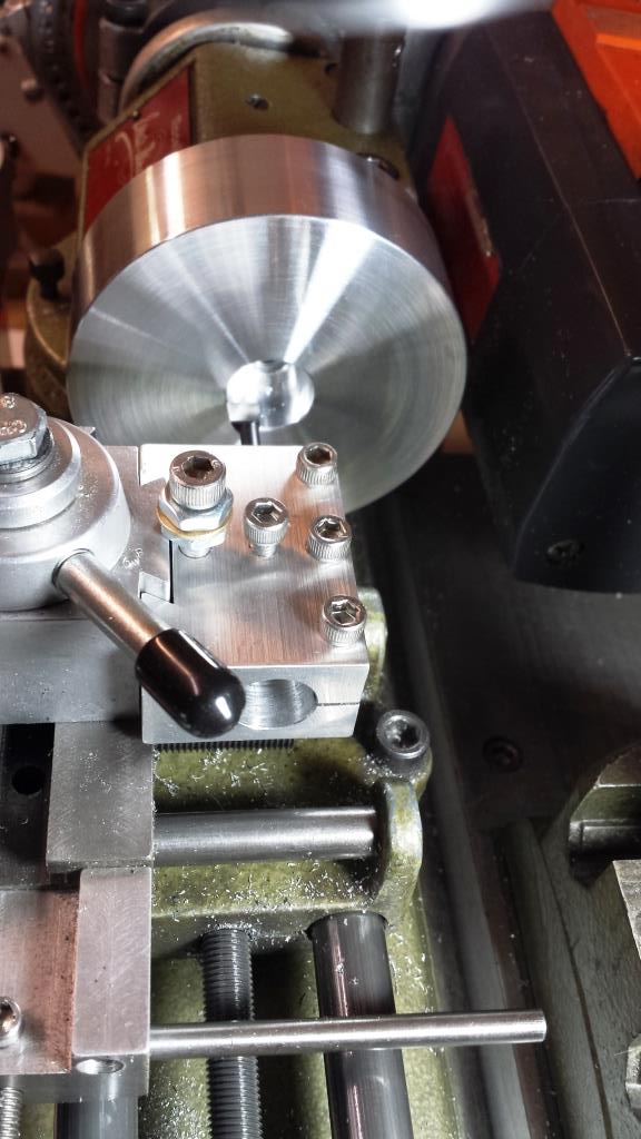

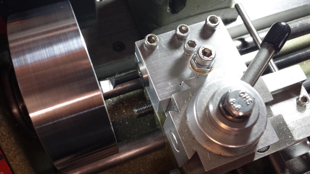

    Unimat Lathe Boring Bar Holder
    Unimat lathe boring bar holder was machined from 6061-T6 aluminum and designed to hold 0.5” diameter boring bars. The T6 temper is a very strong and a good choice for tooling for the 3” swing lathe. This particular size holder allows using more tooling from my other lathes. The various clamping screws are 8-32 stainless steel socket head screws. Also the center clamping screw allows aligning boring bars made with flats for setting their alignment.

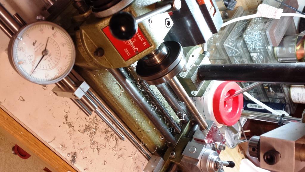

    Thank you for the responding to this posting. I enjoy using the 3" swing Unimat for some of my small, precision work. Below are some additional photos about making the boring bar holder.
    Machining the boring bar through hole to be parallel with the lathe axis.

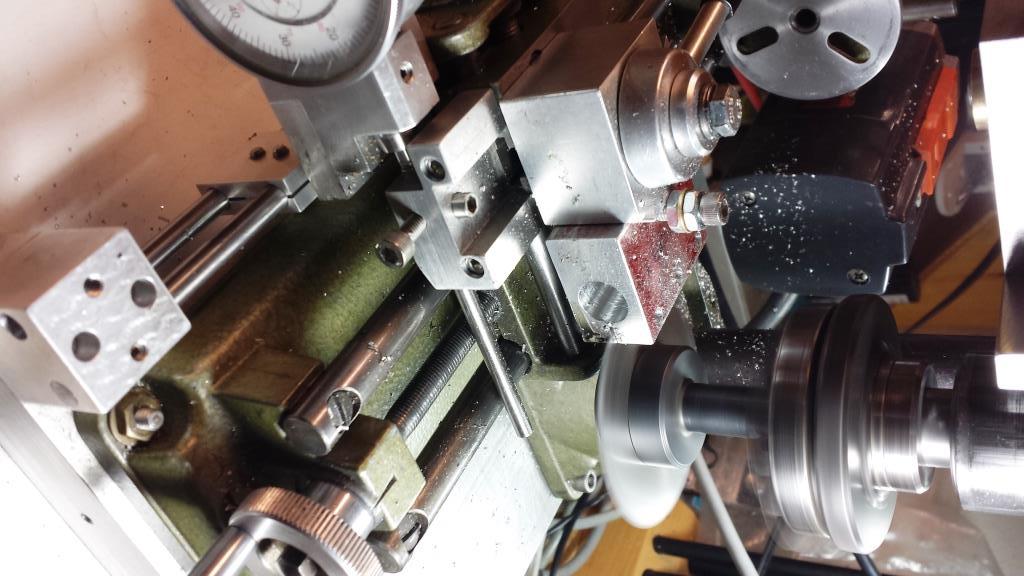

    I used the Unimat milling head to cut the boring bar compression slot using a slotting saw blade. The Unimat face plate in the background of the photo is used as a reference to set the parts at 90 degrees before starting the slotting cut.
