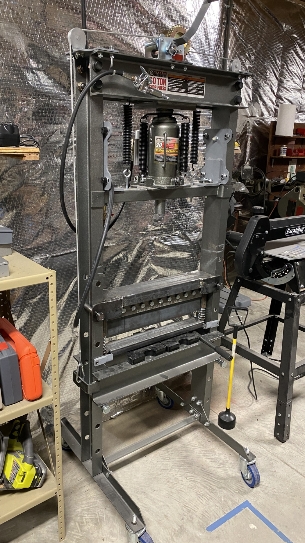

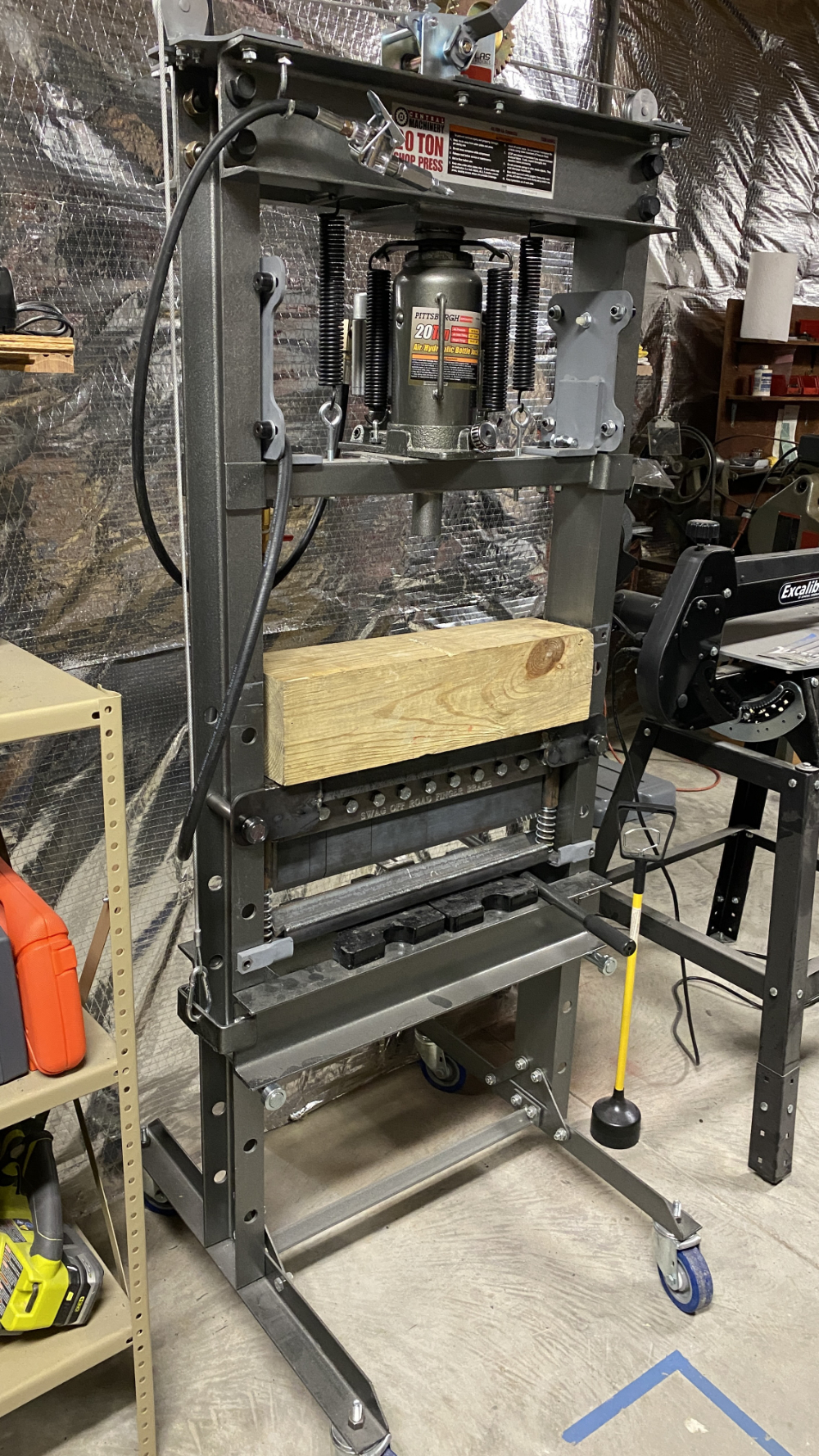

    Here the 2nd table is installed in the press above the lowered Swag brake. Two of the height adjustment frame hole levels are still available above the brake. The 6x6 block of wood acts as a spacer, and adds stiffness if needed. The 18 lb. table can be removed and the brake raised for use in about 5 minutes time. The brake bolts to the frame in its raised position, which takes about 3 out of the 5 minutes.
