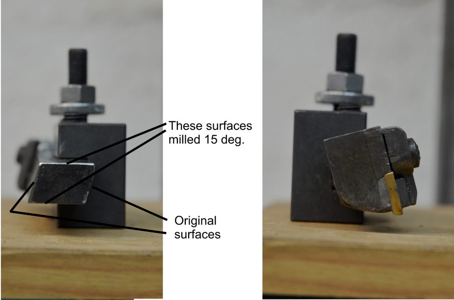

I made an indexable carbide tip version by machining the sides of the tool holder to 15 deg. There is a full description here
https://www.homemadetools.net/forum/...9276#post88966
Attachment 42622 Click image for full size.
The shear tool is extremely useful for obtaining very close tolerance finishes, down to exactly on size.
