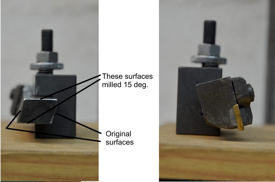

    Quote Originally Posted by NortonDommi View Post
    I have a couple of those Eccentric Engineering tangential tools and find they do an excellent job as a shear tool when used in reverse i.e. with a RH tool instead of running towards the headstock cut towards the tailstock and vice versa for a LH tool.
    The bit could also be turned through 90 degrees to achieve the same result, I have been means to make a dedicated tool though.
    I made an indexable carbide tip version by machining the sides of the tool holder to 15 deg. There is a full description here
    Shear tools for lathe work.
