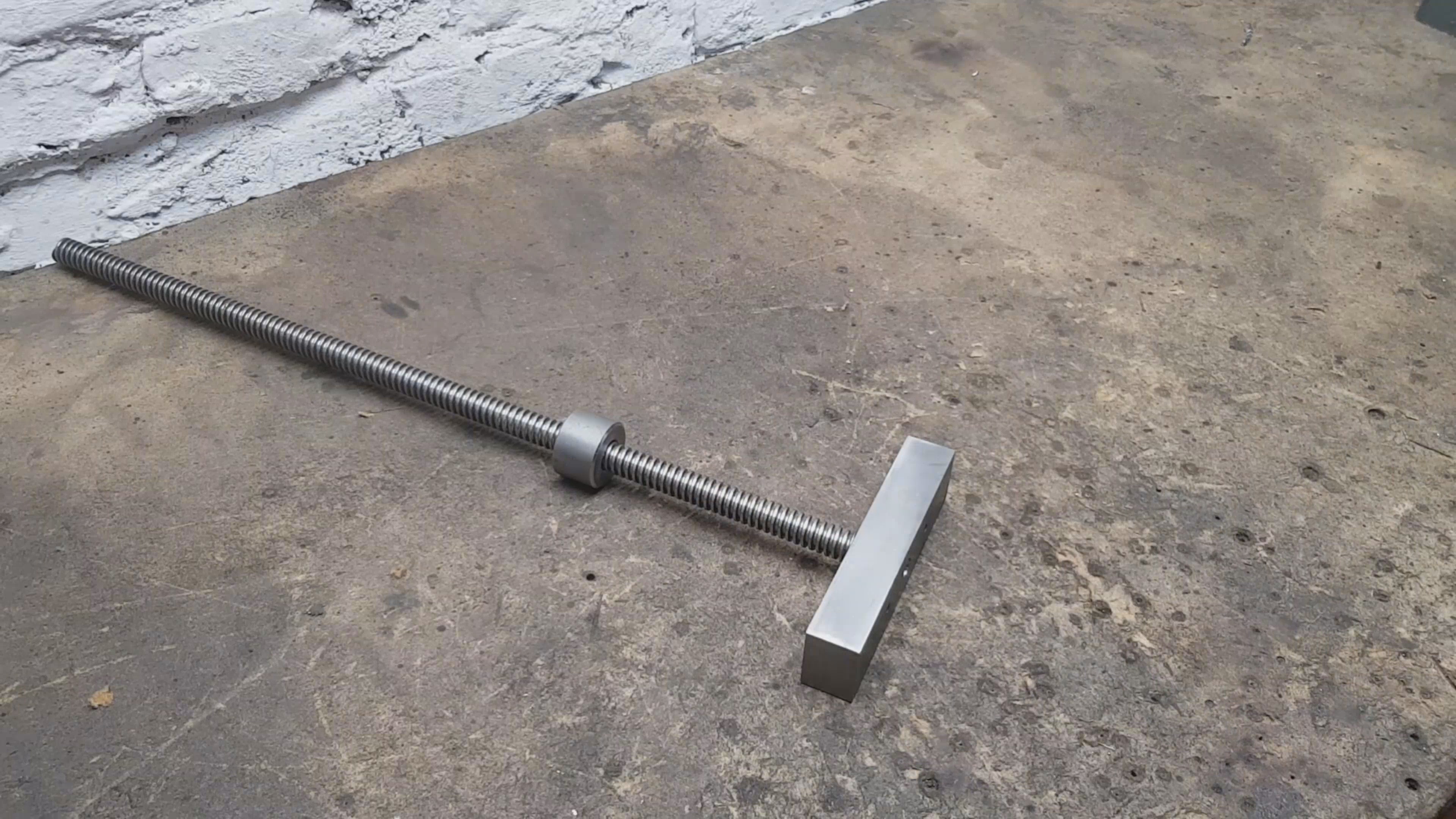

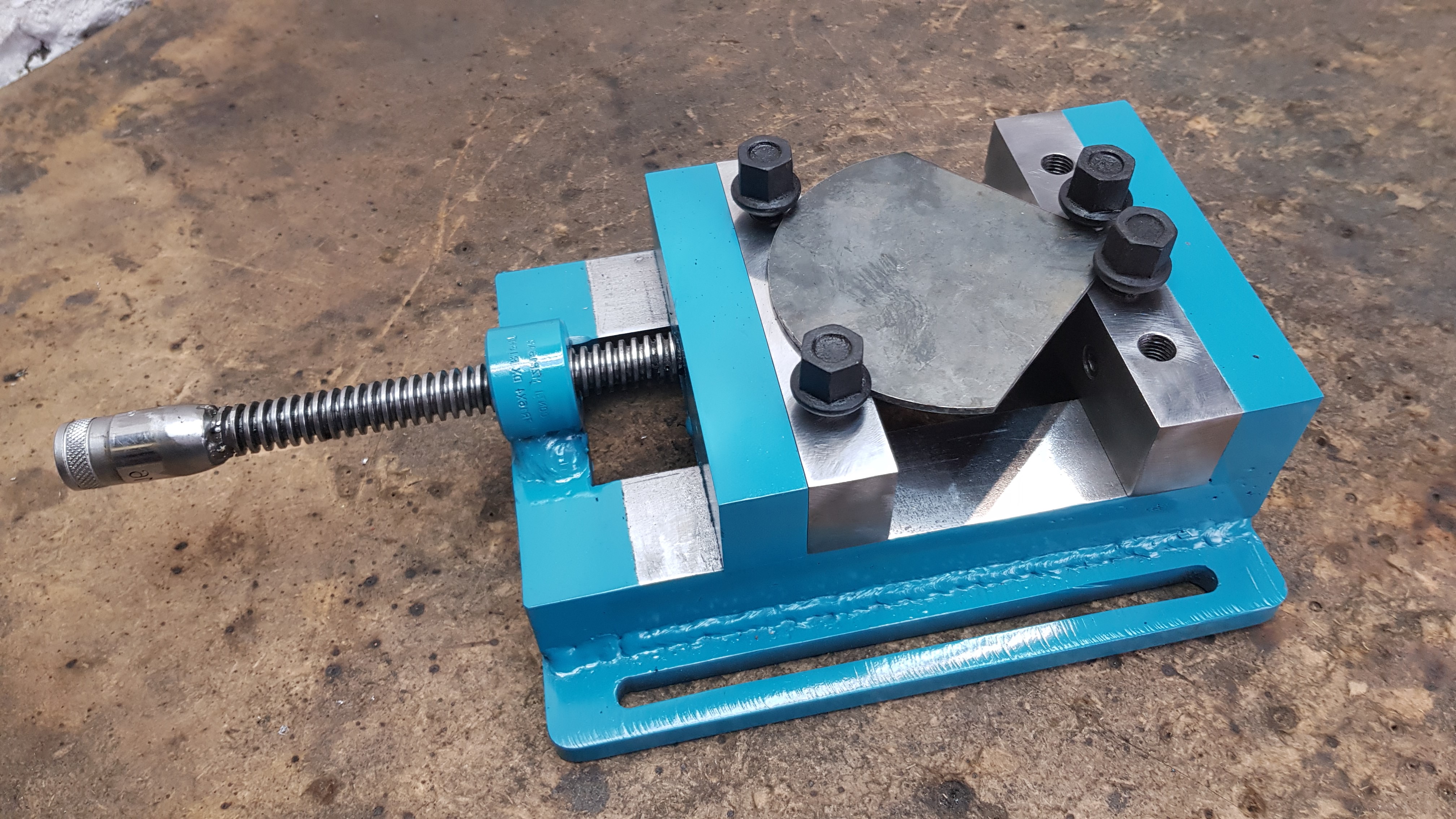

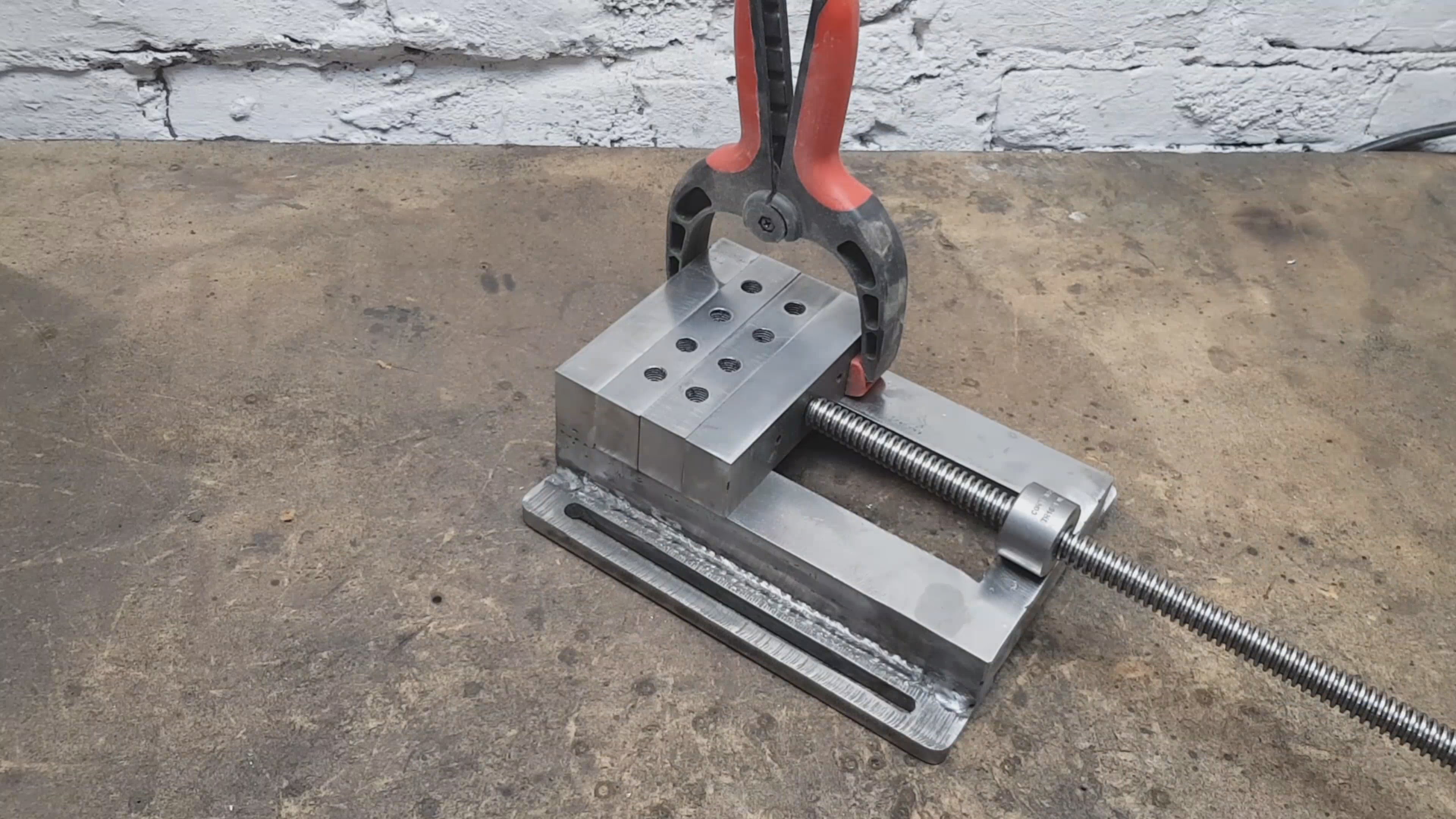

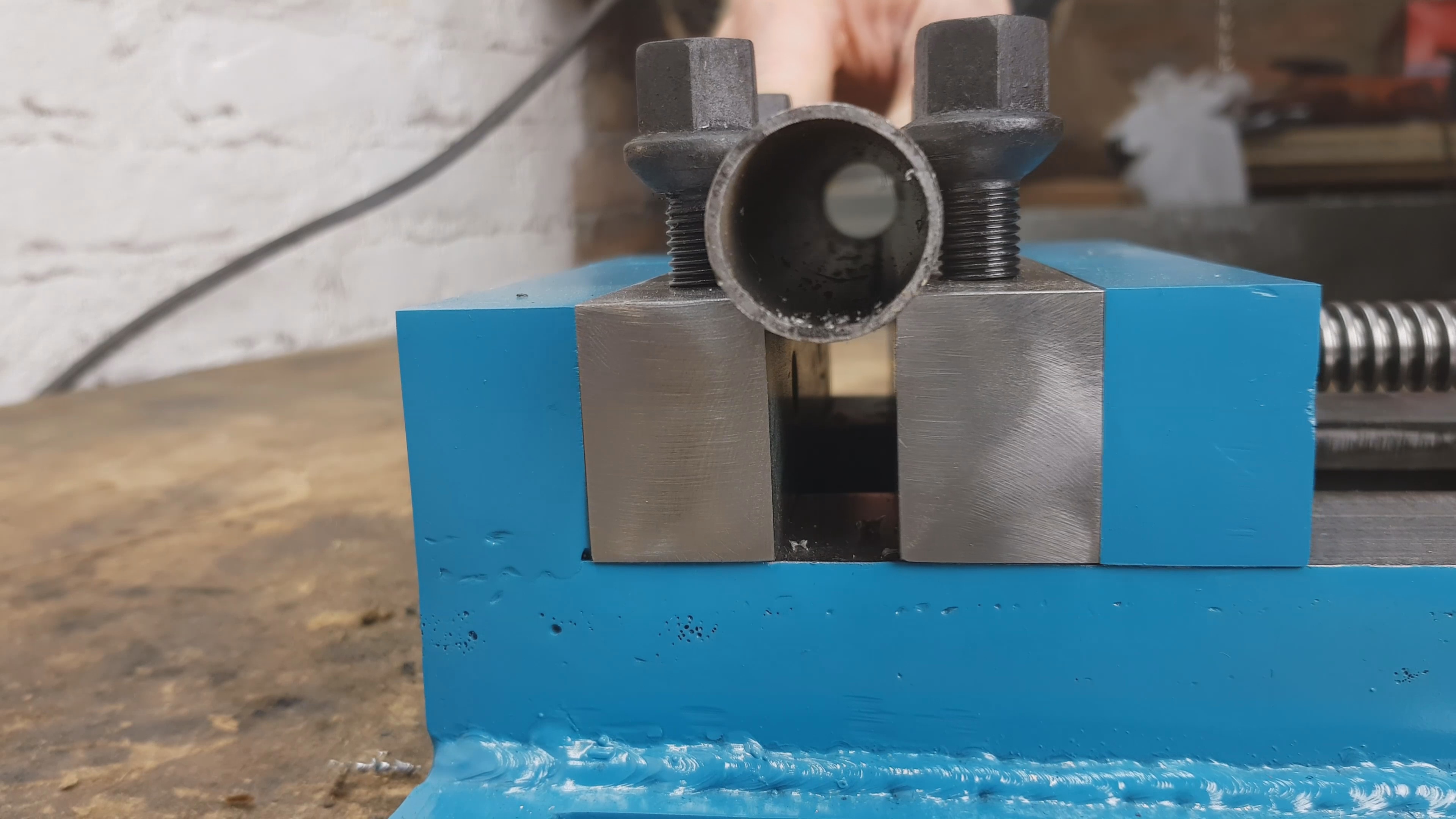

I missed a vice in which I could mount an irregularly shaped object. I got the idea that I would make a vice with screws screwed into the jaws of the vice. Thanks to this, I will be able to catch the object regardless of its shape.
