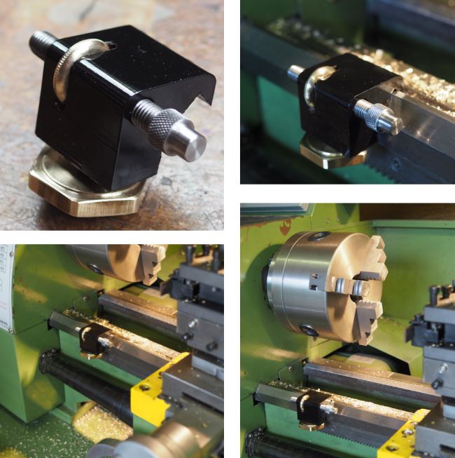

    Although I'm not a big fan of lathe saddle stops I've got to the point where I thought it might be a good idea for certain repeat tasks and hence I've set out and made this for the Warco WM240B lathe.
    The result is a cast iron block that hangs over the saddle and locks with a nut. The stop itself then is a threaded bar that has a simple locking knurled wheel. All quite simple to make and more details are here: Warco Saddle Stop

    Hi Nigel:
    Excellent design and finish of the components. I only have a suggestion for you. Any and all stops (lathe saddle, milling vise, etc.) are better provided with a round or convex contact area. The idea being that is easy for chips and any other debris, to stick to a flat surface messing up the accuracy of the location. Less so to the said end thus shaped.
    Cheers
    Jorge

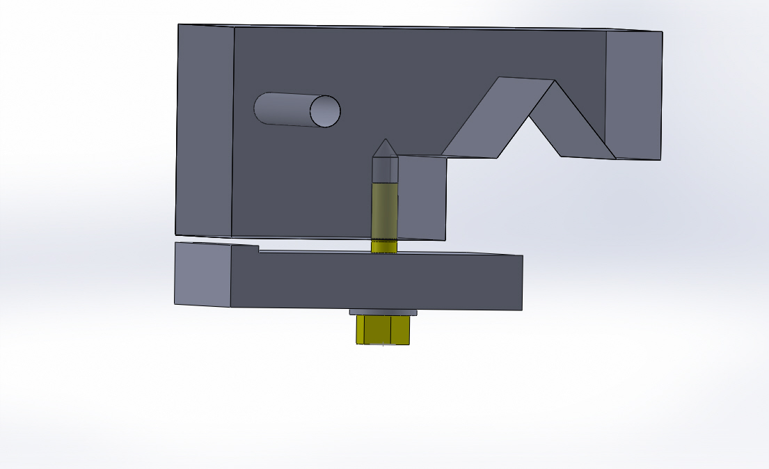

    There have been several stops posted that I have taken notice of, so by chance you are the one that I will ask sense I finally have enough motivation to post a question about them. I do not believe that I have yet seen a post that clearly shows how the stop clamps to the ways of the lathe. Perhaps a picture of the clamp side will be answer enough. Does the clamp or lock nut simply register on the underside of the ways? To be honest I have not owned my lathe long enough to have thought to look at the underside of the ways to see how much of a ledge is there. My lathe is a 12x32 enco of 1990 vintage. Just getting started with it. Finding out that "good condition" can have a more varied meaning than I would have thought. Oh well live and learn. Thanks in advance.

    Most of the stop blocks I have used or encountered clamped like I have shown in the drawing picture
    The basic block is milled to fit the way the clamp has a raised fulcrum to connect to the block held in place by a simple bolt from underneath
    Some blocks will have the thread in the clamp and the bolt passing from the top .
    the clamp will extend as far as required under the bottom of the way. usually depending on the size of the lathe it could be a little as .250" or as much as an inch or more.

    I took the opportunity to stop by my shop while walking the dog to night. The ledge under the way on the lathe is 1/4 inch. Adequate I should think. But this brings up another question, the total depth of the ledge is actually 11/16. The difference is accounted for by the presence of a gear rack. Now I have yet to find an answer for the existence of 2 means of powering the carnage up and down the ways, lead screw and gear rack. Lead screw would be more accurate I am thinking. Could the gear rack be for broaching? Take more stress? It has much more lash than the screw. Is this some sort of chineesium lost in translation? I have down loaded the owners manual for the enco and the apparent grizzly clone but found nothing there. Any thoughts would be appreciated. Thanks
