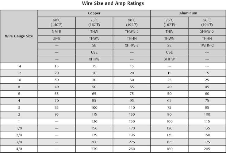

    Here is a wire chart for in house wiring:
    Warning: Power Cables Are NOT The Same! (4K)-ampacity.jpg
    Seems simple enough, copper versus aluminum, temp rating of shields. This chart though is not the maximum rating of the wire to when it becomes a fuse, these ratings are the rated usage full time 24/7/365.

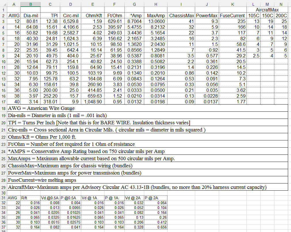

    What are the fail ratings? See this chart:
    Warning: Power Cables Are NOT The Same! (4K)-wireguagesizeresistancecurrent.jpg
    Lots of things in the chart, but look at the column for FuseCurrent. That 14 gauge wall wire rated at 15A has a 166A FuseCurrent, so your breaker should trip WAY before the wire gets in trouble. Even the smallest wire he had (0.75 sq mm) is about 18AWG and that has a fuse current of 82 amps.
    That chart has lots of other columns and what you do with the other columns requires more experience and knowledge than can be explained here.

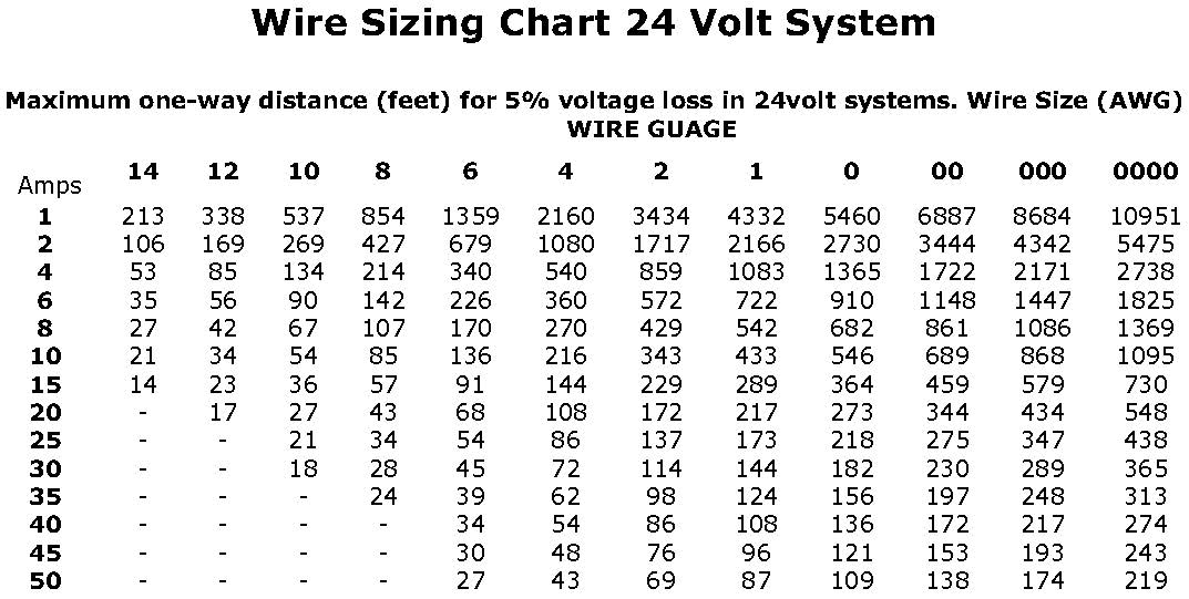

    Here is another chart I used when designing equipment on 24v vehicles, in particular I was concerned about loss of voltage if a module was some distance away from the power source (once you plug in resistances, spreadsheets let you blow out a bunch of numbers):
    Warning: Power Cables Are NOT The Same! (4K)-wire-sizing-chart-24-volt-system.jpg
    Cords are rated generally by the conductor size and sometimes they care about how the wires are packed in the cord. It is unlikely that this guy's smallest cord would have failed, even in the situations he showed, but it is always better to have more copper than not, so go with what is bigger...
Name:	Wire Sizing Chart 24 Volt System.jpg
    Great info. But isn't that 24v chart voltage independent? Like it could be <insert voltage here> with 5% drop.
    Yes, you are correct, but it was from a particular project and sometimes you have to label charts for the non-engineers - if you know what I mean...
