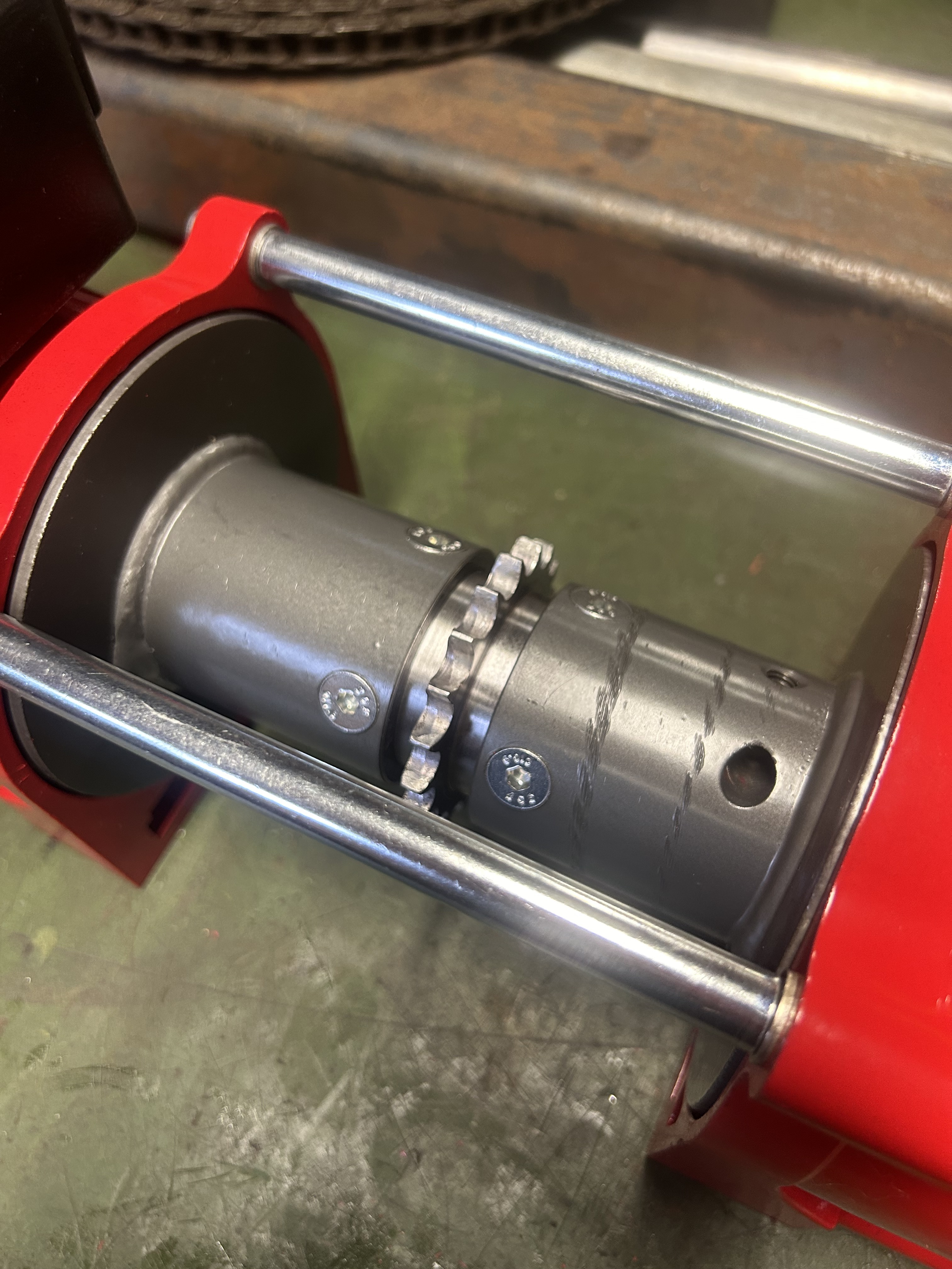

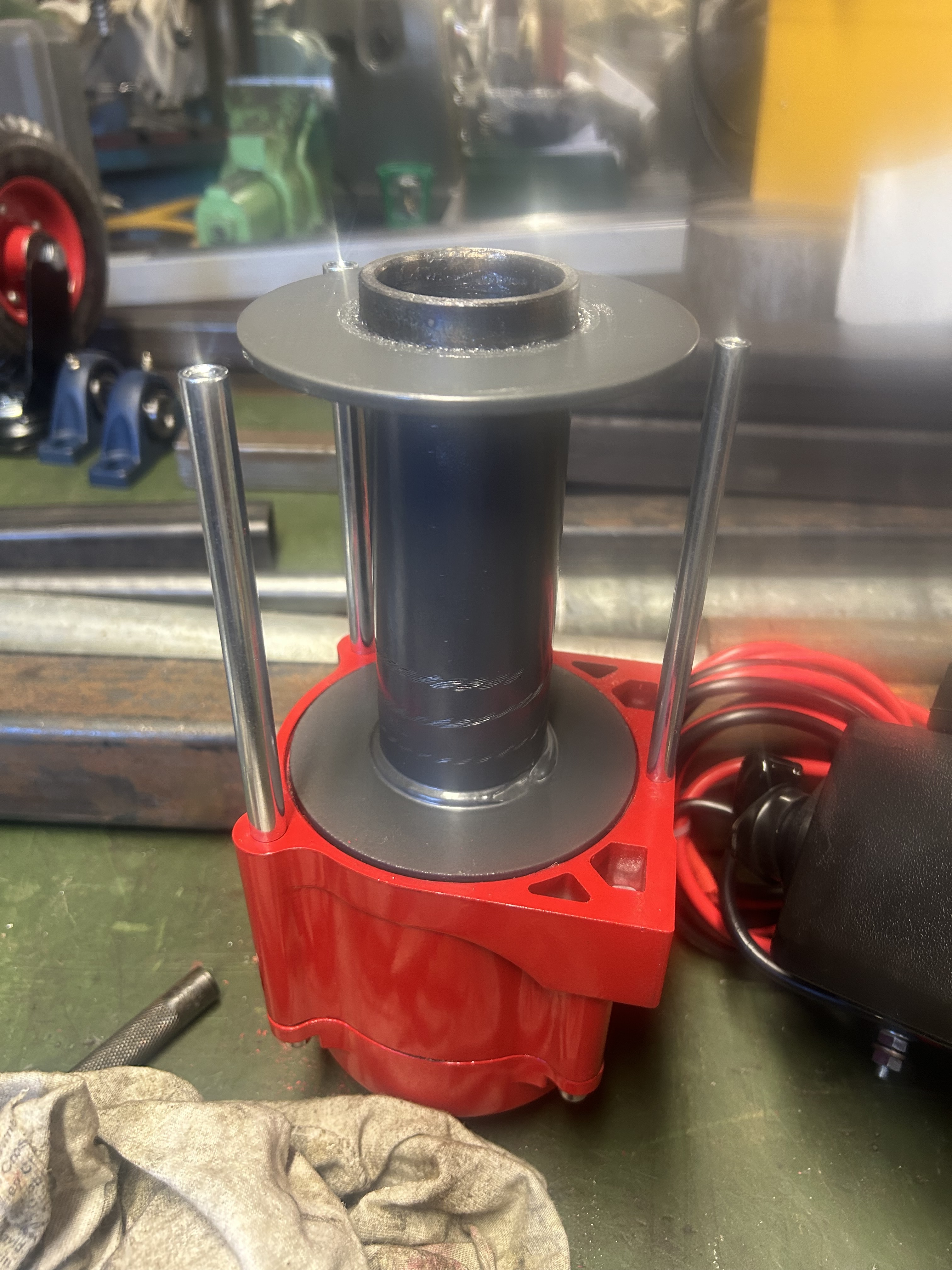

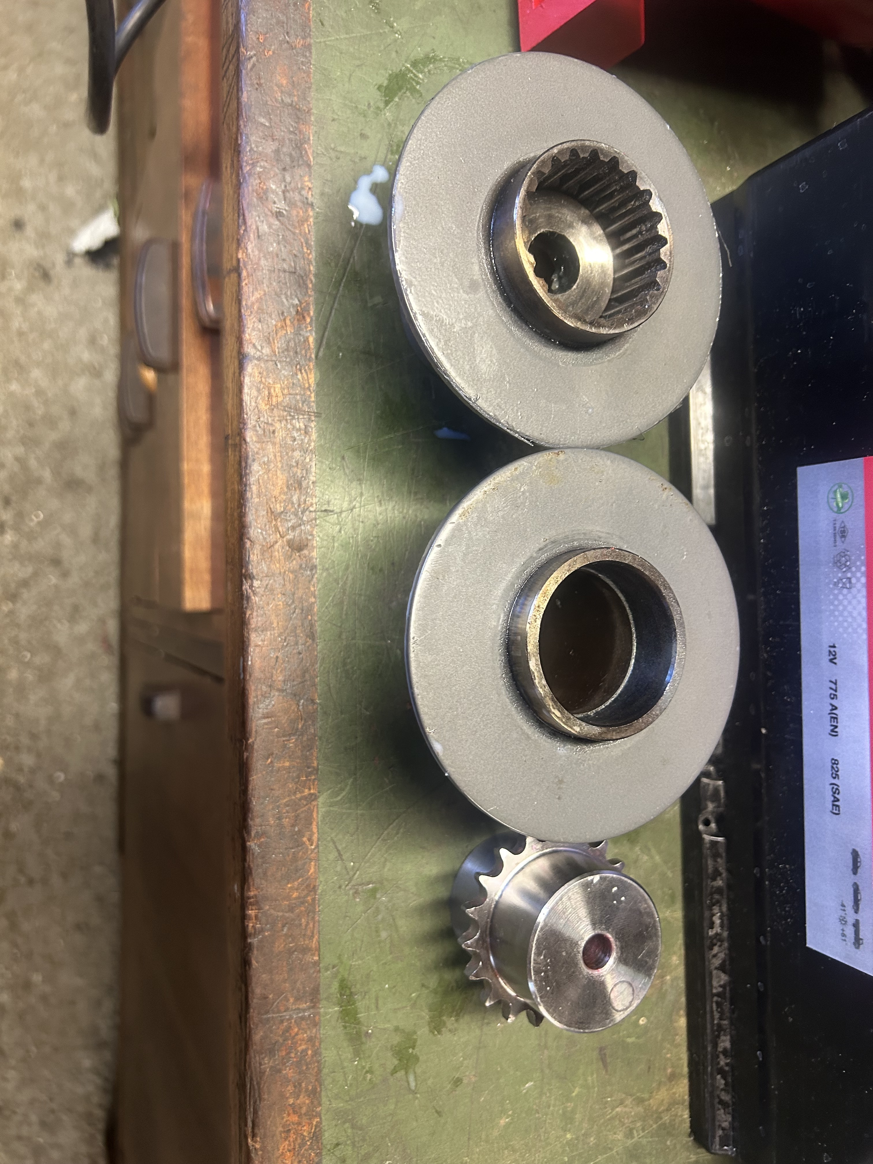

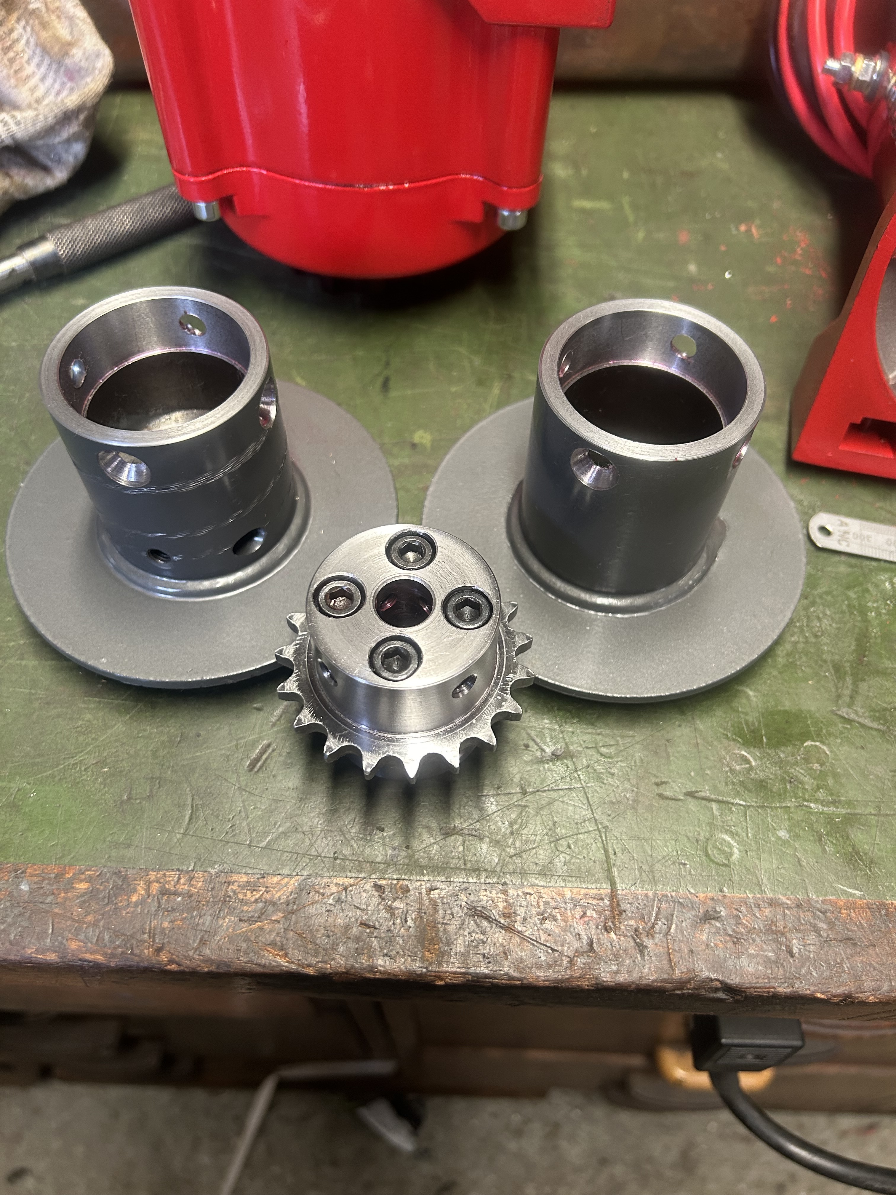

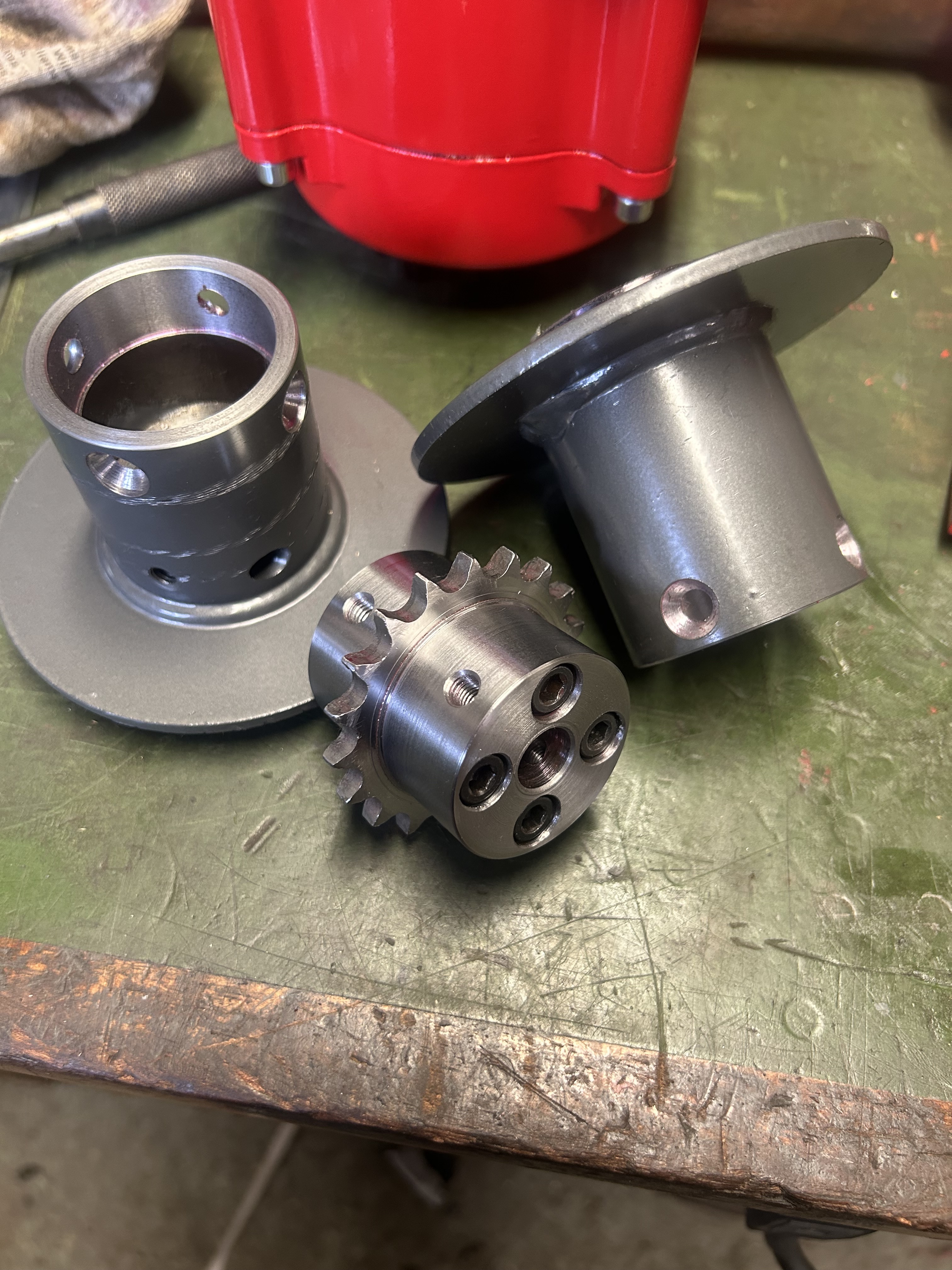

    The first issue was how to connect the smaller drive sprocket to the cable spool on the winch as the sprocket was a smaller diameter than the spool. So decided to cut the spool in half and mount a second boss to the sprocket and rejoin the two half’s of the spool back together on either side of the bosses.

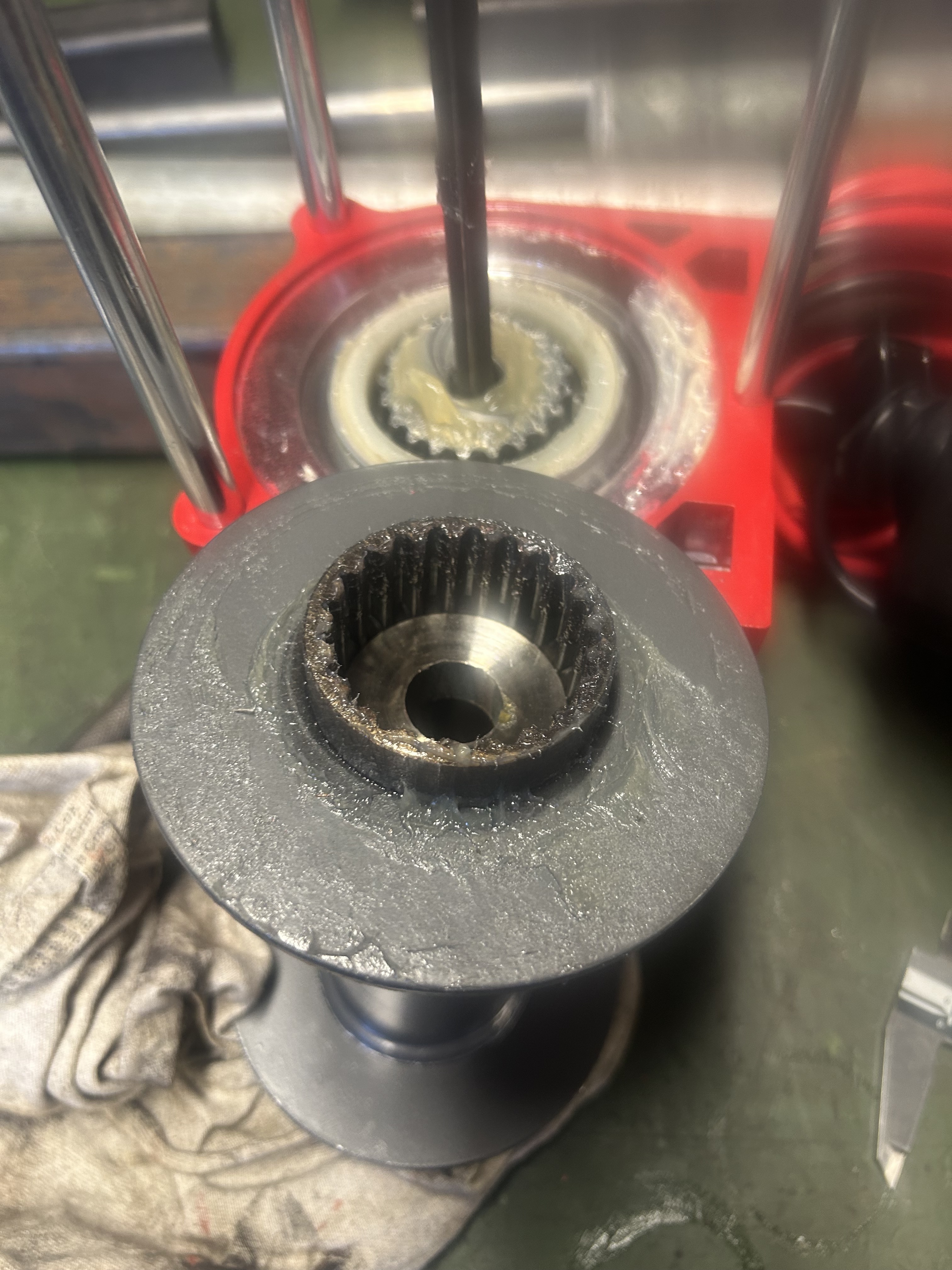

    The winch was taken apart and in my mind this was going to go one of two ways as this was a new perfectly working winch about to be butchered. So nervously the spool was setup in the lathe and parted off, support at the tailstock end with a pressure pad to prevent the spool from coming out of the 3 jaw chuck. Success the two halves were then machined to length and bored.
    The sprocket was then modified and and both the spool halves and the sprocket drilled and bolted back together and refitted to the winch.
    The photos will hopefully clarify modification.

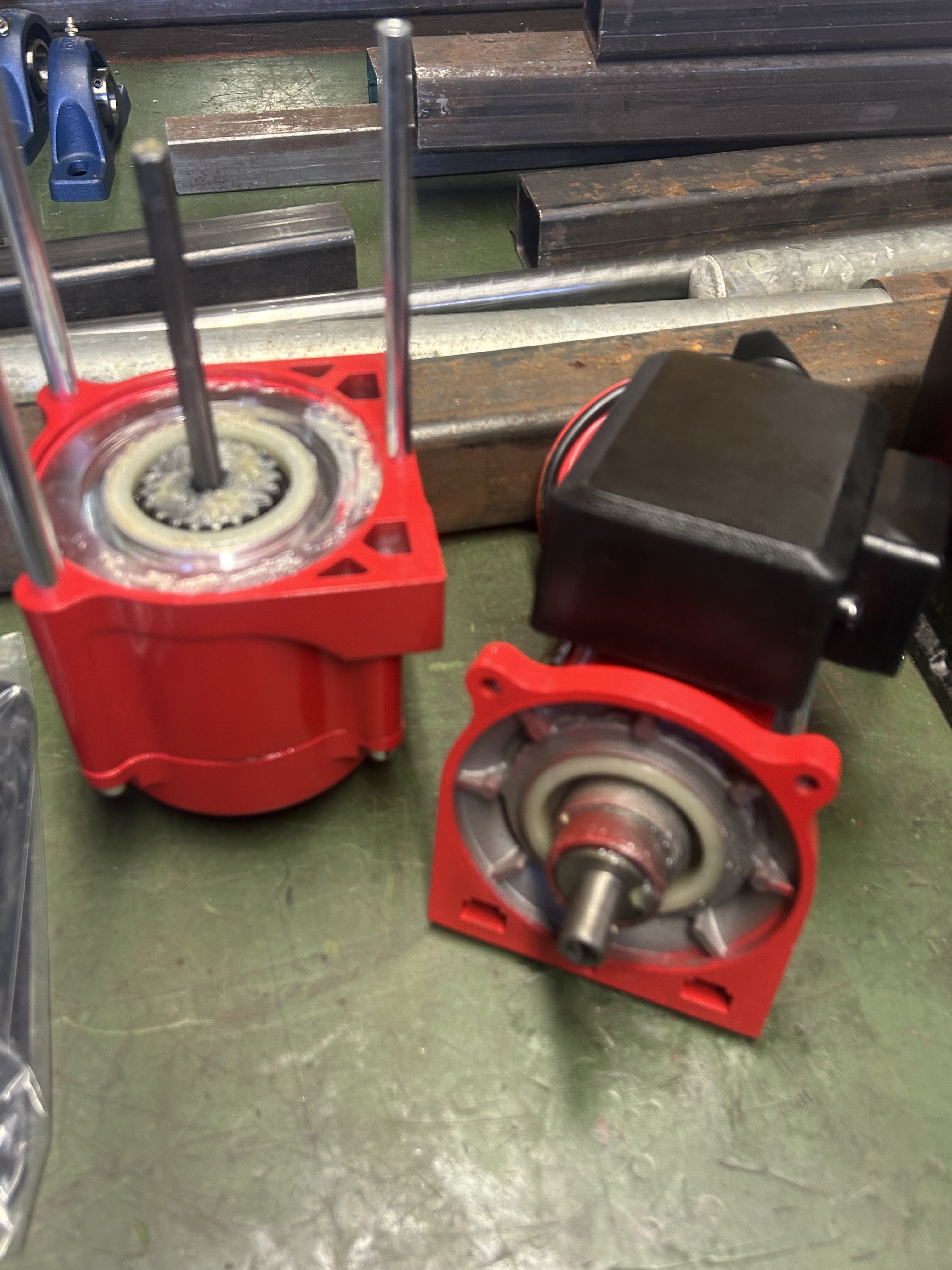

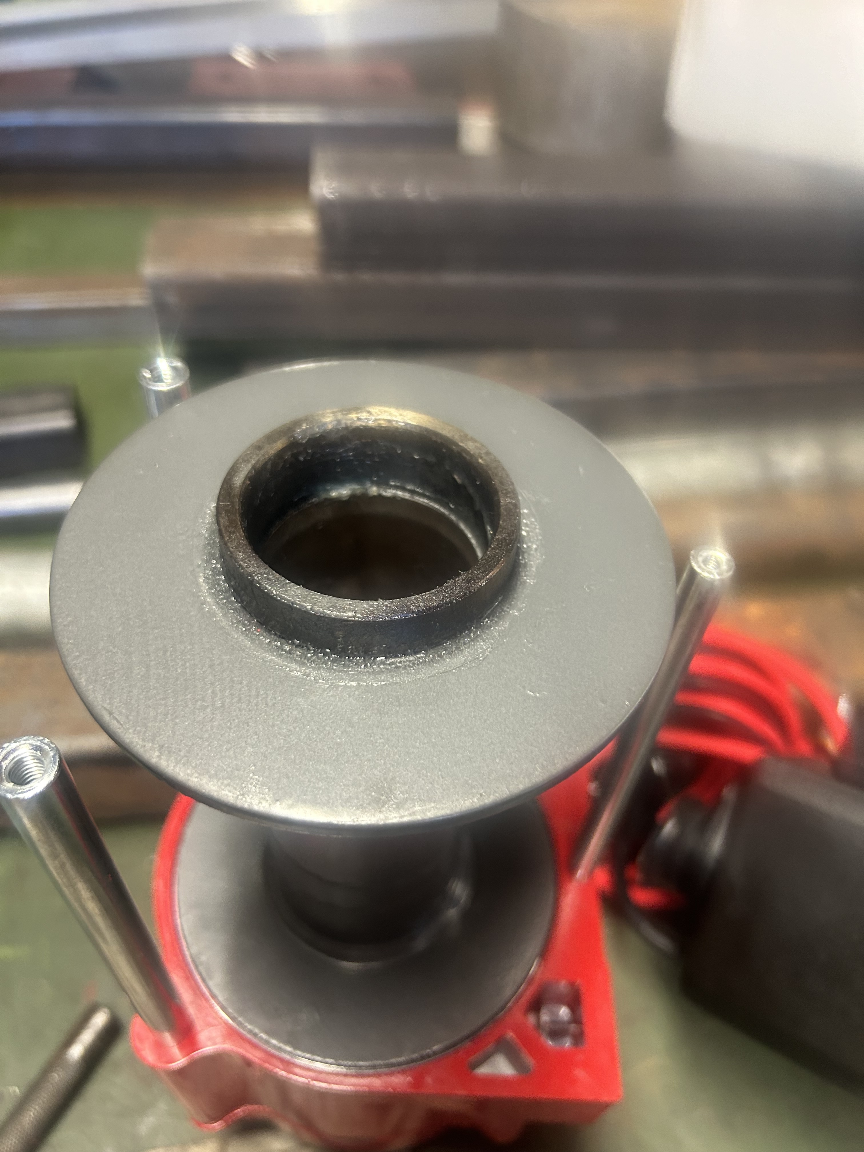

    Winch conversion from wire to chain sprocket-img_8354.jpeg Spool with wire removed.
    Winch conversion from wire to chain sprocket-img_8358.jpegWinch motor and clutch assemblies.

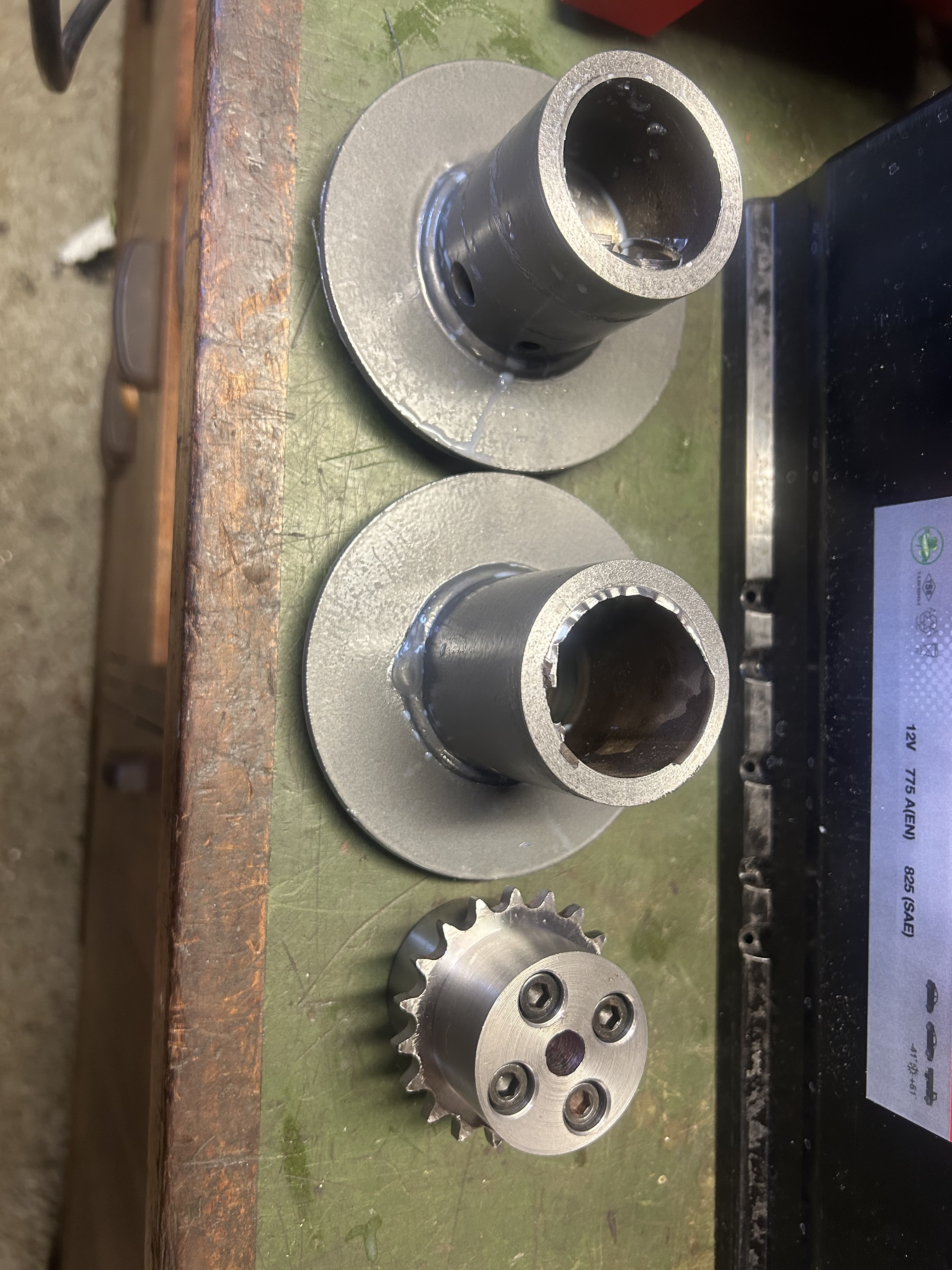

    Winch conversion from wire to chain sprocket-img_8356.jpeg Winch conversion from wire to chain sprocket-img_8357.jpeg Parted off and part assembled sprocket ready for finishing.
    Winch conversion from wire to chain sprocket-img_8361.jpeg Winch conversion from wire to chain sprocket-img_8360.jpeg Modified sprocket and bored spool halves
    Winch conversion from wire to chain sprocket-img_8403.jpeg Winch back together

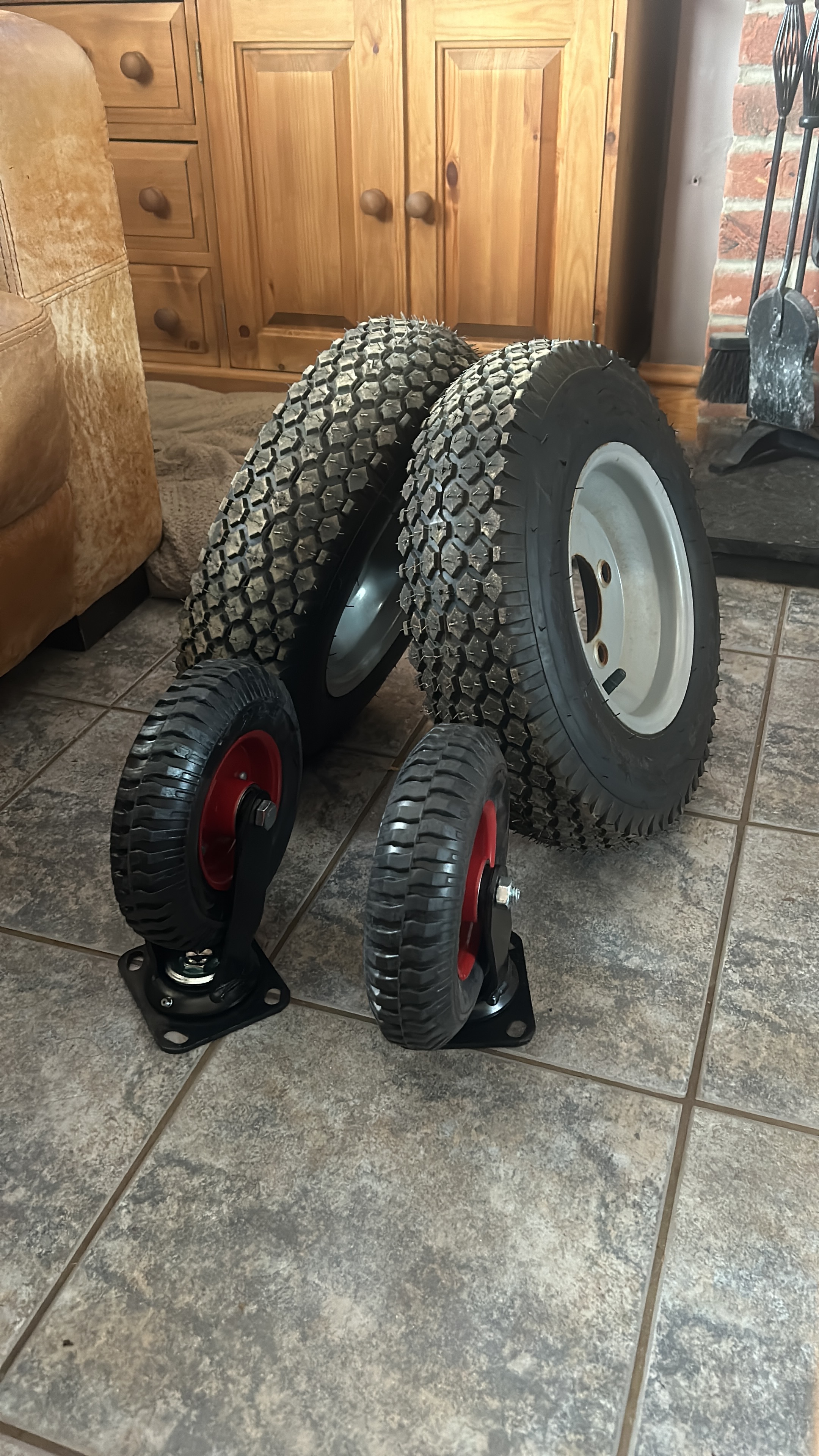

    Winch conversion from wire to chain sprocket-8e66f77f-5096-458b-933f-7da53d0439b0.jpeg New drive wheels and trailing support wheels. ( no expense spared on this project )

    Doing it this way instead of simply attaching the sprocket to the output shaft of the gearbox retains the winch clutch and allows the cart to be powered or freewheeled as needed. Clever idea, and nice work.
    Thank you for the comment. I didn’t want to create too much damage to the winch just in case the trailer mover isn’t a success. (I am building it a bit on the fly). If not successful I can put the winch back to its original intended purpose. Simply make a spacer piece and bolt the two halves together and reattach the wire rope.

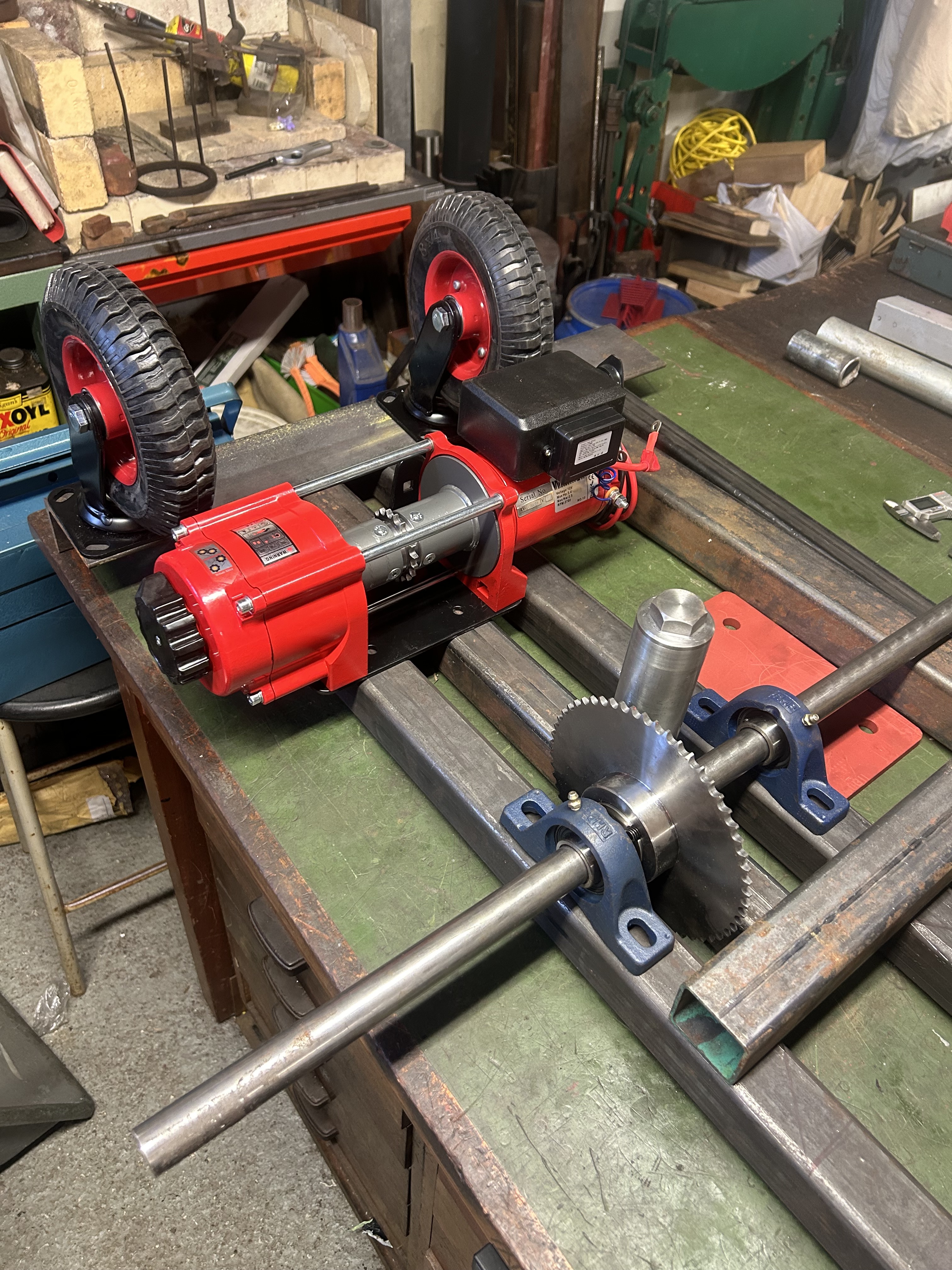

    The photo below shows the mockup of the chassis. I have tried to make it as simple as possible be also be able to take the weight of the trailer.

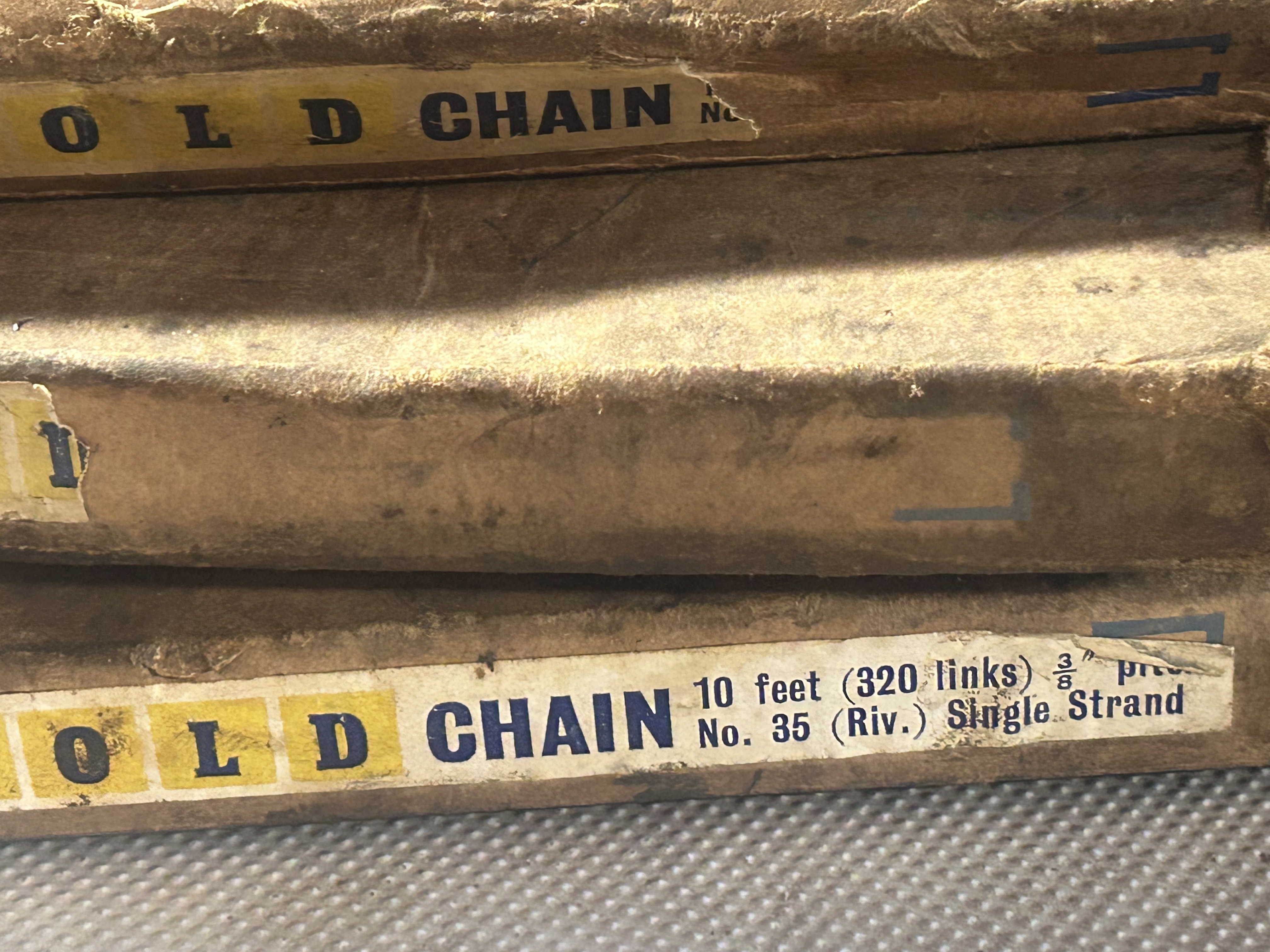

    Every day is a school day. I really enjoy building projects like this, researching how others have overcome the same problems, what is commercially available and developing designing and improving something to try and meet my needs.
    However doing this just highlights the void’s in my engineering knowledge. Like most projects starting from scratch can be quite daunting. Especially when it is your money you are spending and that little nagging thought in the back of your head (I hope I have got this right) Already on this project there has been mistakes that I have had to overcome. (Great feeling when you do solve them) but I thought I would share a mistake I did make which could have been expensive.
    Awhile back I purchased a load of new old stock chain from an auction (only about 20 years ago, because one day that will come in handy for a project) There was quite a bit of chain and eight boxes of 3/8 Renold chain. (Useful size I must of thought, 20 years ago)
    As previously mentioned I have purchased several new items for this project, one being two 3/8 pitch chain sprockets. When they arrived they looked right, correct part number etched on them, correct number of teeth etc. Now normally I would have tried the chain on the sprockets to make sure they fitted. Oh no! not this time, I will be clever and leave the chain in the sealed box so the chain doesn’t get dirty etc
    Machined the sprocket to fit winch and put all back together, ready to go. Had a bit of a mockup and then the sealed box got the better of me and I had to try the chain on the sprockets.
    photo below shows the dimensions of the pitch on the boxes
    Winch conversion from wire to chain sprocket-img_8405.jpeg Clearly states 3/8 pitch
    You guessed it the chain wouldn’t fit, so opened another sealed box same result. Oh dear either I have purchased some dodgy chain from auction and that’s why I got it cheap or the sprockets had to be incorrect.
    On researching chain I didn’t realise British Standard chain is different to American Standard chain. Please forgive me if you all knew this but I didn’t. It turns out that 035 chain is American and 06B-1 is British. Both 3/8 pitch but other dimensions are so different.
    In my defence I don’t often need to use chain drives for projects. In the past I have purchased chain and sprockets at the same time, so was unaware of the issues that I was about to face having this void in my knowledge.
    Fortunately with in the lot I purchased (20years+ ago) there was a 10m length of Standard British chain to suit the sprockets I had purchased.
    So next time I decide to use a chain drive with 3/8 pitch I need to purchase ASA sprockets which are readily available in the UK
    hope this helps not to fall into the same trap as me
