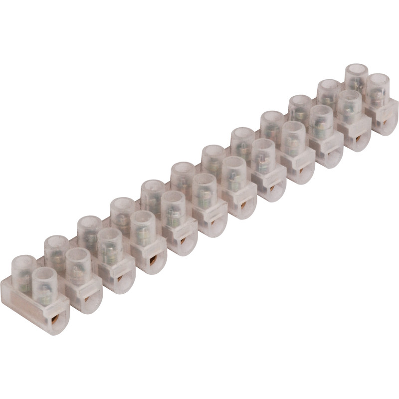

    Some photos of acceptable connectors in various parts of the world
    almost the only type of connector used in house wiring in the middle east

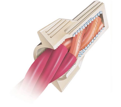

    very popular in the USA
    Wire stripper and twister - GIF-ideal-twister-341-tan-wire-connectors-illustration.jpg

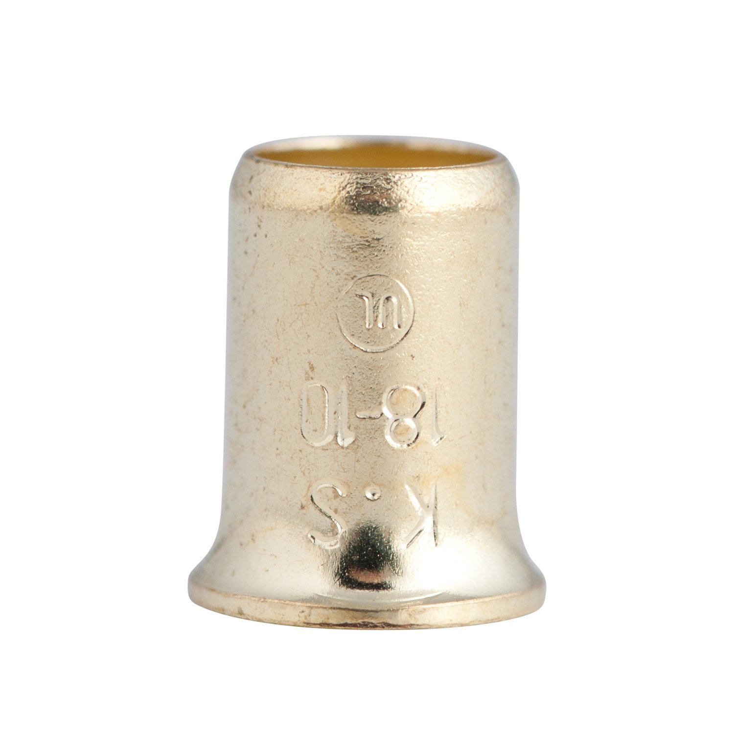

    My preferred after a connection is tightly twisted, if the wire is stranded I like to solder as well then these are crimped over the connection

    Some people simply stick the stripped ends of wires to be joined in a "wirenut" and twist the wirenut. I never did trust that type of connection and always tightly twist them before inserting in the nut, otherwise you are expecting that little steel spring inside to conduct the current of the joint.

    Not all wire nuts are created equal many don't even have the conical shaped steel spring in them, just plastic threads which may or may not be OK I only know that I don't like them and don't trust them even when having the ends firmly twisted prior to their use
