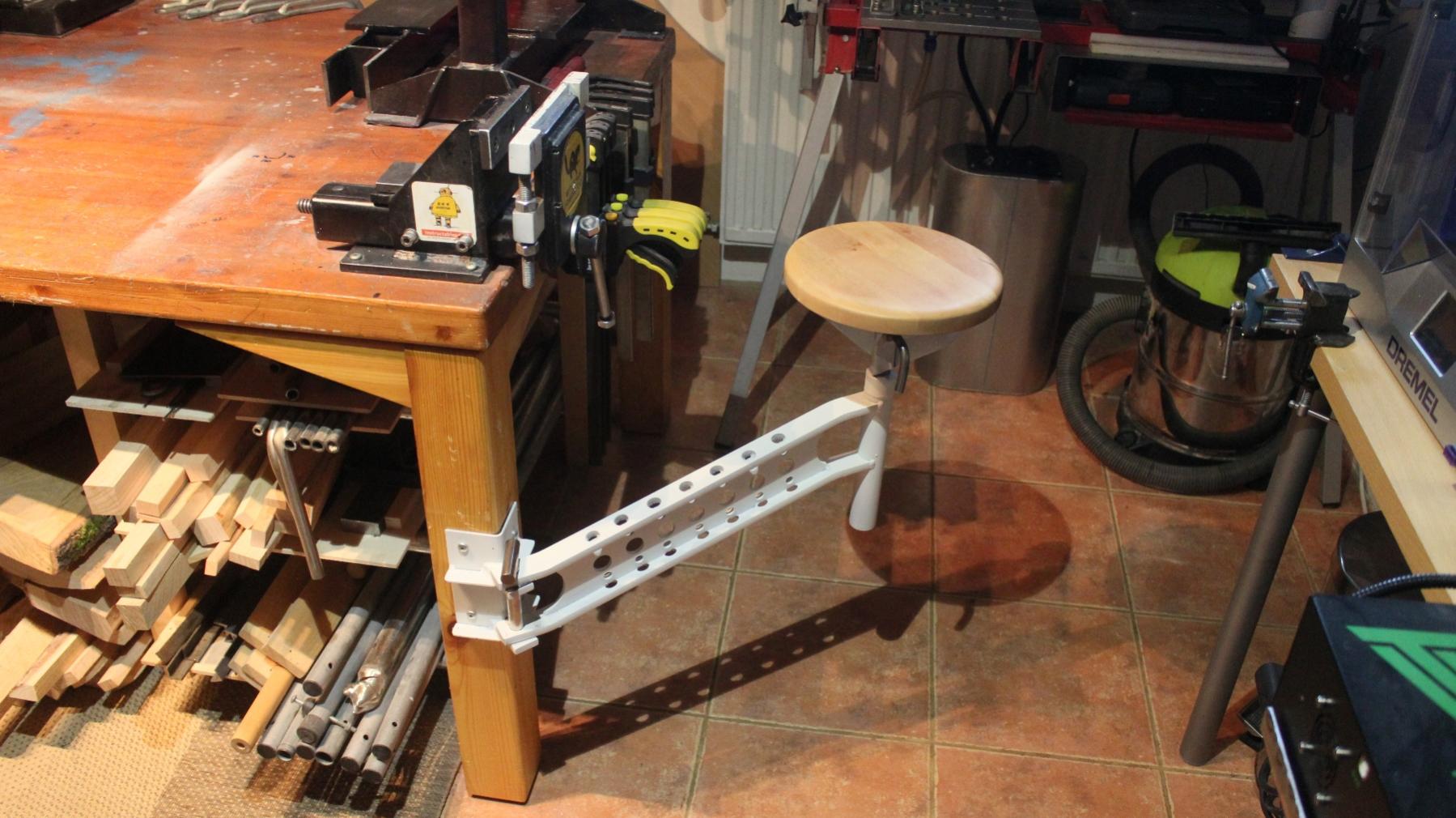

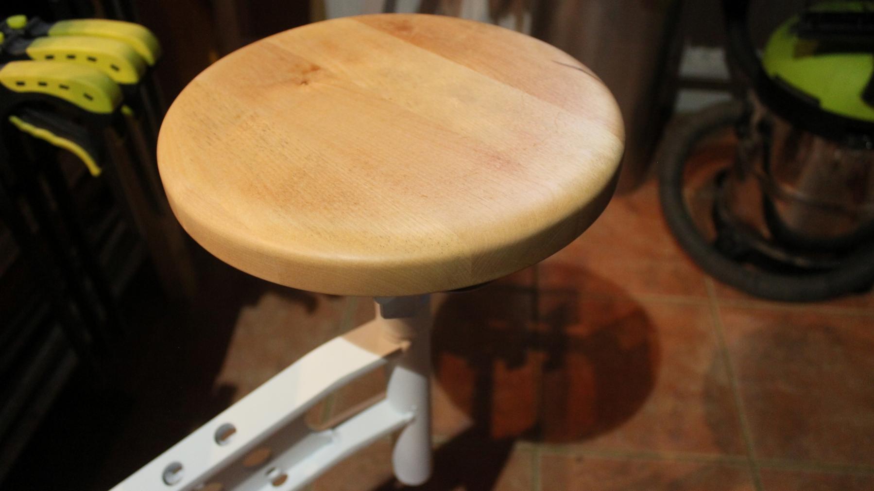

Made a simple improvement to my shop.
Attachment 23584Attachment 23586
Attachment 23593

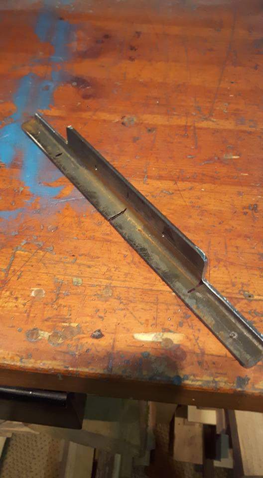

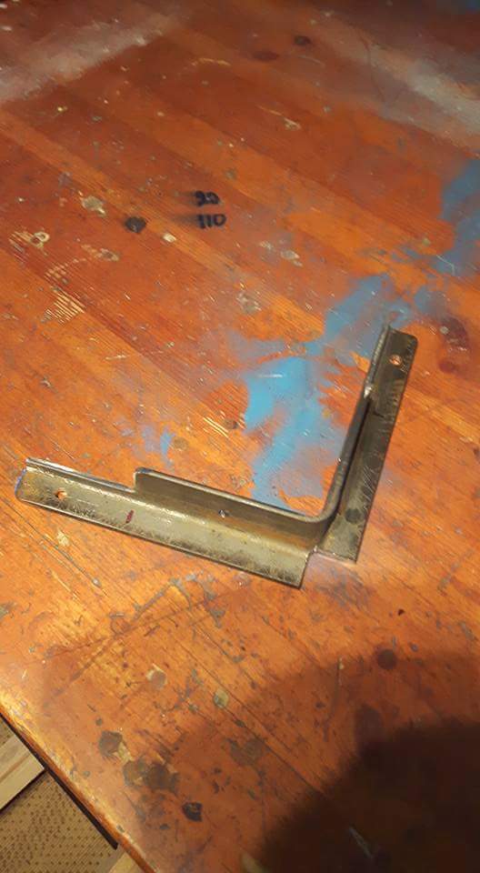

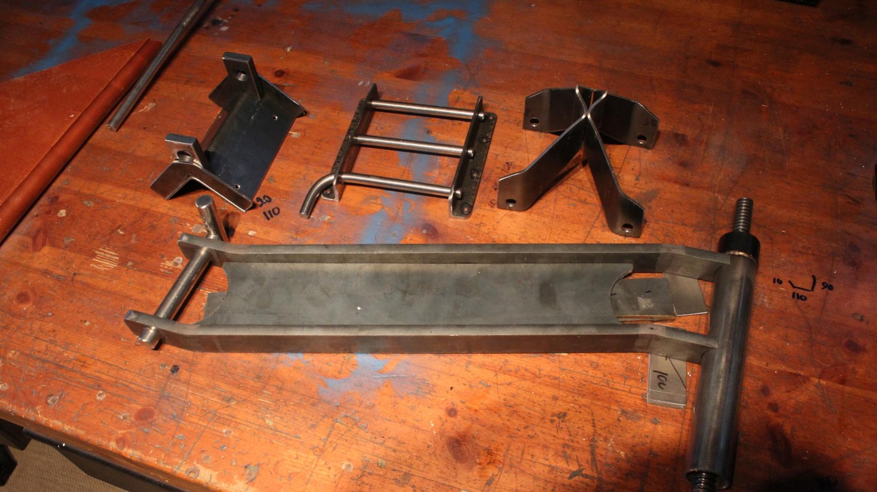

Parts before welding and "decorative" drillings.
Attachment 23598

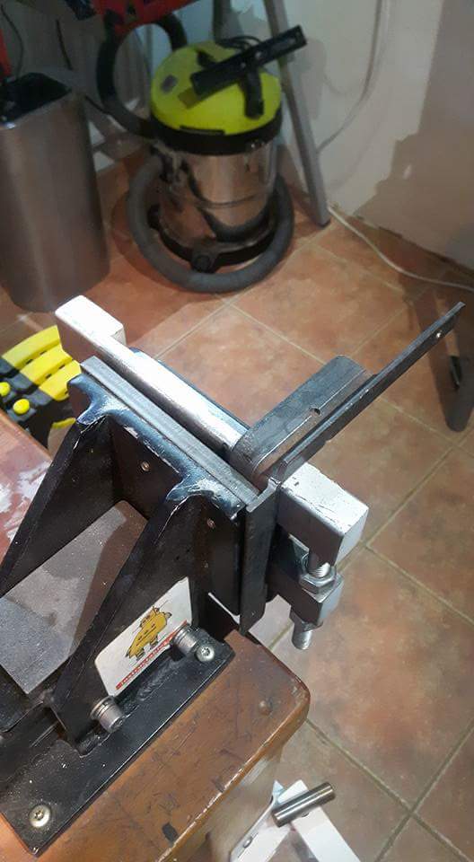

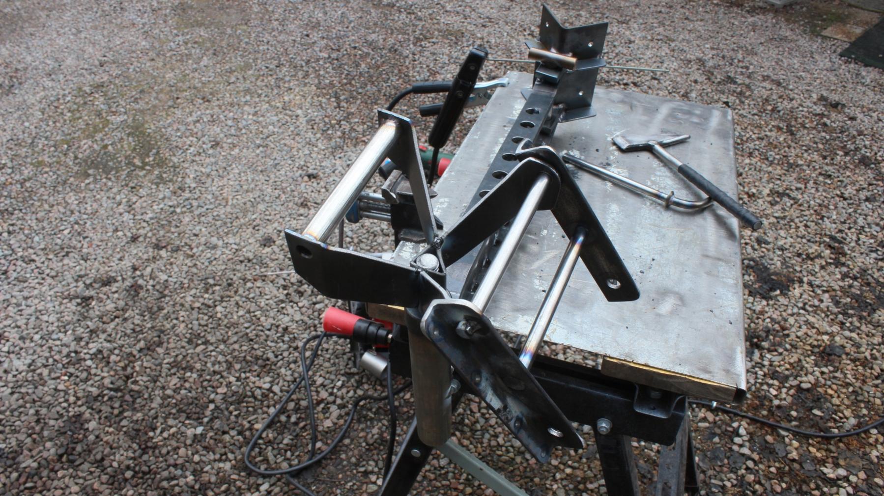

Picture from building process:
Attachment 23599

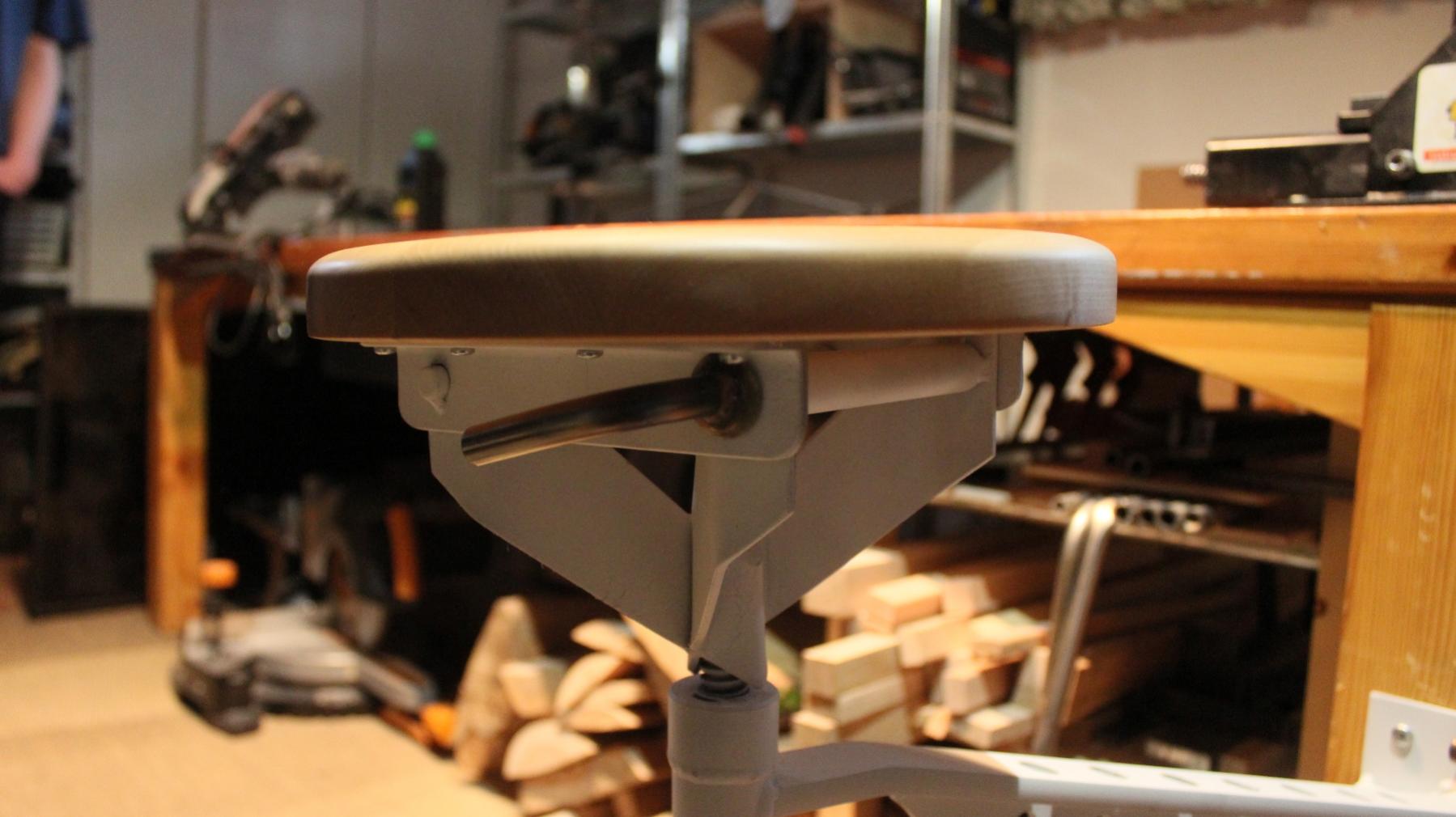

I used M16 trapezoid thread.
Nut is weld to pipe with tig. All other welds with 1.6mm ok 73.15 welding rod.
Nut would have been possible to weld with stick too, but i wanted to protect threads from splatters, choosed the easiest way in that point. I wanted to design my stool with minimal visible welds, no actual reason for that, just like it that way.

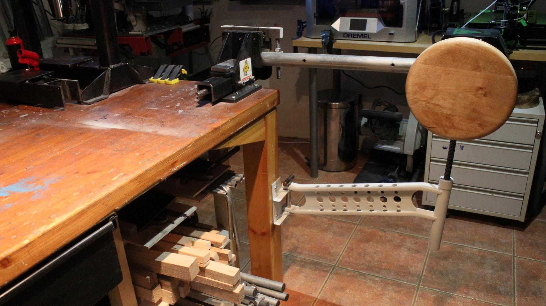

Swivel stool is usefull specially when filing, its easy to keep your position optional.
With regular stool you need to stand up and move stool, make those little "micro movements" time after time around the workpiece.
Also it helps when welding pipes / tubes too. It allows welder to move around the workpiece, without need to move position of the hands.

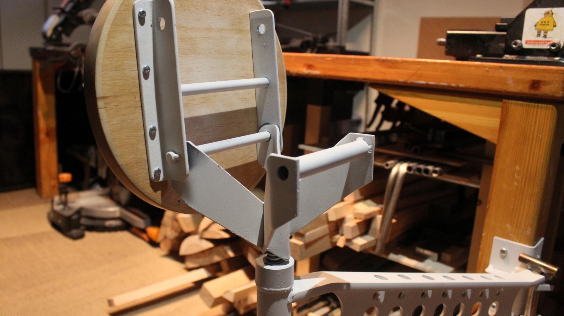

To get more use from the stool, it has an option to use it as a extra support too.
Specially with curved pipes, you can adjust the height and angle, to get support to desired spot.

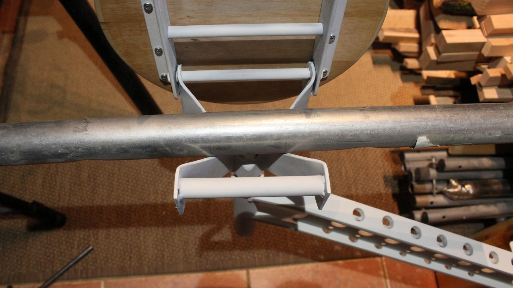

When seat is opened, you can find two V-grooves under it.
Attachment 23594
Attachment 23595
Attachment 23596
Attachment 23597

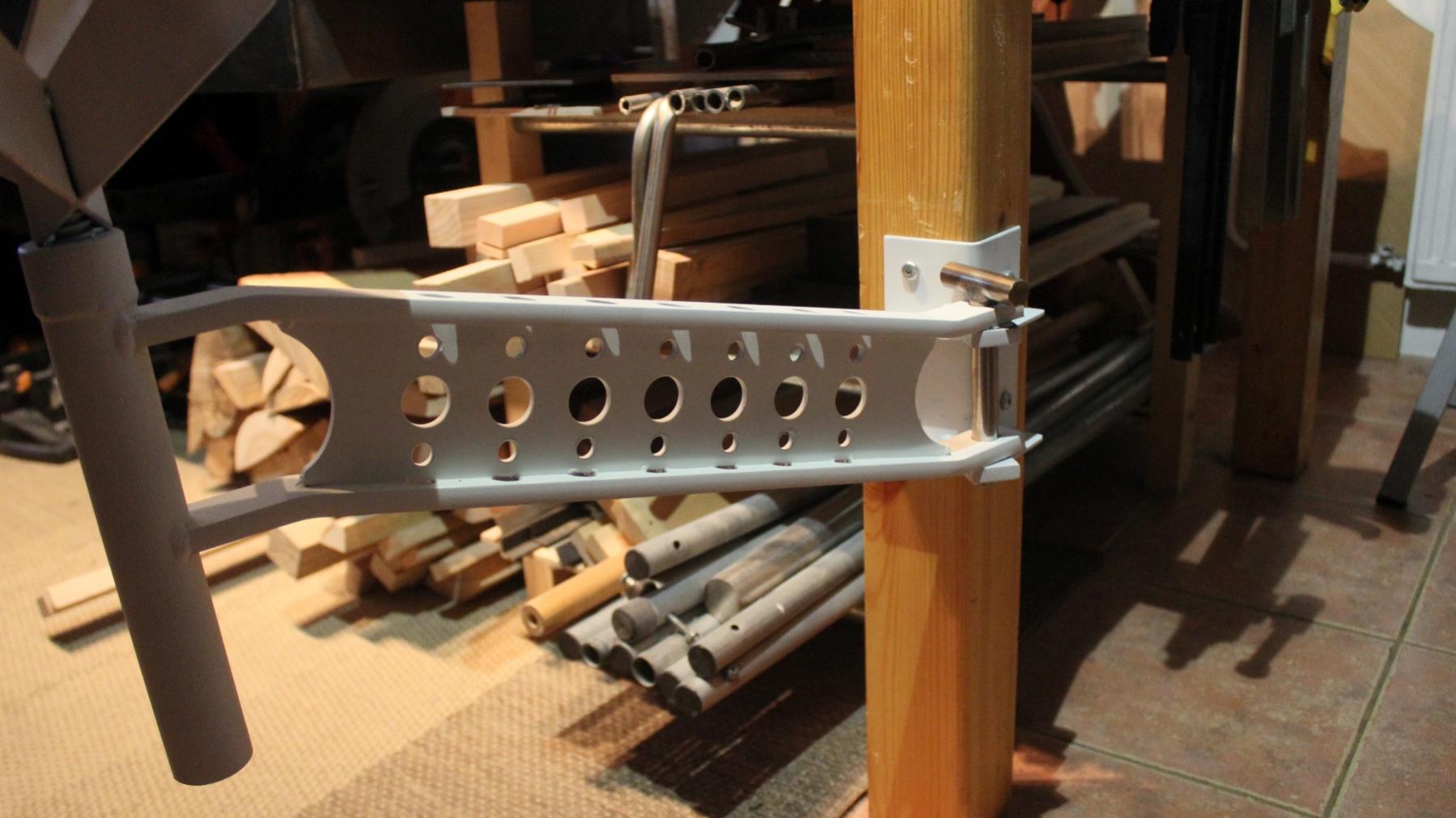

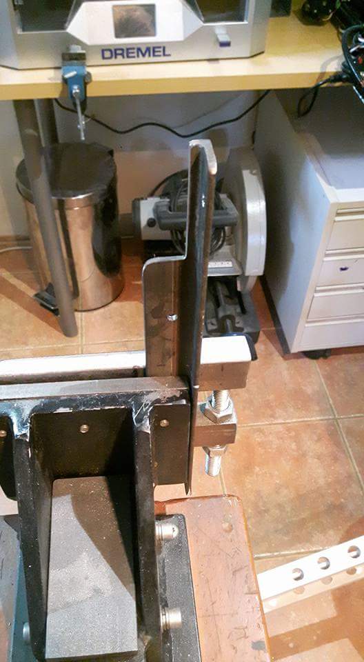

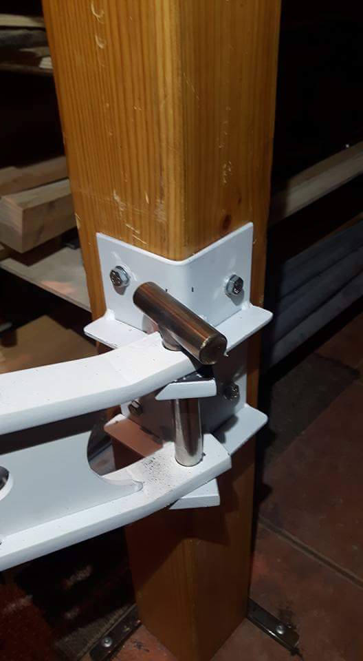

Mounting holes ain't at the same level. This allows to bolt it trough the leg.
Attachment 23618

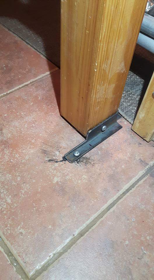

Also, i mounted my worktable to the floor from every corner.
Now it doesn't move... even if i want to.
Attachment 23619
Attachment 23620
Attachment 23621
Attachment 23622
Attachment 23623
