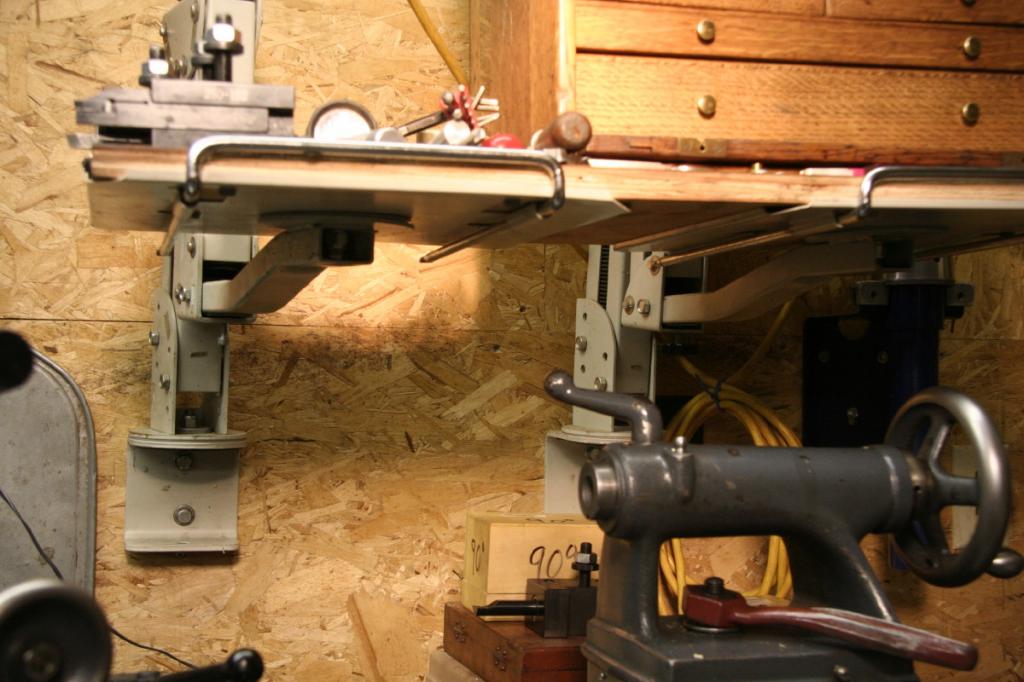

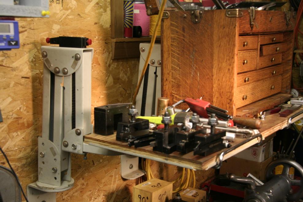

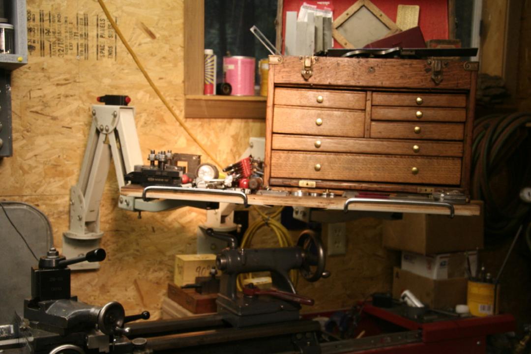

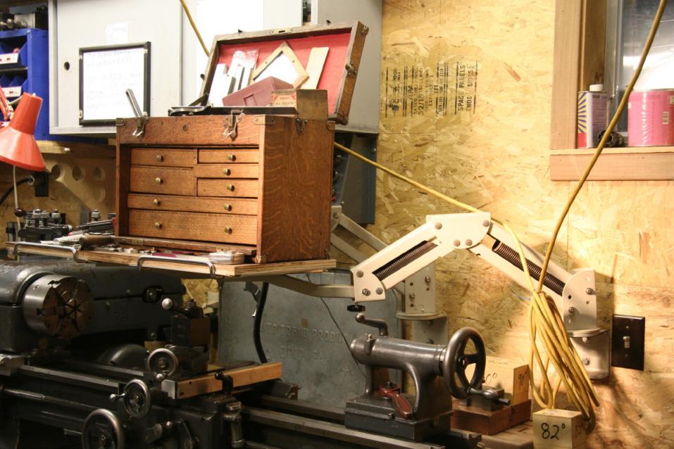

    I used 2 old wall mounted computer monitor mounts. I install a piece of 3/4" plywood to connect them together.
    They are supporting about 50# with no problems, it extends from the wall and turns about 45 deg. This setup is a space saver and it has the tools right there when you need them.Tool Box Wall Mount Swivel Platform-toolboxmount1_1.jpgTool Box Wall Mount Swivel Platform-toolboxmount2_1.jpgTool Box Wall Mount Swivel Platform-toolboxmount3_1.jpgTool Box Wall Mount Swivel Platform-toolboxmount4_1.jpgTool Box Wall Mount Swivel Platform-toolboxmount5_1.jpg

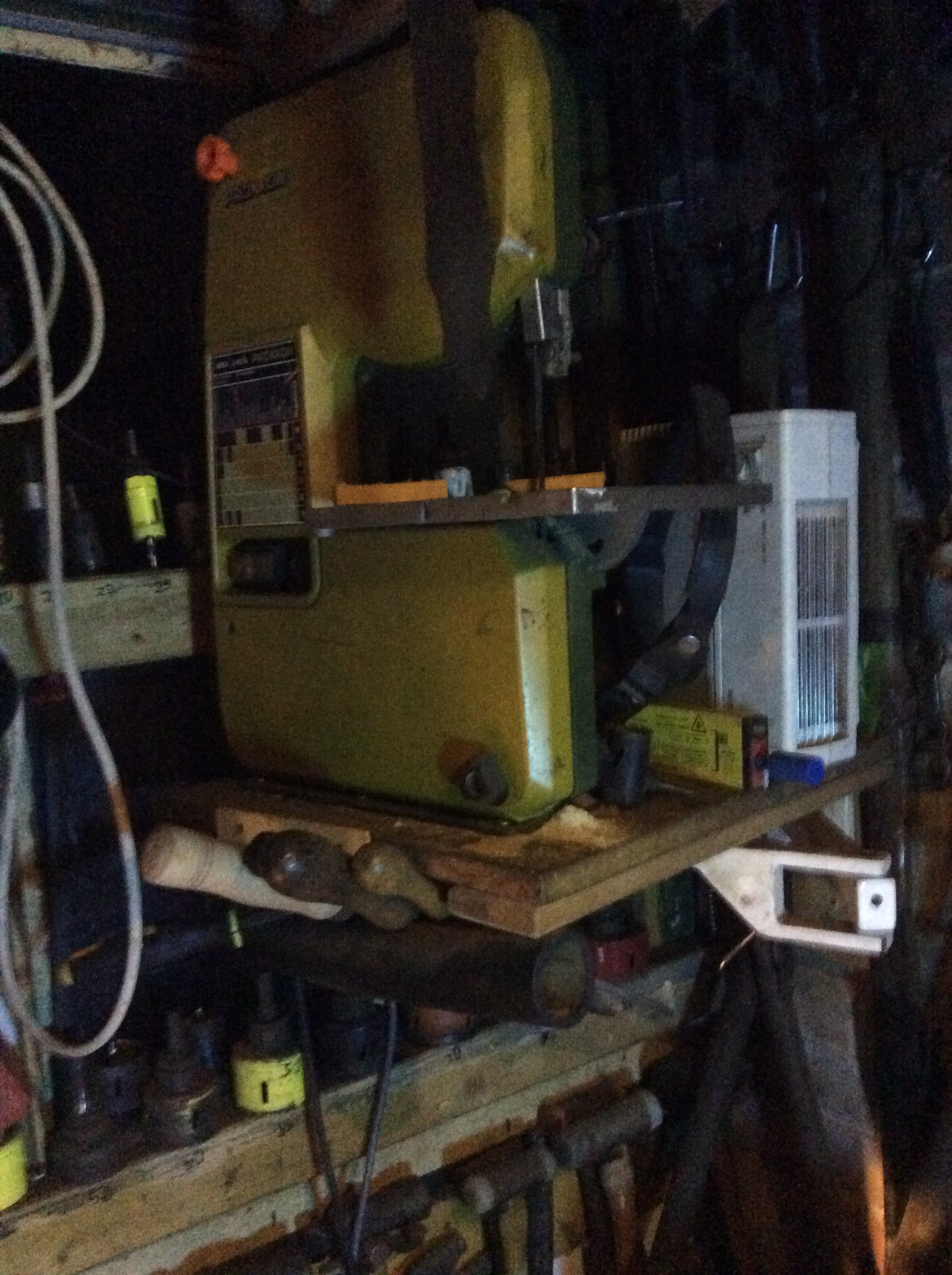

    Tool Box Wall Mount Swivel Platform-image.jpg wish I’d thought of sharing the idea earlier. All credit to you.
