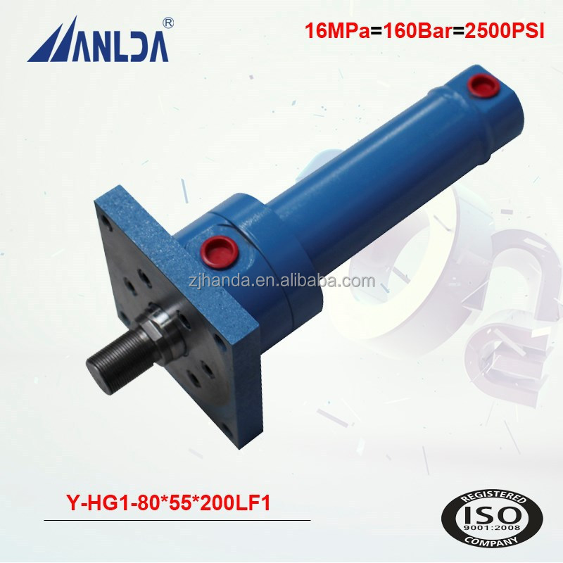

    Thanks for your comment. All your points are absolutely right and well taken. I understand that the hydraulic cylinder with a flange interface may be much better since that will support the cylinder closer to the rod . So effectively half the span will be reduced, which will in turn help in preventing buckling under load. I have shown in the picture below.
    Wooden log splitter/ Hydraulic press/ Pipe bending--MULTIPURPOSE HYDRAULIC MACHINE-htb1f1fahvxxxxcbxxxxq6xxfxxx1.jpg
    Also the glasses I am wearing are the ones that I got along with the welding machine. I was not knowing those were mere sun glasses. Since it was supplied by the welding machine manufacturer himself, I guessed it may be of good quality with UV protection too.
    I have just started welding work recently and hence I am not an expert by any standard. Will definitely take your suggestion of cleaning joints before welding.
    Thanks once again for your valuable feedback..
    That cylinder might work, and certainly would give better support, but moving the work closer to the end is the most effective way to push. While the push end will have significantly better support, with a wobbly frame and wobbly tool frame, the rod would still have lateral movement. And, if I read correctly that the goal is to go from 2" to 4" diameter, remember that force is pi * radius^2 * pressure, your force increase is 2^2/1^2 = 4 times which would be a 16ton force...
    As for the glasses, if they came with the welder, they might be usable, but it would be interesting to learn what the actual shade is. The normal minimum for most welding is 10 but often for comfort, a shade of 11 or 12 and sometimes up to 14 is used.
