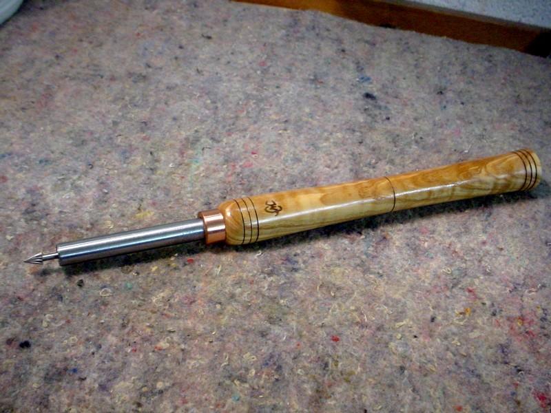

Here is my rotative tool for making some nice ornaments in woodturned pieces :
http://www.labellenote.fr/photo/gal_..._deco_elf3.jpg
http://www.labellenote.fr/photo/gal_...deco_elf_1.jpg

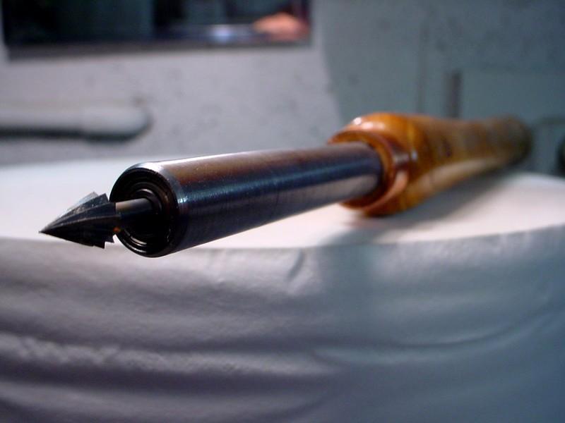

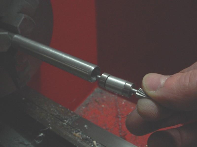

Its done using a pair of micro ball bearings, 3.2 mm interior diameter, inserted with a spacer in the tip of a 10 mm shaft, itself inserted in a woodturning tool handle.
The handle is made out of figured ash.
http://www.labellenote.fr/photo/gal_..._deco_elf2.jpg
So the bits are standard Dremel bits, I have different shapes, cylinder, ball, or conical as on the picture.

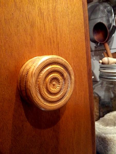

It's applied with a little pressure under whatever angle on wood, and you obtain nice spiral like figures.
Actually, it's always difficult to predict what the figure will be, but it's nice.
