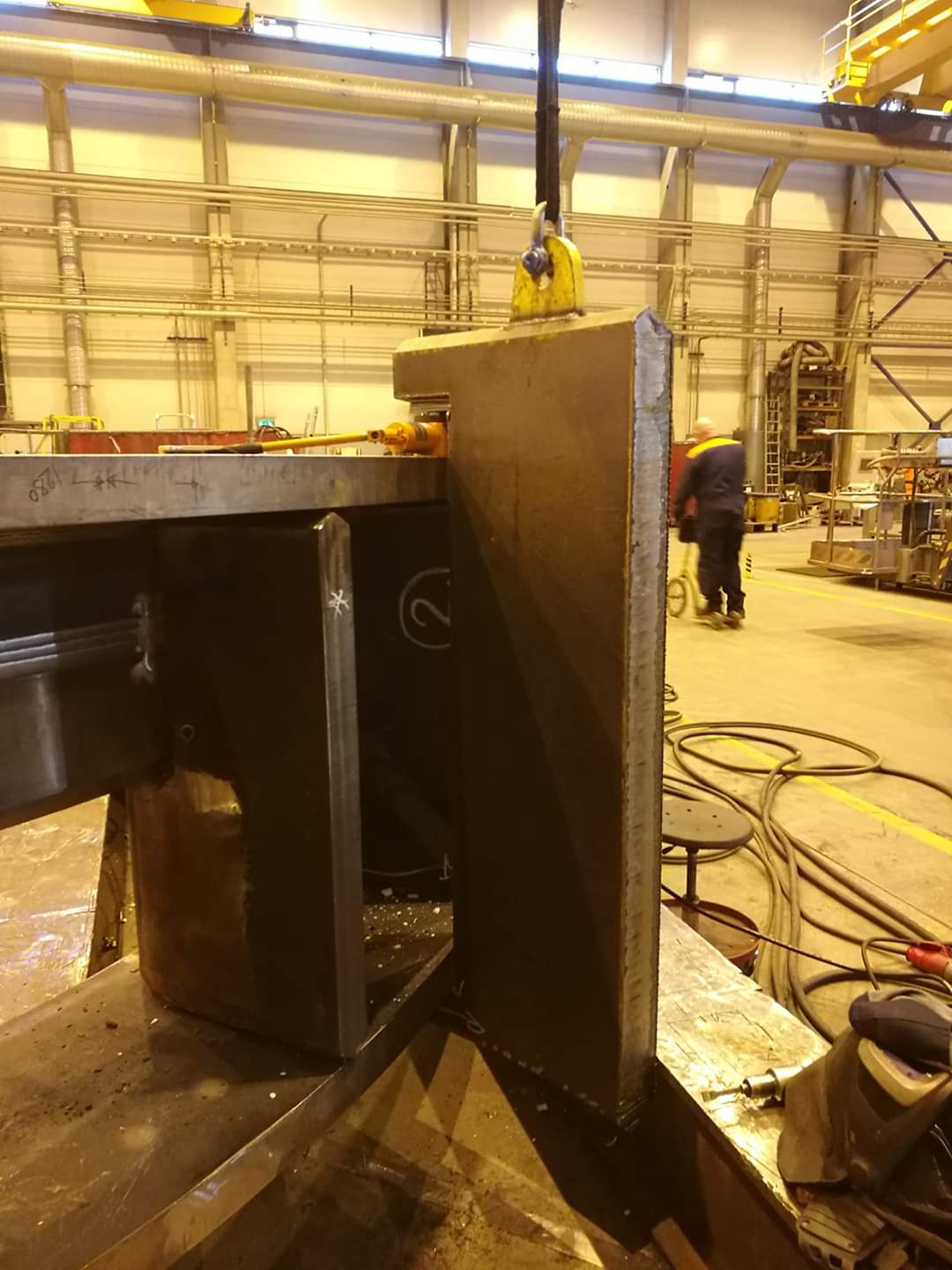

This was a little overkill solution, but was definatelly strong enough. 50 ton jack, for pressing plates against rips.
Attachment 31823

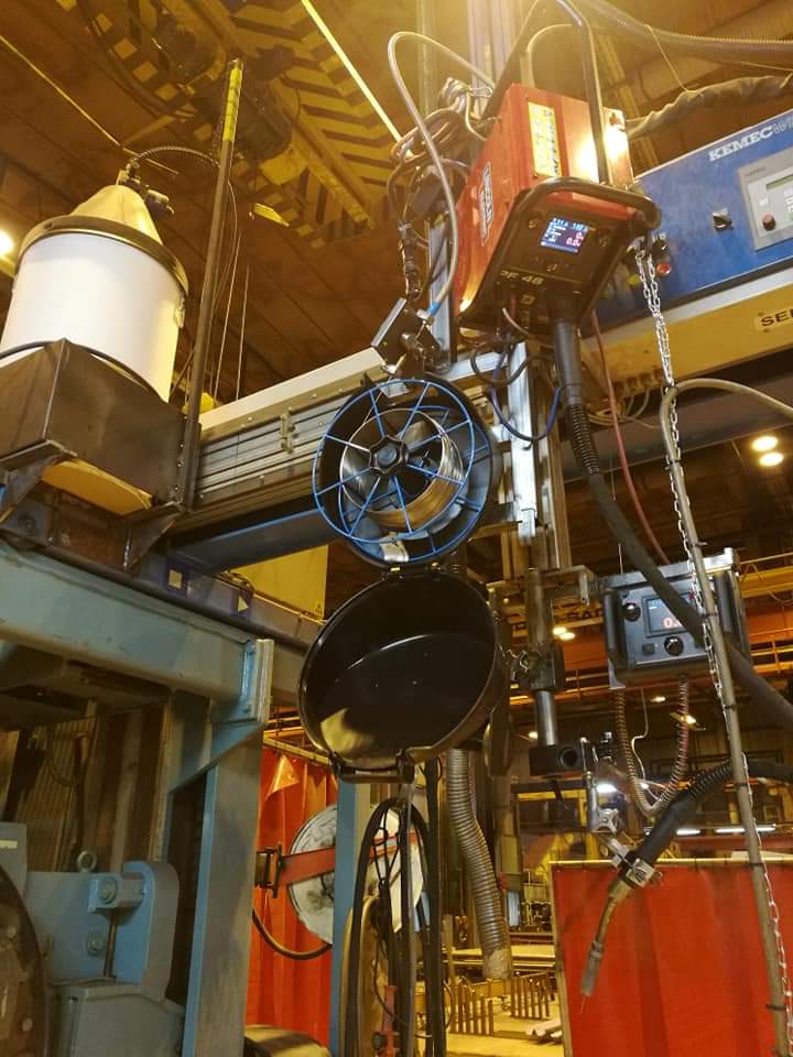

Re-located the welding wire spool
Solid wire comes from the 100kg marathon pack on the upleft..
But when using flux cored wire, it needed to be placed on top of the wire feeder ( that red box )
It was a little complex task. So i made a new placement for the spool.
Attachment 31824
