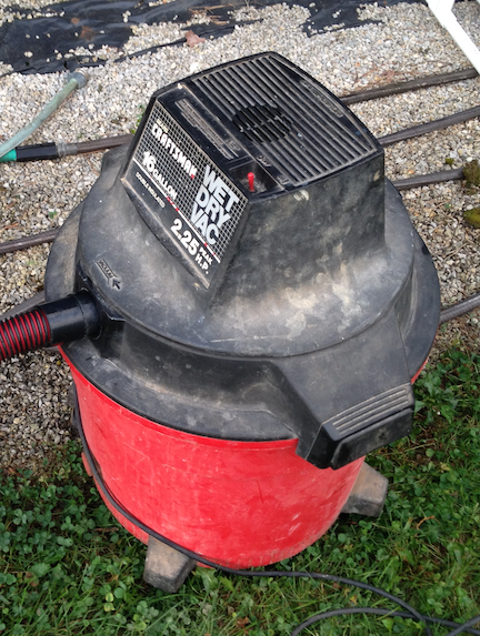

Next, you need a good vacuum. I have an old Craftsman vacuum that has been around for years.
Attachment 31269

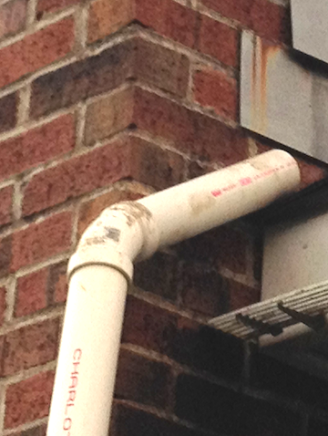

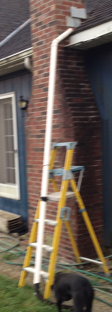

You need to hold the vacuum inlet close to the critter entrance , but don't try to suck them out of the hole. I find that within 2-3 inches works well. You want a good strong air stream to be flowing across the entrance. You need to get them as they try to fly into and out of the entrance. Just like an airplane, they are most vulnerable during take off and landing.
Figure a way to hold the inlet close, depending on the location of the entrance. This time I used some old pipe I had and a ladder with bungee cords to position the inlet.
Attachment 31264 Attachment 31265

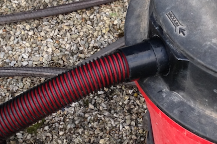

Hook up the vacuum, I just used duct tape to attach the vac hose to the pipe. Let it run for a few hours while the critters are active. I try to have the hose running straight rather that curving as it runs into the vacuum. This allows the air stream and the critters to be traveling as fast as possible as the enter the vacuum, and HIT the elbow right inside. This sudden stop, eliminated most of the suffering they may otherwise experience
Attachment 31270

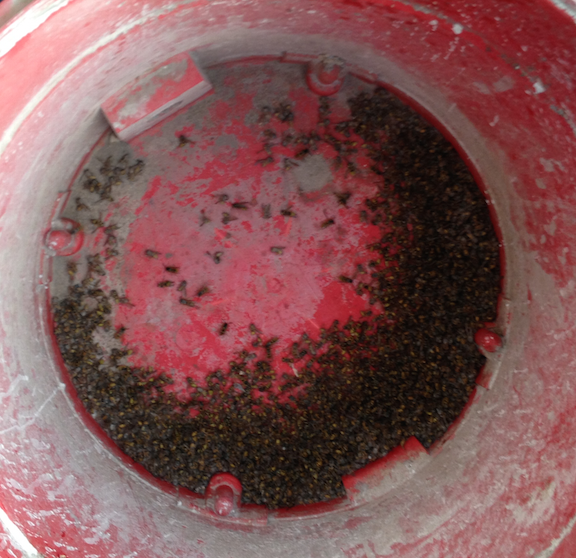

You need to watch the action for a while to be sure you are capturing most of them. Some escape, but eventually they end up in the bucket. It may take a few days to get them all. Only run the vacuum during busy times, there is no point running it when there it no activity. The few that may remain in the colony cannot survive without all of the workers.
Attachment 31266
