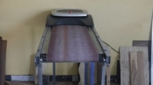

    Hi guys!
    I got this treadmill for cheap the other day and converted it to a sander. It has a 1.5 HP motor but it seems enough for the job.
    Firstly I got rid of the base and handles.
    I then bolted the control unit onto the motor cover, which is a convenient spot that allows me to work from either side of the sander.
    I built a steel frame to get it on working height and reinforced the table by adding a 20mm plywood board. It's not a precision surface but I was able to make it reasonably flat by adding shims over the tabs on which it's bolted on.
    I will be adding a stop bar to prevent any workpiece from flying to the other side of the room I also want to build a 90 degree fence and the popular fretboard sanding jig that works with belt sanders!

    That's a great idea. Thanks for sharing it.
    Btw, how much do belts that size cost?

    Fantastic job, immortalx. Nice idea keeping the control panel, has a professional look to it.

    GlennR I ordered this one from a local shop that does custom sized belts for 30€ ( about 31.5 USD)

    Good work on the machine. I actually kept the parts to a treadmill in case I ever wanted to do this but don't have room in my shop.
