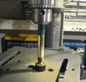

Homemade drill press live center utilized for polishing by drilling and reaming a tapered hole in the table in line with the chuck. Small workpieces can then be spun between the centers.

A novel use for a drill press. I like it.
