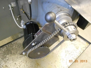

Homemade Power Drive for Mill Knee
shootnride on chaski.org
Homemade power drive for a mill knee constructed from a Bodine gear motor, chain, sprocket, and a clutch pack. The adjustable clutch pack was fashioned from machined disks and brake lining material.
