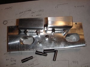

Homemade soft jaws with dowel pin fabricated from 1" wide stock. Pins protrude 3/4". Designed to support two simultaneous work pieces and permit machining of all six sides in tandem pairs.
