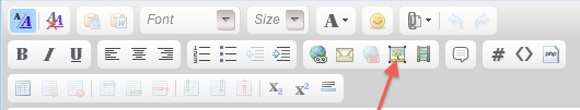

    Just a quick heads-up on photo posting (since your attached images didn't show properly).
    If you click the "Insert Image" button indicated in the screencap, you'll be able to upload your photos, either from a hosting service (such as Photobucket) or directly from your computer.
    If you're referencing photos hosted on your own site, they naturally won't show when your site is inaccessible. For what it's worth, I haven't been able to access toolmakingart.com - is there perhaps an issue with the site?
    Ken
