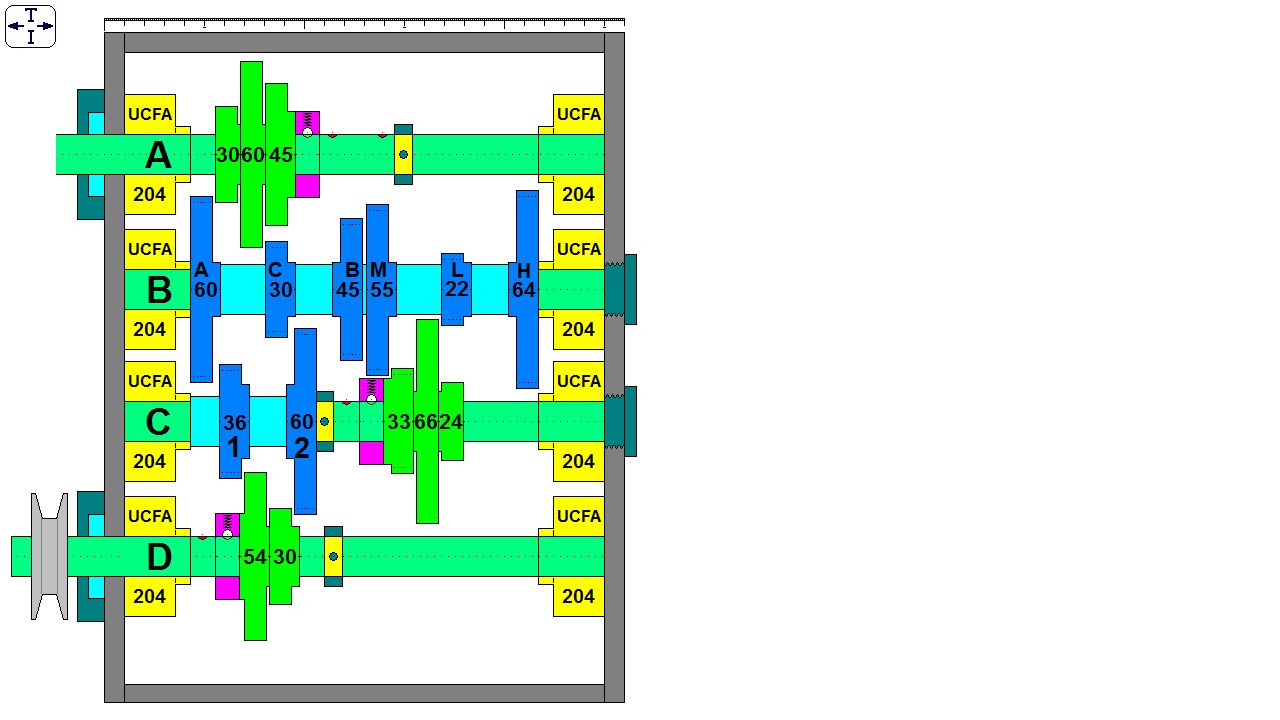

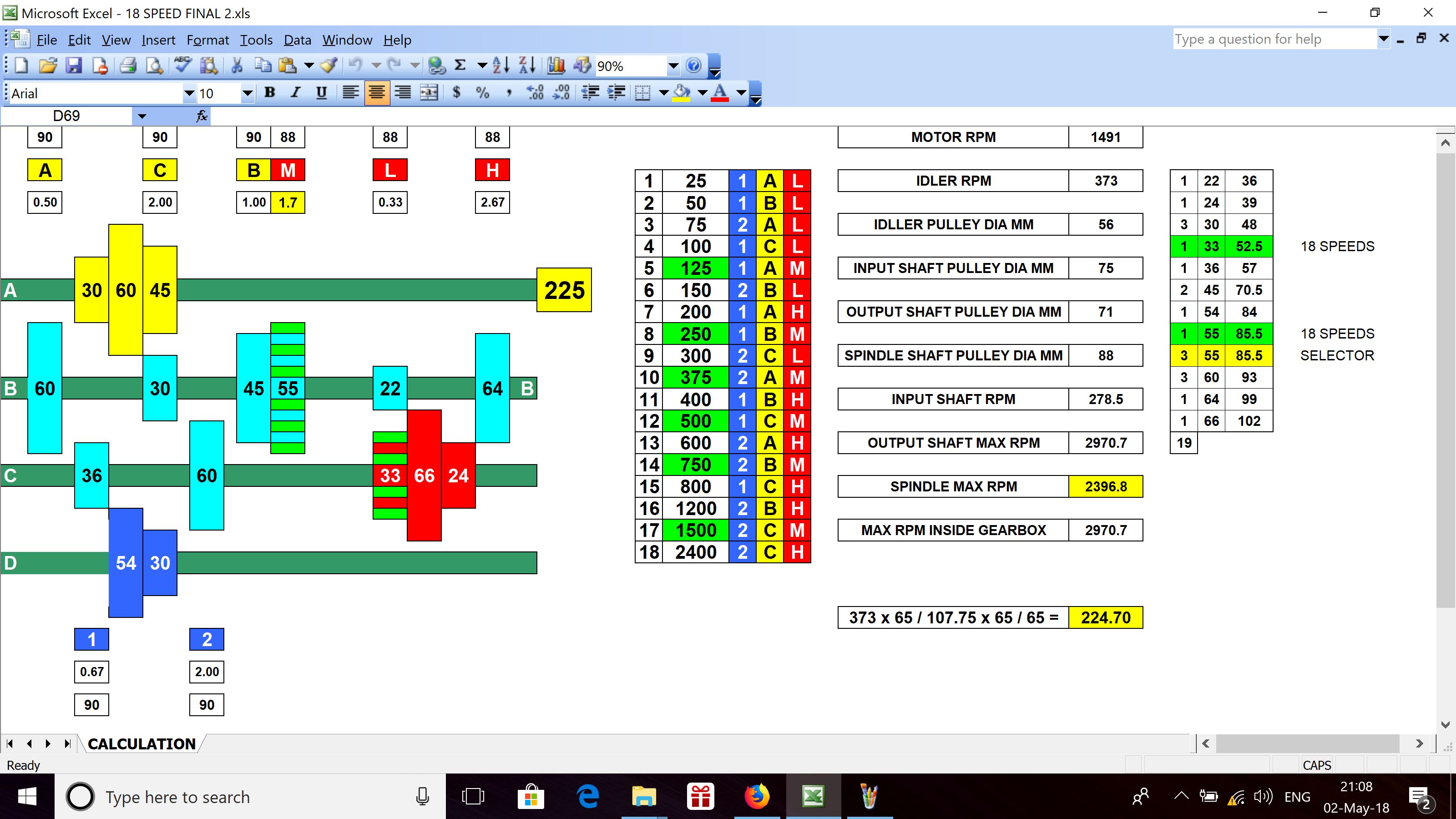

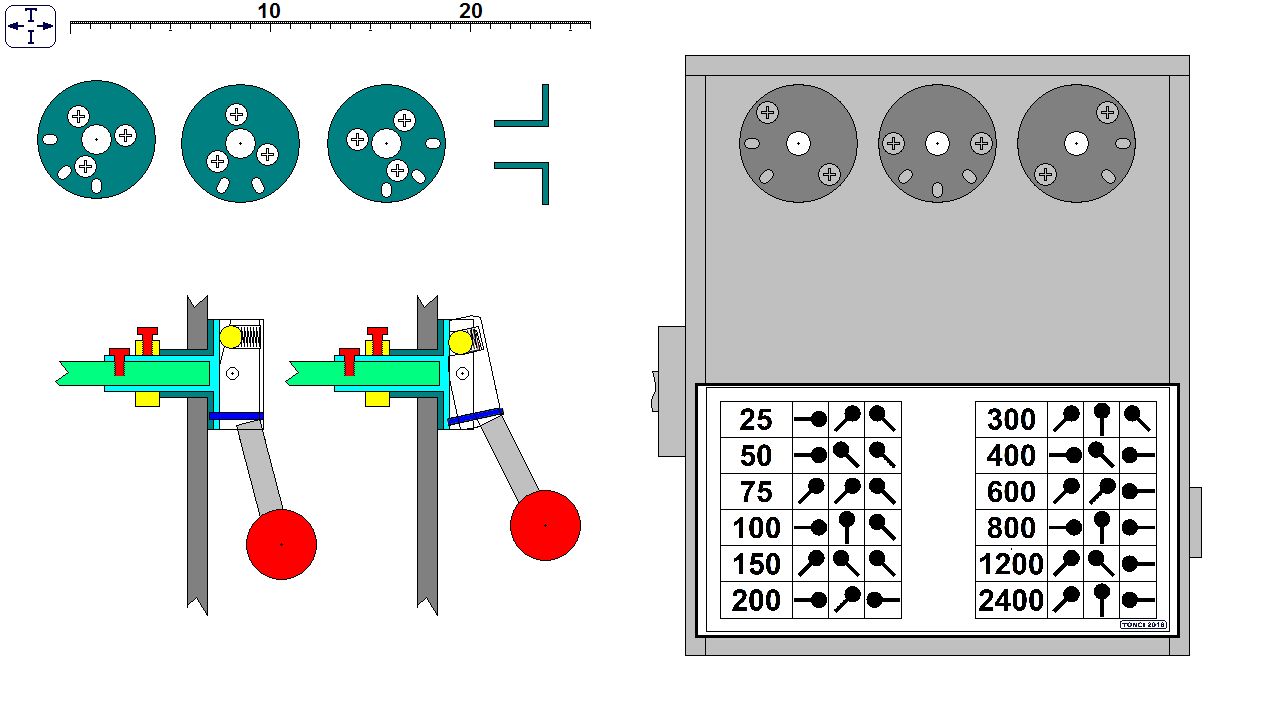

    couple of ideas which I abandoned in order to make it simple:
    12 speeds instead of 18 speeds
    different selector handles and detents. simply bought three M18 bolts and nuts and made different, much simpler detent mechanism, as I knew that I wouldn't have time to complete it as originally planned.
    couple of drawings attached.
    Attached Thumbnails Attached Thumbnails Homemade Lathe Headstock EXTERNAL Gearbox-scr2.jpg   Homemade Lathe Headstock EXTERNAL Gearbox-18-speed-02.jpg   Homemade Lathe Headstock EXTERNAL Gearbox-selector.jpg
