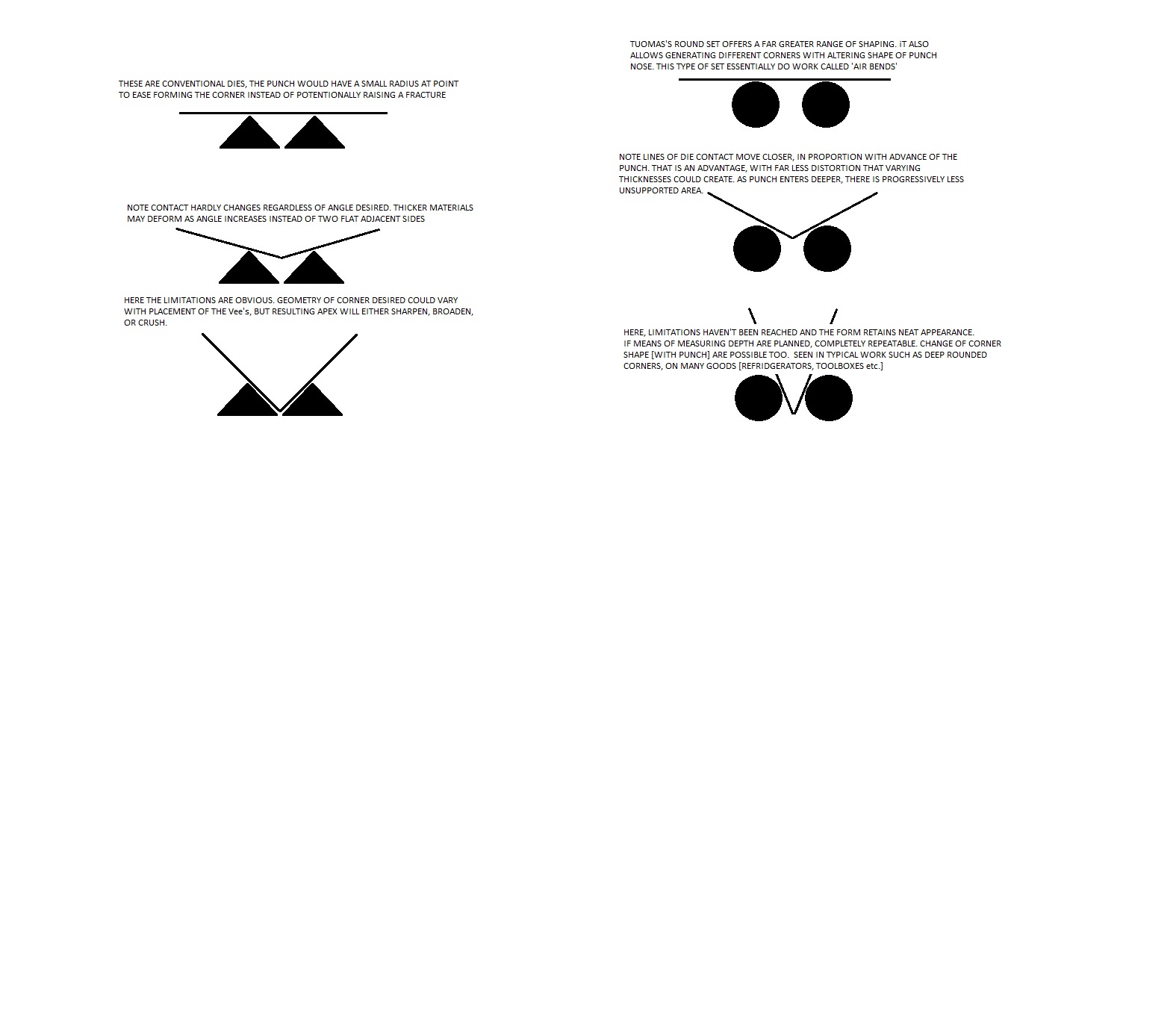

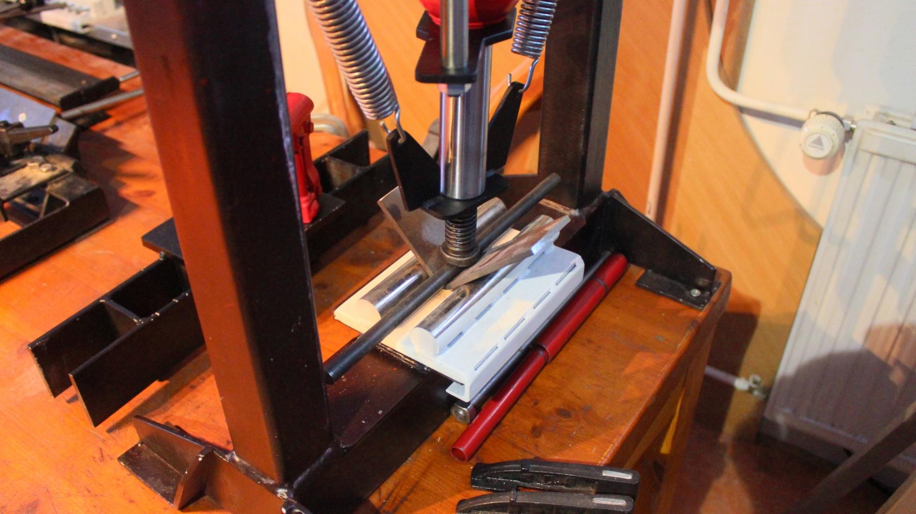

All kinds of good features in this project, but my favorite is pictured.
Round stock for dies, far better at shaping than conventional use of inverted angle iron [apex up]. Not only easier to control, but makes acute angles possible. Contact with angles remain constant, while round diminishes as punch enters farther.
Notated illustration below, click to enlarge. Enjoy!
Attachment 23131
Thanks. I like both are usefull. Angle iron for very tight corners. Round bars for larger diameters.. bonus is that round die doesn't leave marks so easily.
Personally i like that angle irons and "sharp" upper die helps to get bens to the right spots, specially when you need to bend both ends of the object, and right distance between bends is important.
I place the "sharp" upper die to the mark and press. I count the centerpoint of the bend radius, wich usually is one times plate thickness, if both bends are 90 degree. ( material thickness affects ) With round upper die placing it to the right spot needs more carefull preparations.
Well, I don't want to be the taskmaster, but you'll get a good measure of repeatability with a back-gauge. Then preparation will cover a run of parts. I need to do some round corners myself, to restore a rusted out and ancient Kennedy roll-cabinet. I'm even thinking of making it a bit taller. Issue now is how to produce offsets for the panels between...:confused:
Yep. It helps sometimes. But i don't usually trust them. If you make bends for the both ends using back-gauge, and have made little mistake when cutting the workpiece, then mistake is delivered between the bends.
I like to design my builds so that possible measuring mistakes are left to the edges, where there usually is no matter, if one side is one millimeter longer or shorter. ( if it matters, then its easy to remove with grinder.)
This gives me a conclusion that there is no best way to do anything that would work with everybody. Everyone works on their own way, how they design, mark or measure..
Personally i think that its good to have many different bending dies. But if i would need to choose only one option, that would be:
Round bars at the lower die, and sharp one on upper.

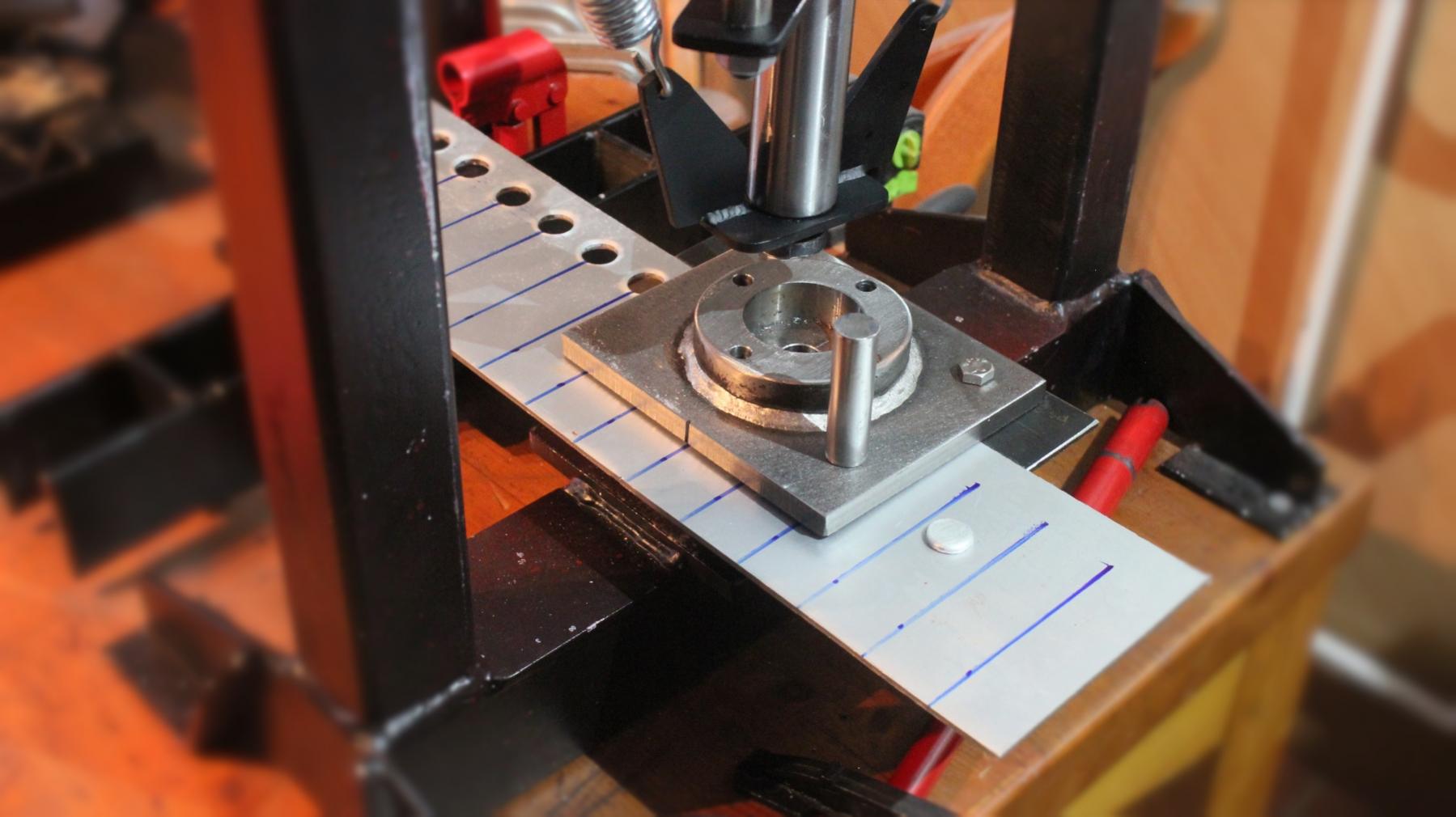

Made this jig for stamping sheet metals, it also works when punching holes.
I like to make tools that can be used many ways, it saves material and space.
I have couple projects where i can use this tool. I shared it, because i tought one can get ideas from it for some other projects too.

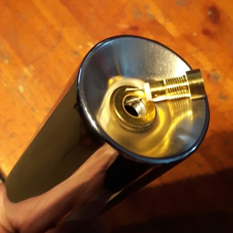

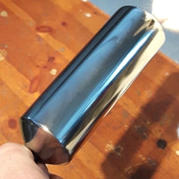

Cone shaped ends are stamped.
Attachment 23305Attachment 23306
Bottom is flat, because i weld M8 nuts behind the plates, to attach leds and hose fittings.

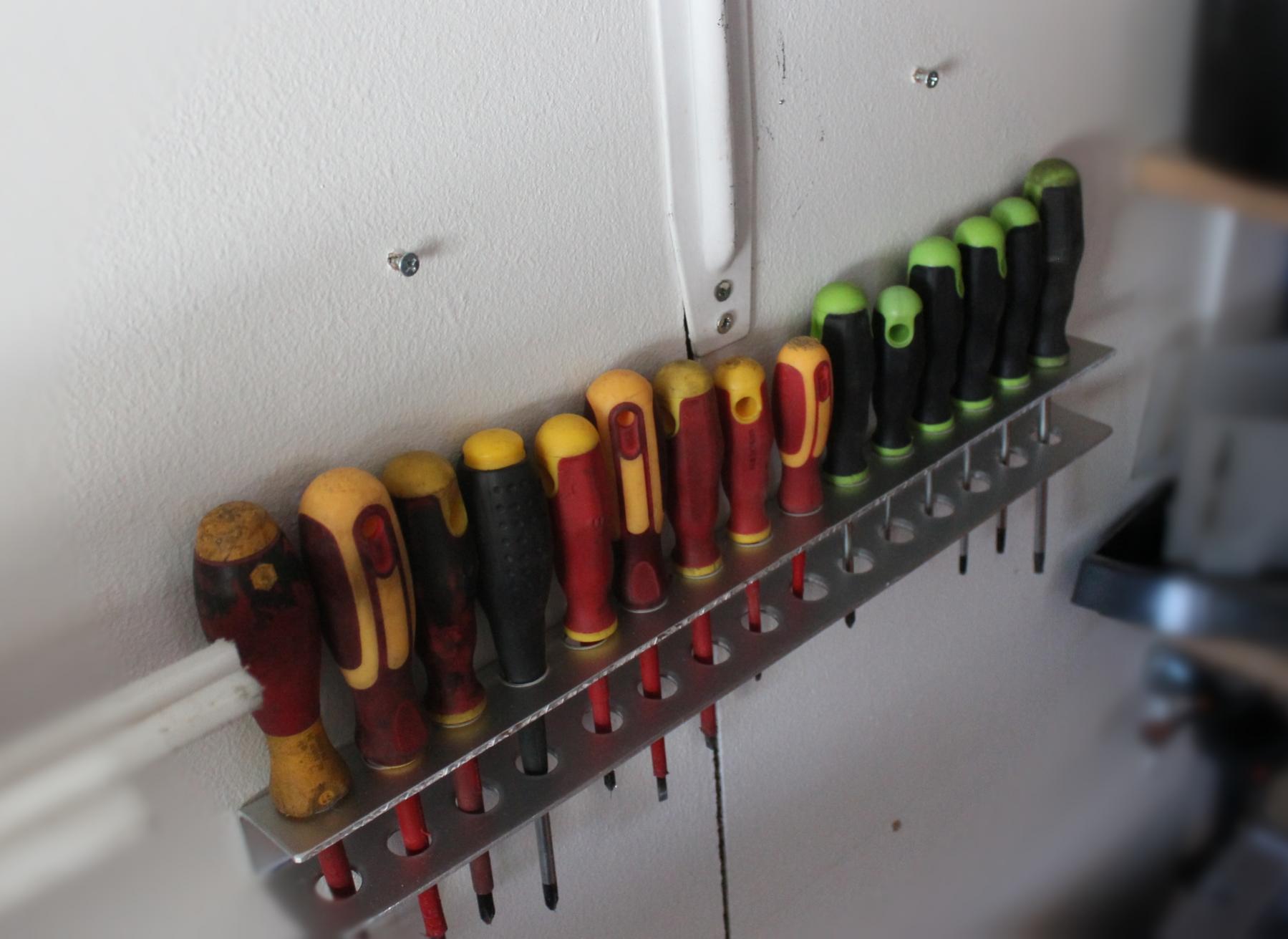

Made a "stress test" with 4mm alumine plate. I need to punch hundreds of holes to 1mm thick plates to make heat exchanger, so it looks promising.
Didn't want to waste that test piece, so i used it for this.
