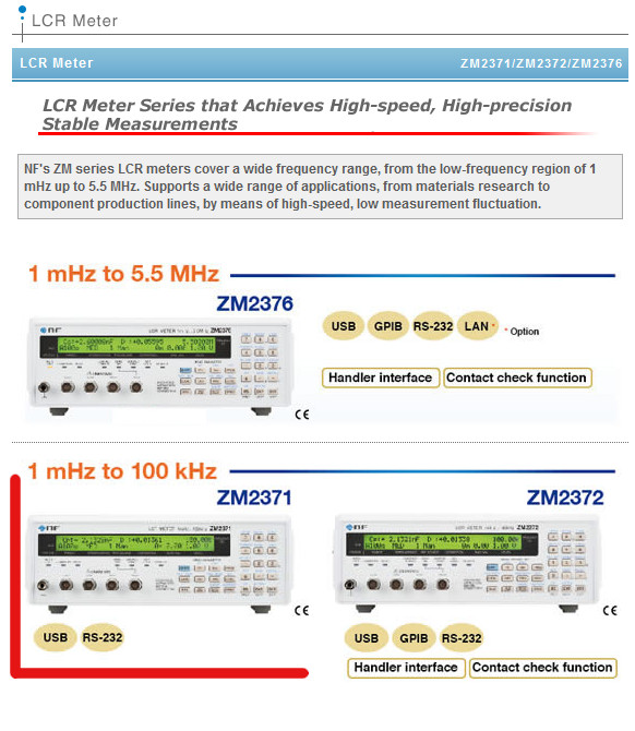

    If you have access to one, an ESR Meter will better help diagnose faulty capacitors without having to remove them from the circuit.
  11. #20
    Supporting Member chy_farm's Avatar
    Apr 2018
    Yokohama, Japan
    125
    65
    Thanked 211 Times in 60 Posts
    chy_farm's Tools
    Quote Originally Posted by VinnieL View Post
    Thanks, this is informative.
    I have learned some about this method while ago, and tried this device myself;
    Replacing capacitors in old TIG welder, and adding cooling unit.-nf_block_zm2371.jpg
    In case the capacitor got too bad this works good, but if it has very small symptom this does not work right.
    A very small sign of gas-leakage under a capacitor may be too subtle for the meter to show something too bad.
    This means if you do this sort of job on a preventive measure, you d better try remove one to know what. IMHO.
