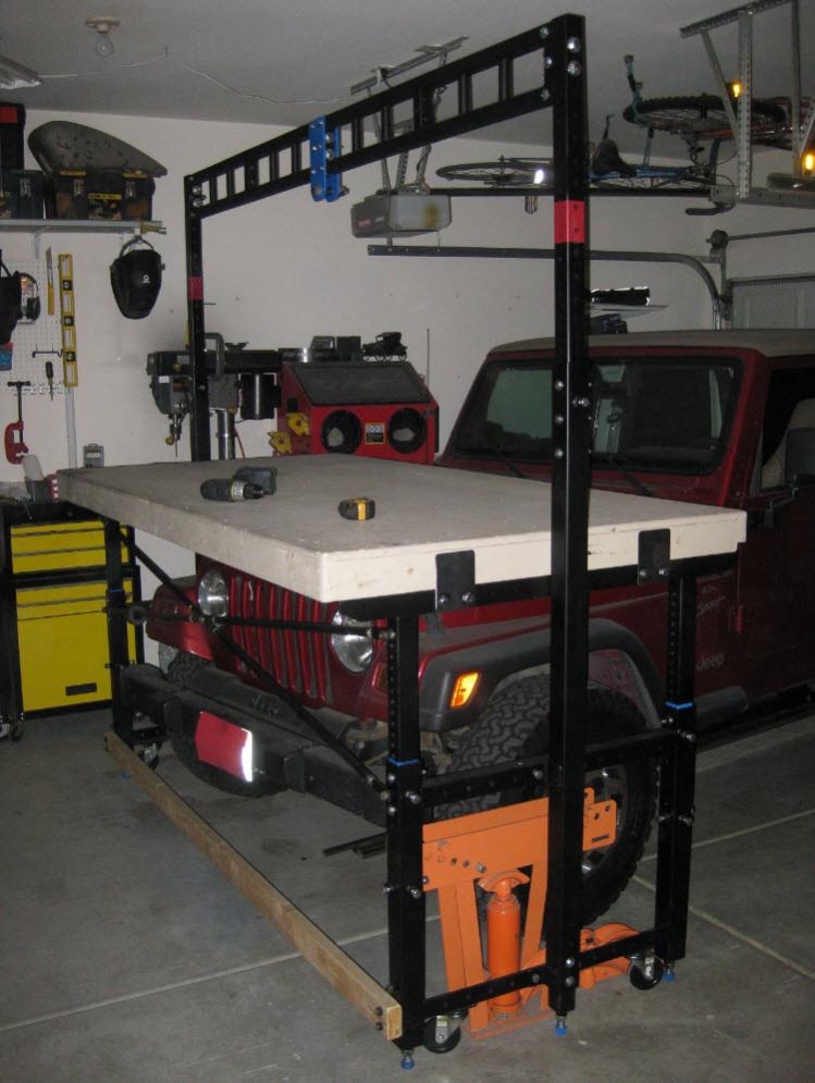

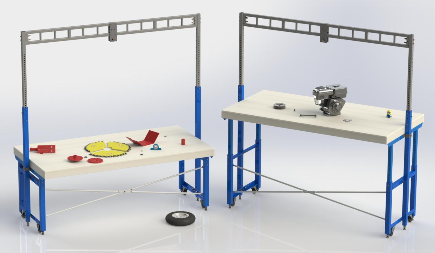

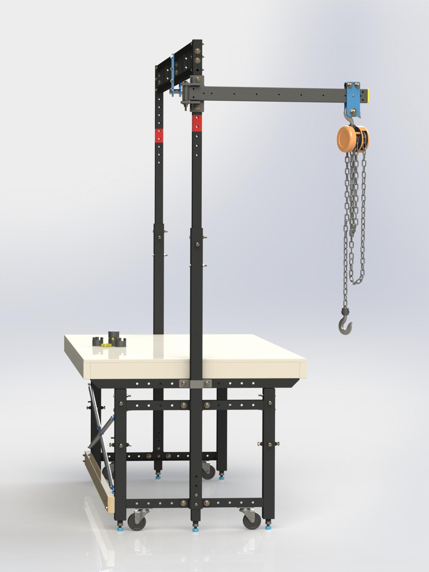

    I needed more space in my Workshop but also wanted to store my Jeep inside when not using the workshop, so I designed this Over-the-Jeep Lift Table that also works as a Gantry-Lift with a 1-Ton Chain Hoist when the tabletop is removed from the metal frame.
    Designed it using SolidWorks CAD Software and made concept image renderings, and then cut metal, and welded the Lift-Table.
    ‘Over the Jeep’ Workshop Lift-Table-over_jeep_lift_table.jpg‘Over the Jeep’ Workshop Lift-Table-workshop_lift_table.jpg
    When I want to use the table in a lower position I just pull out the Jeep and connect the tabletop section with a Eye-Bolt in a hole in the center of the tabletop to the overhead chain hoist and lift up slightly to loosen the legs connection bolts, then pull out the bolts, lower the table down as low as 36" and then put the leg bolts back in to secure the table height.

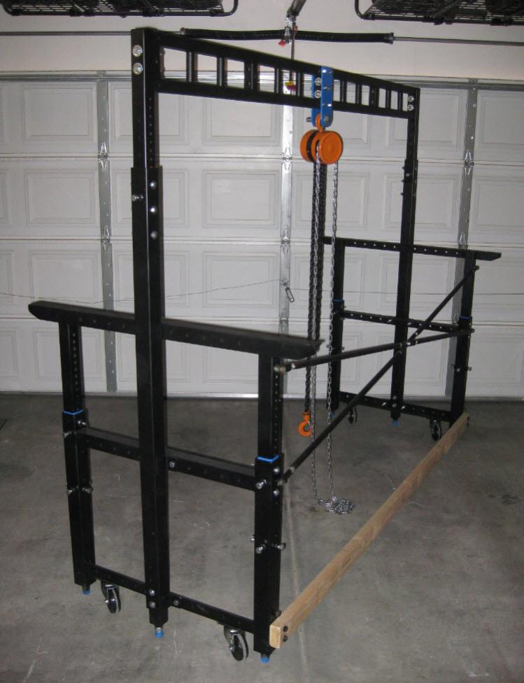

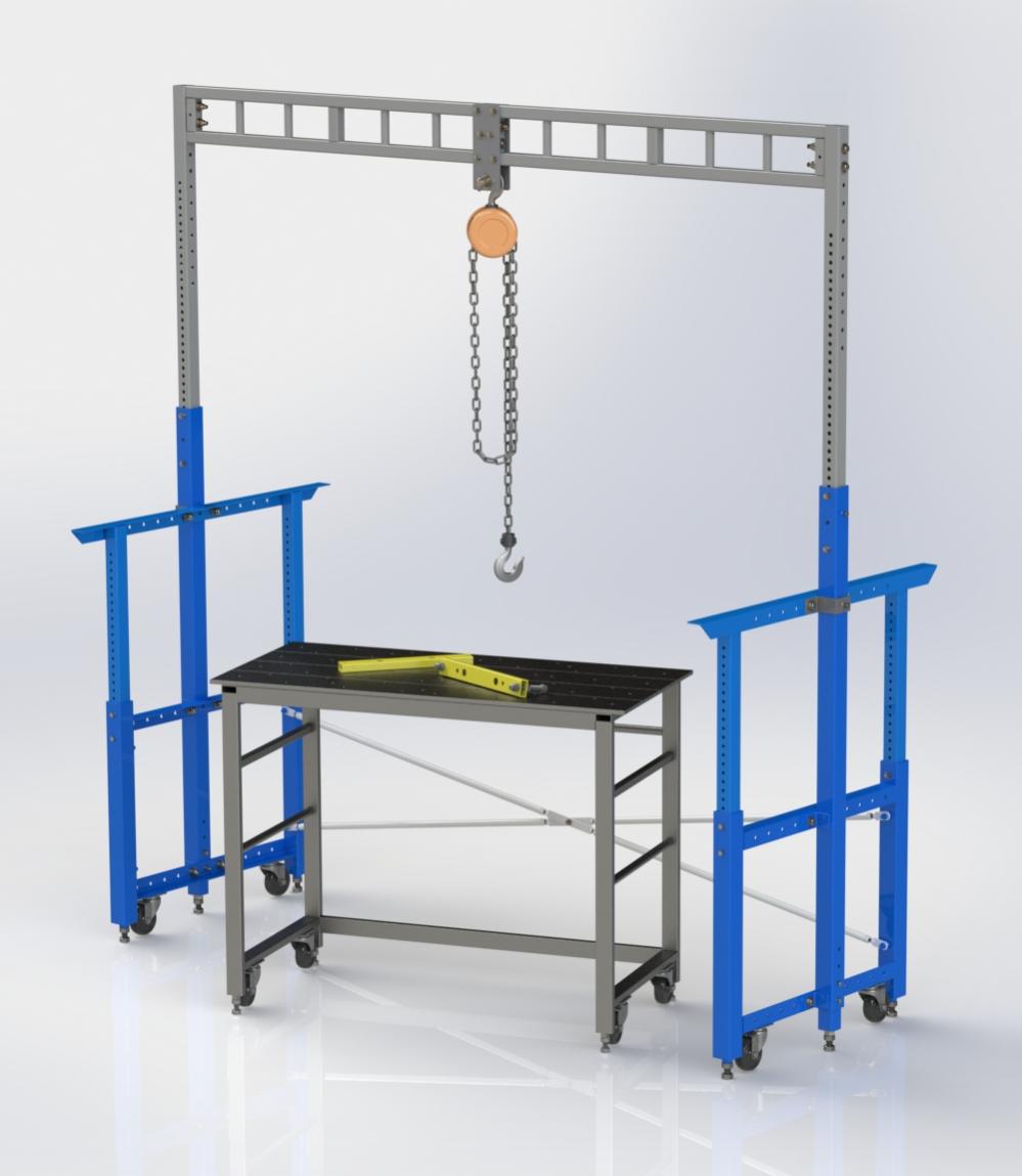

    As you can see from the photographs the tabletop can be lifted up and turned and lowered off of the Metal Gantry frame with the chain hoist and then the unit can be used as a Gantry Lift with the same 1-Ton Chain hoist. The overhead gantry can be lowered to clear the shop garage door height and also raised up to over 10ft.
    I used this Gantry Hoist Frame to lift both my Metal Lathe and Milling Machine onto their stands with the chain hoist.

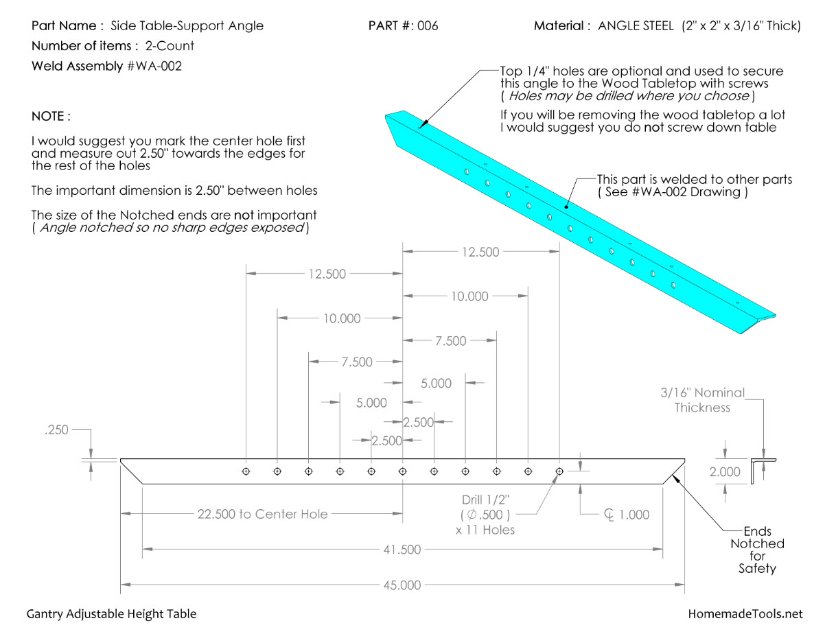

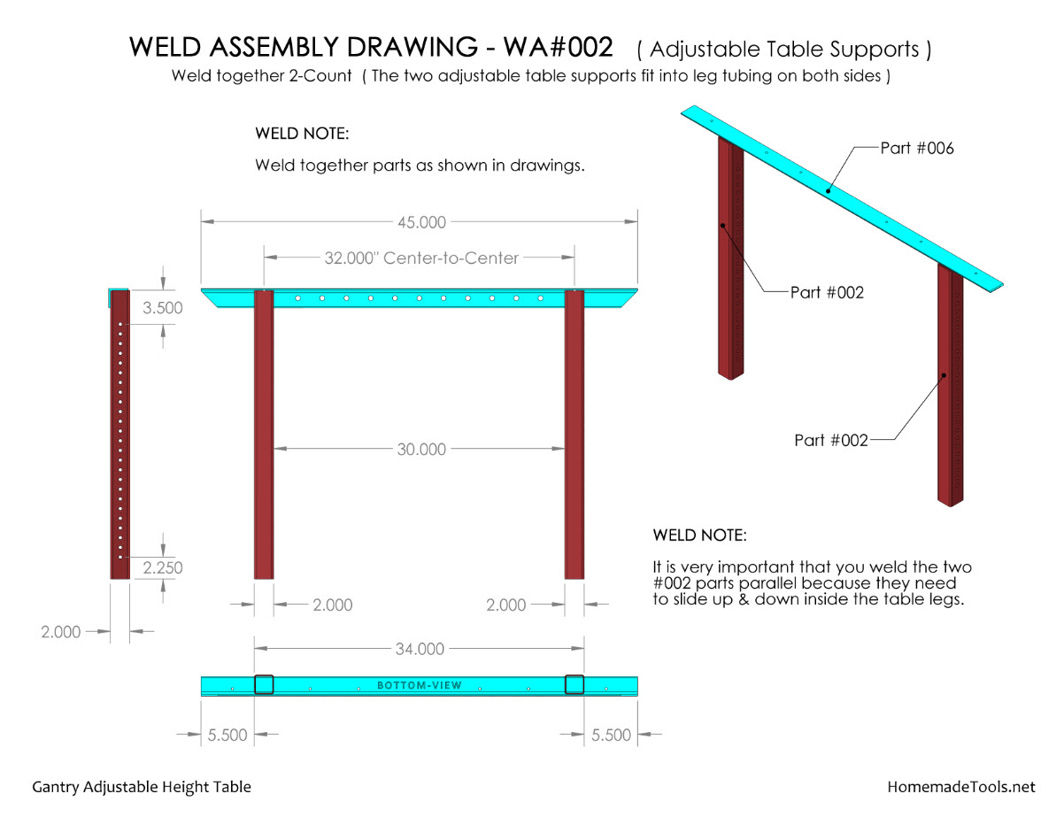

    If anyone wants the mechanical drawing plans for free in PDF format you can get a hold of me on Twitter at @MetalDesigner or via a comment on my blog at ‘Over Jeep’ Workshop Lift-Table | CTM Projects

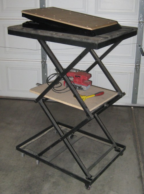

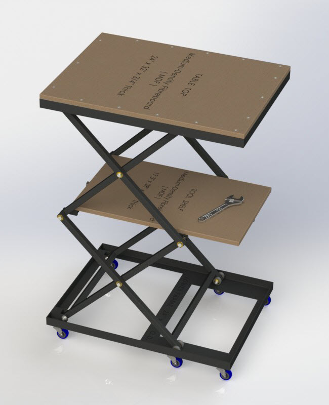

    On the Blog or Twitter (@MetalDesigner) you can also view and/or request mechanical drawings for free in PDF (Adobe Acrobat Reader) format for the smaller scissor lift workshop table that raises and lowers with the use of the Cordless Drill turning a Nut welded to ACME leadscrew thread on CTM Projects blog at: Small Workshop Lift-Table | CTM Projects

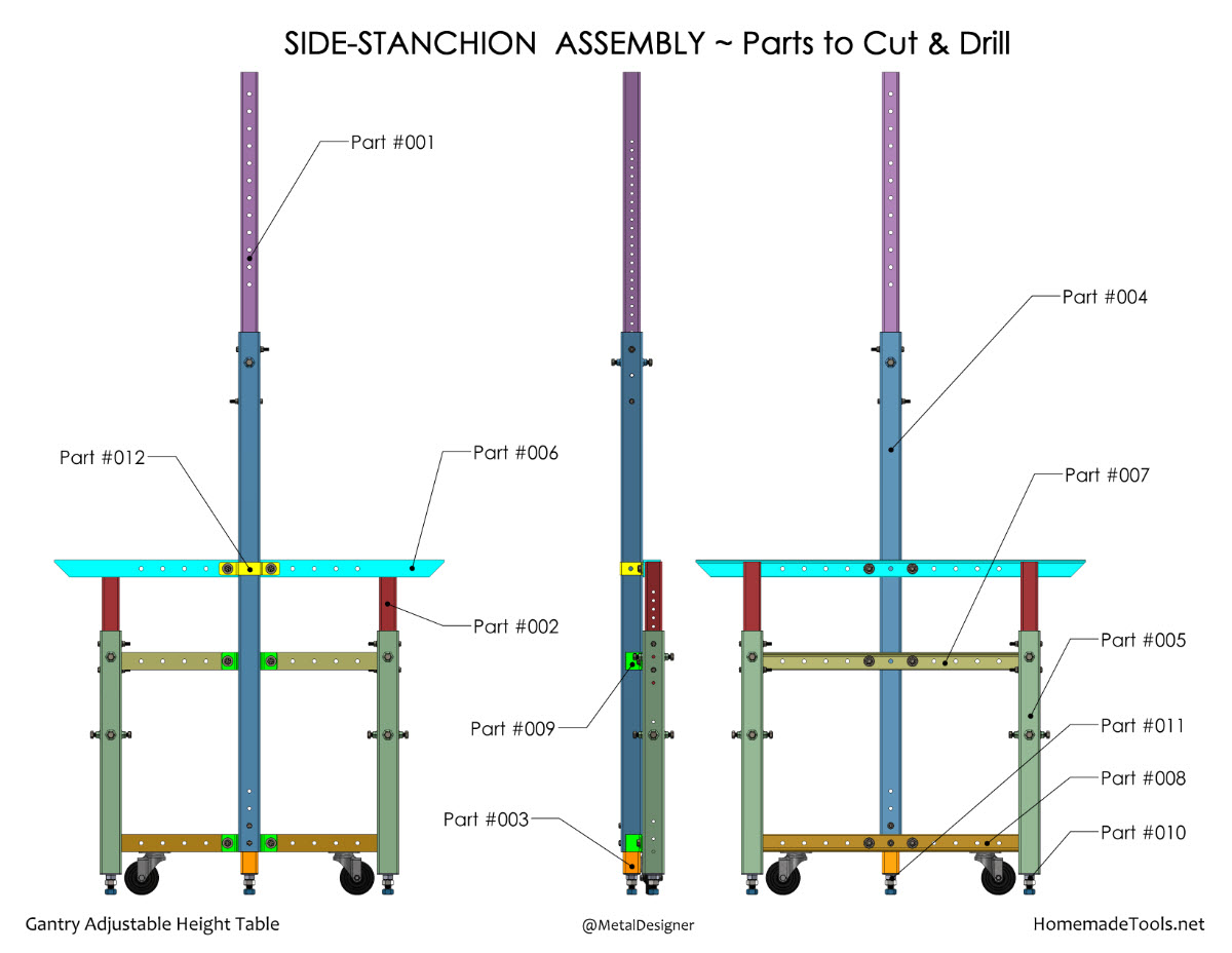

    I sent Ken all the Plans for the Gantry Table (Over the Jeep Table ) to HomemadeTool.net to give away as FREE examples of their Marketplace drawings ... Maybe if you contact them they will send you the plans and images or provide you with a link ... If not now, possibly soon.
    plans@homemadetools.net
    Very detailed dimensional drawings & high-res images ... Spent a lot of time on them so would like people like yourself to be able to view them.

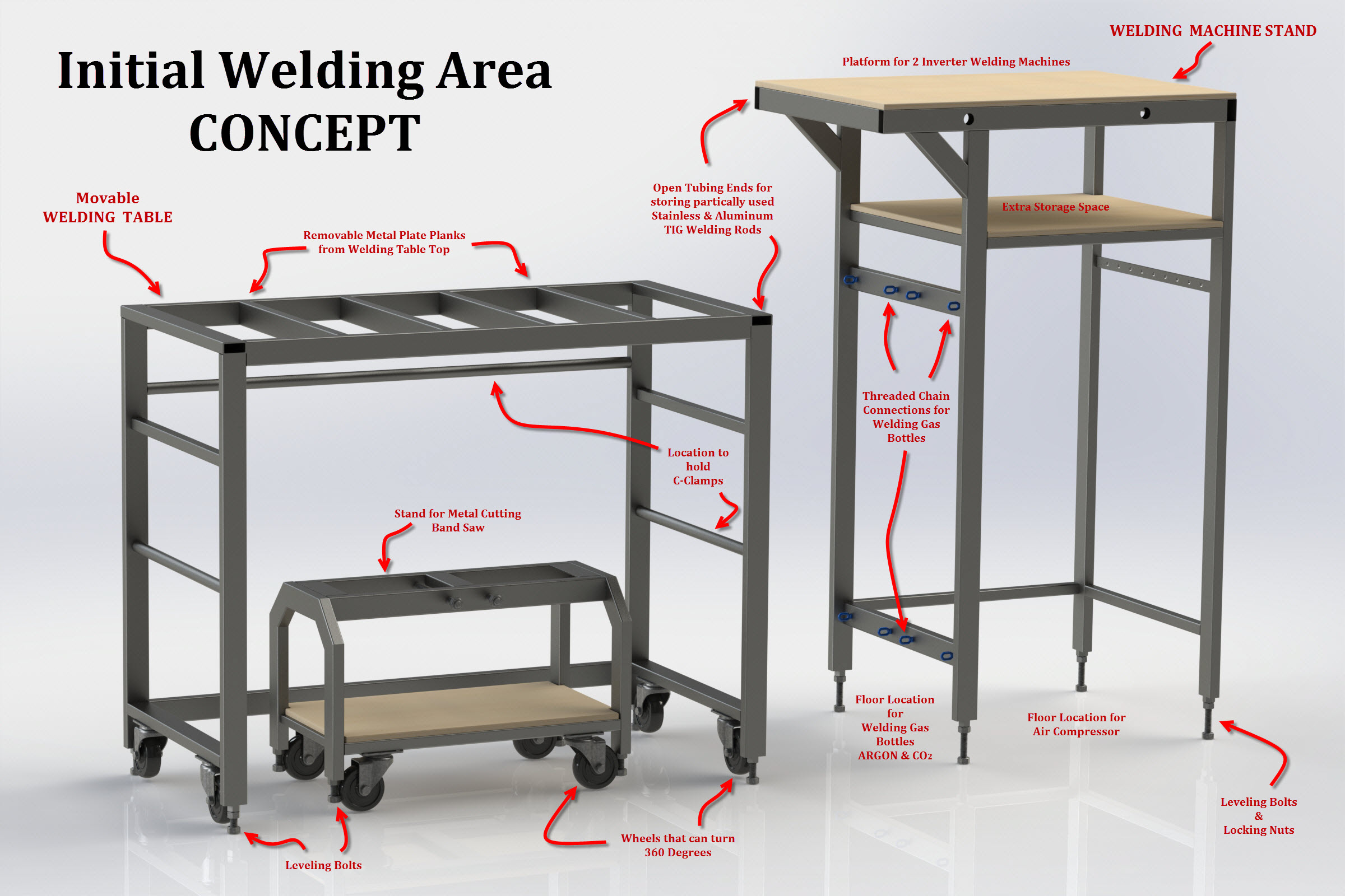

    The additional 4ft x 8ft tabletop area is a lot of extra space even if it is in the high position over the Jeep's hood.

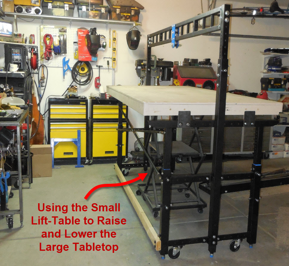

    When need to use it as just the Gantry Frame to lift items like the Lathe, the Gantry & Chain Hoist actually works to lift off the tabletop and it tilt it a bit and then turn it and set it on the floor.
    However, I have found it is just easier to use my little scissor jack table to lift the big tabletop up a little and roll it off.
    https://ctmprojectsblog.wordpress.co...op-lift-table/
