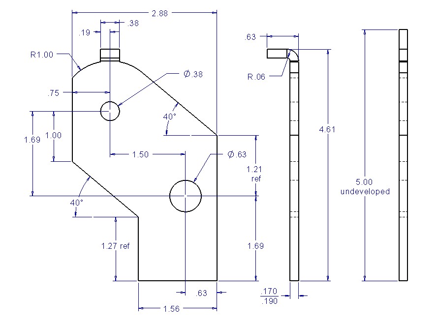

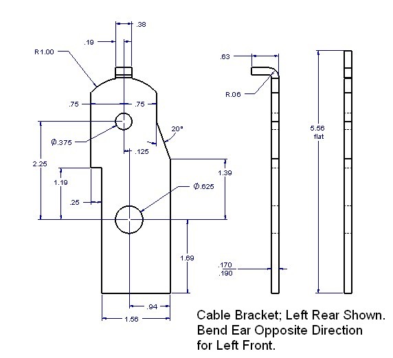

    here ya go, melbakid and any others that are interested;
    There are 2) of the Left Cable Bracket (1st dwg)
    Bend the ear as shown for the rear-most bracket.
    Bend the ear on the other one the opposite way for the front bracket. (There's only one of the Right Rear Bracket)
    The bend should not interfere with the pulley and if you make it 1 1/16" inside from the 3/8" hole, the tab can be bent over to contain the cable.
Name:	Cable Brkt, Left Rear.jpg
ID:	25388 Click image for larger version.
Name:	Cable Brkt, Rt Rear.jpg
    (If these don't show up large enough, PM me and I'll send them.)
