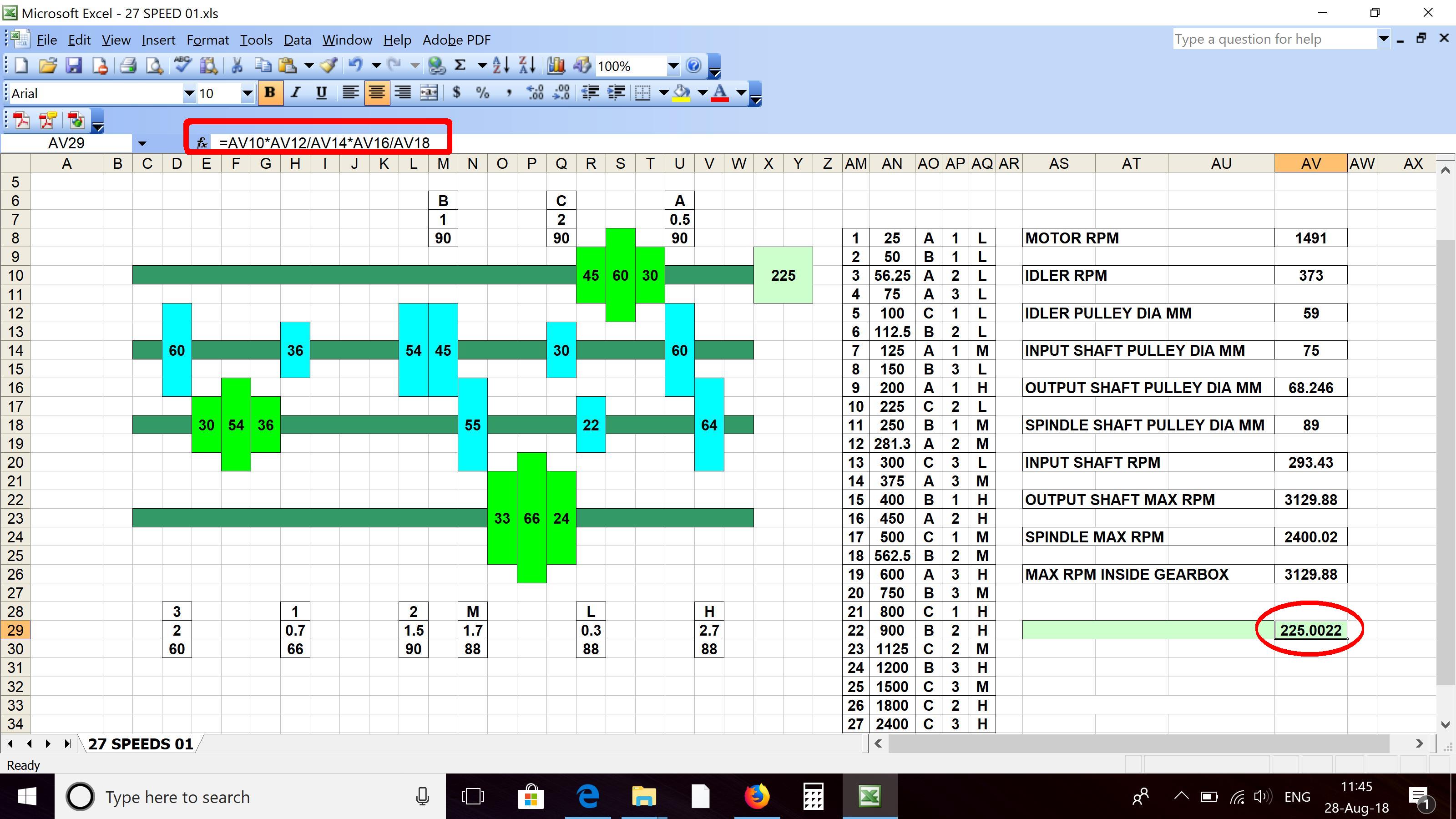

    It took me a while to remember that your input shaft RPM is not constant Since I read your lowest ratio between shaft A and shaft D as 9 to 1 the only way I could see a 25 RPM output would have been if the input were 225 meaning there had to some additional reduction somewhere.
    Is that correct?

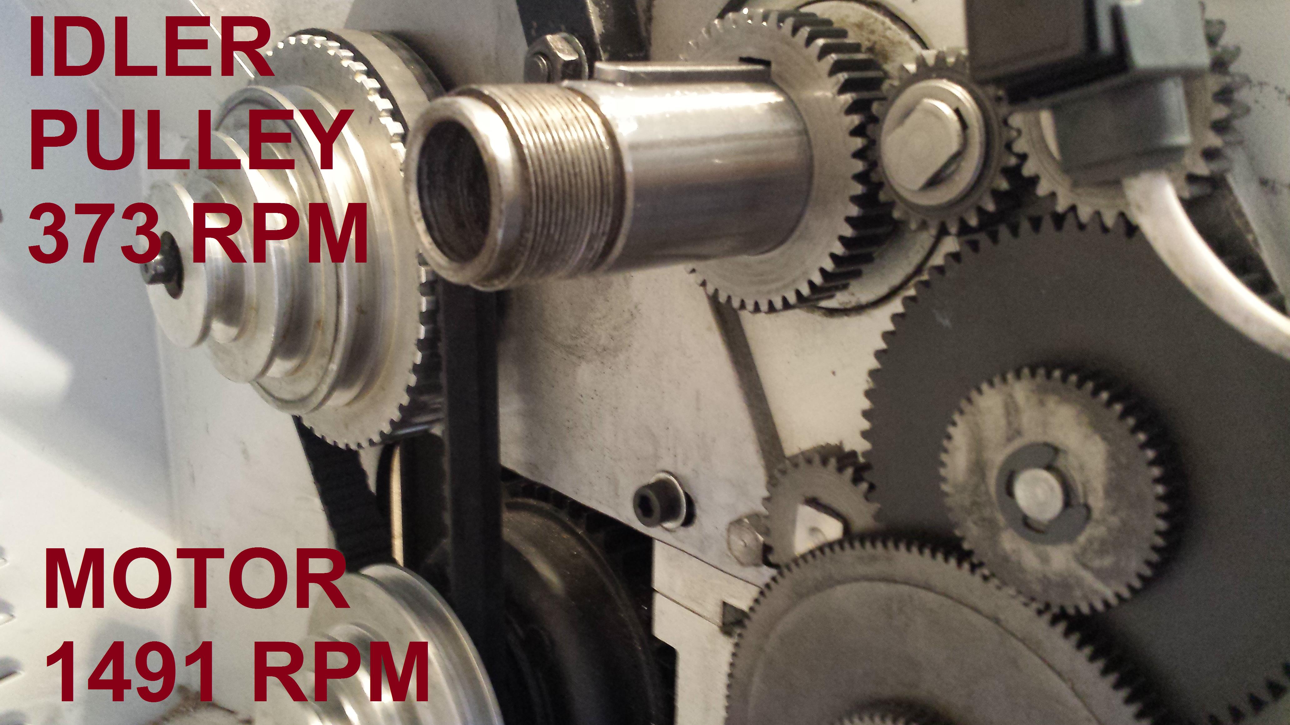

    Is that correct?
    Yes, That's correct. There is 4:1 reduction from motor to idler pulley and gearbox input speed is constant. 293.43 RPM.
    One picture from the first post 'lathe external headstock gearbox' and screenshot from excel file attached. It took me some time until I came to magic number 225.
