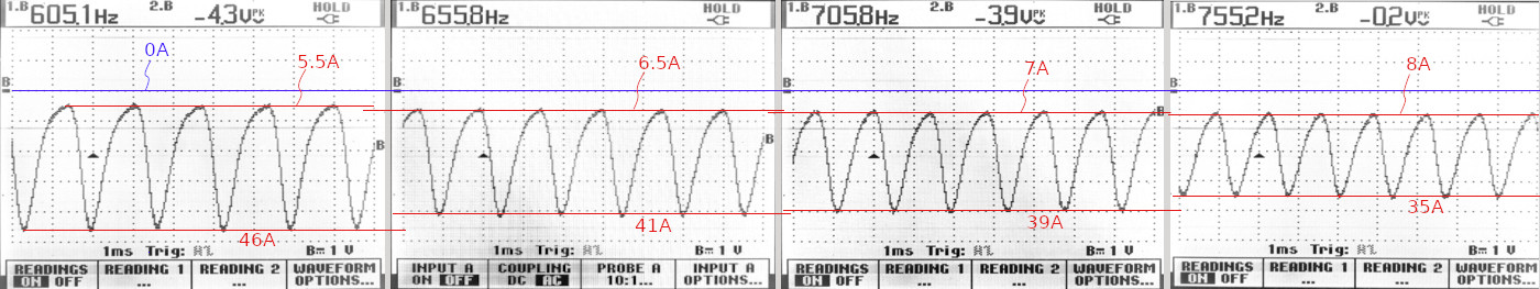

    This data-comparison helps us to determine what the current should be and what the frequency of the pulse, especially for welding thinner steel sheets with butt-welding.
    The setting welding current is 100A, base current 5A.
    Adding Digital Generators to an Old Analogue TIG Welder-dc_600-750hz_comp.jpg
    In my opinion, up to 900Hz from 500Hz, the higher the frequency of the pulse the easier the control of the arc.
    This comparison tells we can raise the welding current safely in higher frequency, since the actual peak welding current does not go up too big for thinner sheet.
    Chy

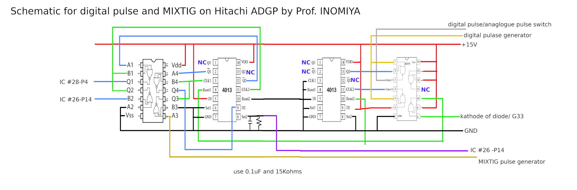

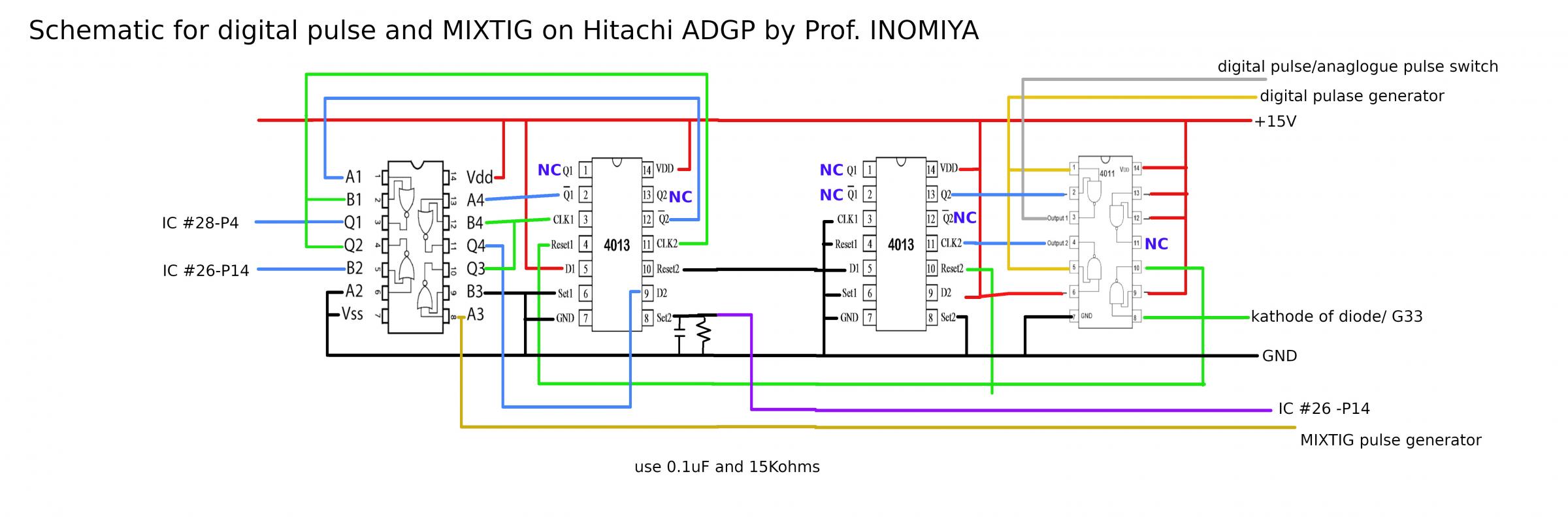

    Quote Originally Posted by chy_farm View Post
    This buddy gave me OK to open his schematics on this project, will compile a bit and post here soon.
    (Note he says the schematics are only for Hitachi's welder, version name 'ADGP' and some series after this. )
    Adding Digital Generators to an Old Analogue TIG Welder-schematic-digital-pulse-mixtig-hitachi-adgp-inomiya.jpg
    This schematic is just for Hitachi's TIG welder, ADGP series. Hope you can apply this for yours thanks.
    Chy

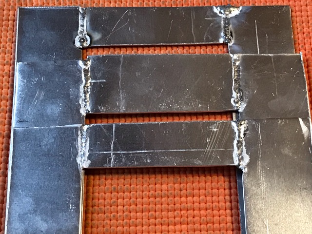

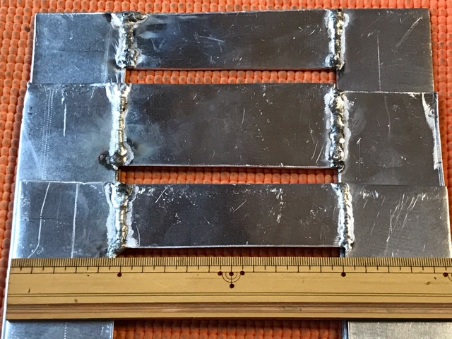

    Adding Digital Generators to an Old Analogue TIG Welder-f9650eaf-2e5f-473c-bc68-09da7e1b2820.jpeg
    Adding Digital Generators to an Old Analogue TIG Welder-f4dbc84a-3927-4c90-9e00-1f8ade59460e.jpeg
    Setting means a lot to this retrofit-unit, for this MIXTIG setting better use 70% to 80% alternative current wave, and 30% to 20% dirrect current especially for thinner aluminium like above case, 1.5mm thick.
    Several hits and errors made me get information of better setting.
    Hope you can do it better than these above!
    Chy
