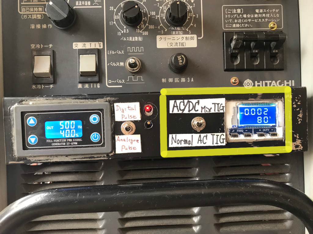

One more feature I love about this new generator is that this can replace arbitrary legth of AC welding current with DC welding current.
This method is named "MIX TIG" by a domestic manufacturer Panasonic.Co. to their TIG welders.
My old machine is of mid 90's so is actually an older type built by Hitachi Co., which did not have this tool.
Attachment 35981

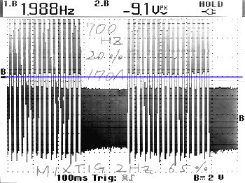

Above monitor in the right with yellow marking is for this "MIX TIG" method, showing it generates 2Hz frequency with 80% duty, for AC welding current, so this means 20% is for DC welding current.

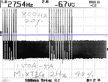

Showing a "MIX TIG" wave form of a couple of another setting, 2Hz frequency with 65% duty, 2Hz frequency with 40% duty, either for AC welding, as follows;

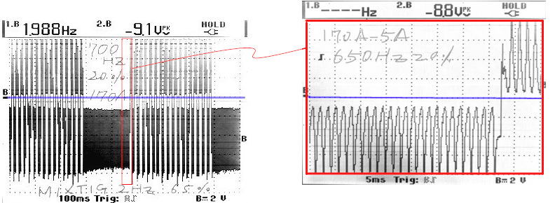

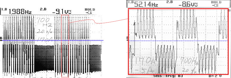

The former wave form I posted above can be illustrated in another way like one below;
Attachment 35986
Large red rectangle in the right is an enlarged view of the small red rectangle marked in the left. This part shows how the AC welding current with 700Hz pulse runs.

Again a large red rectangle in the right is an enlarged view of the small red rectangle marked in the left, but this is not of AC current.
Attachment 35987
Frequencies of the pulses of the two are a tad different, 700Hz for the left, 650Hz for the right. I did not monitored an enlarged view for 700Hz so instead used another but nearly the same view of 650Hz in the place of the true one.
This enlarged part shows how the DC welding current with 650Hz pulse runs.

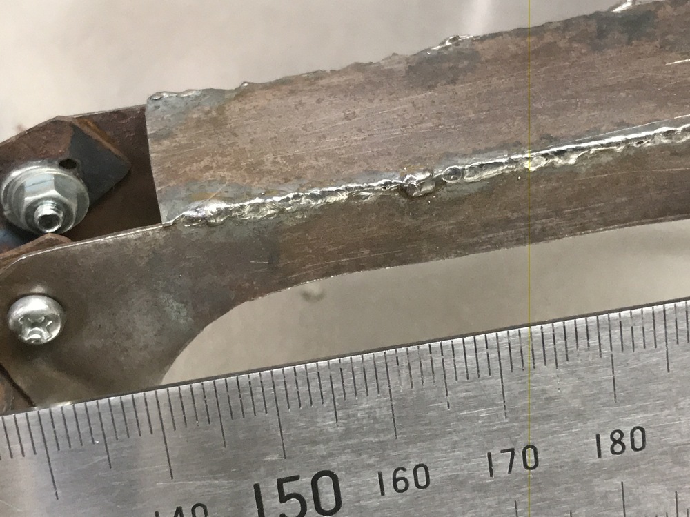

A result of this retrofit, tried angle-butt-welding with 0.5mm steel sheets by using 800Hz pulse, with setting of welding current 100A, base current 5A.
Attachment 36060
I think I did it better than ever as a green hand.
Good feature to me is that the arc does not wonder, may be because both the welding current and pulse frequency are high.
